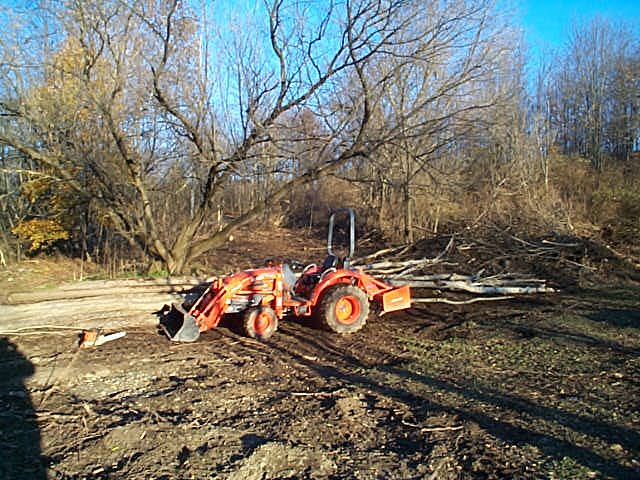

I paid $15,400, after the $400 rebate from Kioti, in Oct for my CK 30, manual shift, FEL, filled R-4's, and block heater. When I first looked at Kioti's a couple of months ago I looked at a CK 25, manual with FEL and R-4's. I think the dealer said the price was $14,800 or so. You might be able to do a little better where you are, prices seem to be a little high here, but at least I was able to get out of paying the 6% sales tax since the majority of my use will be for my maple sugaring operation and possibly expanded my raspberry batch in a couple of years when I get some more land cleaned up better. Since I have a wood fired evaporator I have used the tractor to skid out logs that I've cut to thin out the sugarbush. It works real well for this, don't even notice them on the back. I've attached a photo of what I've brought down.
