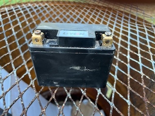

an sla charger will most certainly get a lithium battery over 90% charged. that said, there is almost 0 chance its lithium based. and at .2v its a dead battery anyway. its a maintenance free lead acid or agm battery if i had to guess. would love a photo.

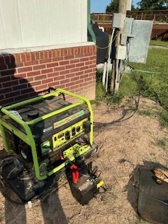

Here's some pictures of her installation. Note, this is not what I'm comfortable with, but her husband passed away a few months ago and several of the neighbors and myself are working on getting her place setup so she can manage it on her own. One piece at a time.
Here's the control panel. It has a DC output, but not sure whether that powers the battery or whether the battery has to be plugged into it via a special cable.
Here's how it connects to the main breaker panel. Yes, that's a suicide cord, and there is no generator lockout. I've pulled out the "starting battery" and have my battery connected in its place. There is a NOCO battery charger in the box on the pole with the DC connection running to the battery. It really needs to be up off the ground about 8" - 12" because it's covered in dirt/sand that high up.

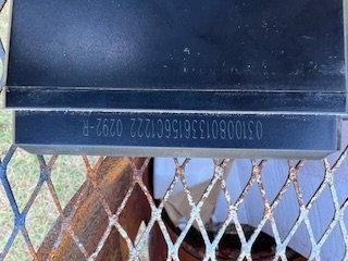

Here's the only label on the battery. I assumed it is the company logo. I've brushed off most of the sand/dirt prior to the picture.
And the only other "writing" on the battery that I could see.
And the battery is very light, as if there is nothing in it. I'm really tempted to cut it open to see what is in it, but messing with lithium is not my idea of fun or even something I want to do, but I'd really like to know if there is anything inside of it.

Back feeding with suicide cords generates some lively discussions. I will only say that I would not be involved with someone else running this setup, regardless of their knowledge or experience. Consider setting her up with proper wiring and a lockout.
   / Lithium battery with an SLA charger #10
If you look at the LivEN website, the chargers they show are pretty heavy duty. Not some walmart charger. I also wont work on any suicide cord job, especially with an elderly client. I had one customer who related how his dad, an ex electrician, forgot to switch off the main on a back fed gen system, and when power was restored grenaded the generator. And this was a so called trained individual who thought he knew how to do it safely. I mean seriously, a cheap interlock is like $69.00
