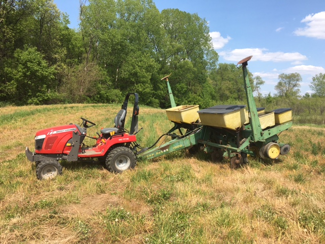

I inquired on this site if my Massey Ferguson GC1715 25HP tractor could pull a JD7000 4 row corn planter. Well, I went ahead and bought the planter, and gave it a shot. I hooked up the hydraulic ram on the planter to the hydraulic lines on the tractor that run the FEL, which required a 5' hose extension, and the proper connectors. I was very impressed with the little tractor, as it was able to pull the planter (while planting) with ease.
If you've ever looked at 2 row corn planters, you know that they are not cheap, especially these JD7000 units. You can pick up a 4 row planter for much less money than the 2 row units, and get the job done twice as fast.
I would think the John Deere and Kubota tractors of the same or similar HP could also pull a 4 row planter.

Well done. The little tractors can do a lot more work than some people want to believe.

Will admit this surprises me, I have a set of those planters used to plant corn late March this year. He would have failed in my fields as wet as they were. Remember we had records flooding statewide last October with a good bit of rain over the winter. Soil type and condition can make a good bit of difference also how heavy planters are loaded.

Shouldn't the planter be setting level? So the seeds aren't to deep and the rear wheels cover the seeds and pack the dirt.

I have set of these planters that are new to me but used to plant corn this year with good results in doing so but have spent hours reading their manual. They give you specs on how level it must be when lowered for planting. Also give you mph range to plant in or get spacing think further apart if slower and closer together if too fast. We ran with more hp with ours on the high side and did end up with closer spacing than the test run to measure the seeds. To me most seeds will do well planted less or deeper than is recommended to a good degree. While it worked with the soil conditions and such he had this year over time he will hit conditions that are not so perfect and maybe not as much more hp but heavier tractor is needed and also there is the issue over stress to the system to the smaller tractor to pull the load with the smaller drive train. What we can do for short time is one thing compared to hours of use with same setup. The ability to match the row markers with the tractor may or may not be an issue for the next round. He would had to run them out further than for a tractor of recommended width. However what is most important is the ability to use the tools you have to do a job that meets your needs.

Wouldn't you just run the marker down the middle of the hood (hence the drawbar) regardless of what the hood is covering?
I'm also surprised that it worked. I would have expected it to spin out and stop. Was 4wd used? How much seed and fertilizer in the hoppers?

Yes RaydaKub, 4WD was used. I split one 50lb bag of corn in the 4 hoppers, and had 200lbs of fertilizer in.
I think my 50" tiller is harder on the tractor than this planter.

Unless his markers are different than on mine no, they line up with wheel.

What kind of ground conditions? No till or post till? What kind of depth did u sow?

I have bean cups and corn meters for this planter. I aim for 1" depth on the beans, 2-3 inches on the corn. Tomorrow will be 1 week since I planted, and we're getting a good rain right now with mid 80 temps. Corn and beans should be up on the weekend. I'll post some pics, if anything sprouts, that is!
Post till, as I have a 50 inch tiller. I thought about no till, but I don't have the no till coulters on the planter.
