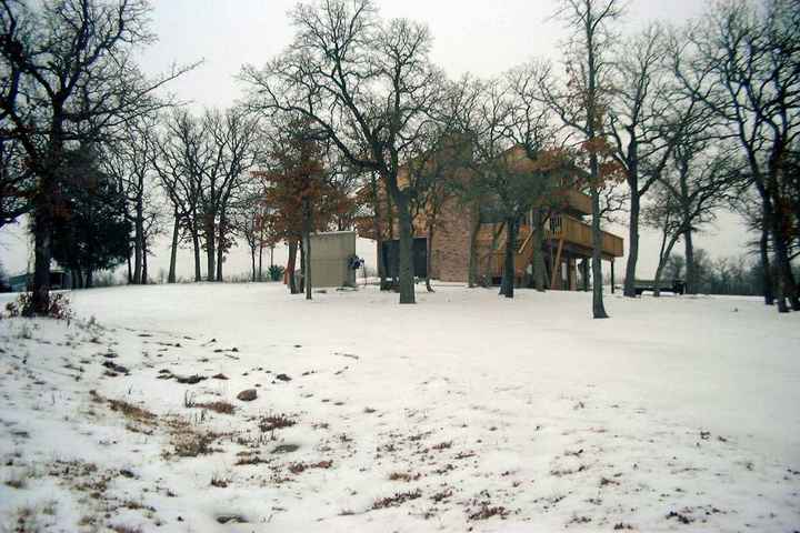

Just me most of the time...and my girlfriend from time-to-time. /forums/images/graemlins/grin.gif I spent about 8 mos. of weekends building it and lived in it daily while my house was being built so I could be onsite to inspect the work. As long as I had my computer, I felt right at home. /forums/images/graemlins/cool.gif When I was going to be away for awhile, I shut off the water underground and blew air into the lines to clear out the water if it was winter and I was leaving the heat turned down. Otherwise, I routed the CPVC water lines above the ceiling but below the roof insulation. That way there was no danger of freezing. Here in Texas, outside lines can be wrapped in heater tapes and that's all you need to do. It rarely gets below the upper teens in winter. I'm sure Terry would/will have to take much more drastic measures to keep his water flowing. /forums/images/graemlins/smile.gif Here's a picture of the only Ice we had last winter. I'm ashamed to even show it to these guys from up north. /forums/images/graemlins/blush.gif
