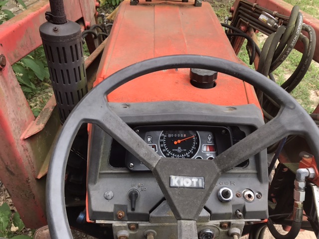

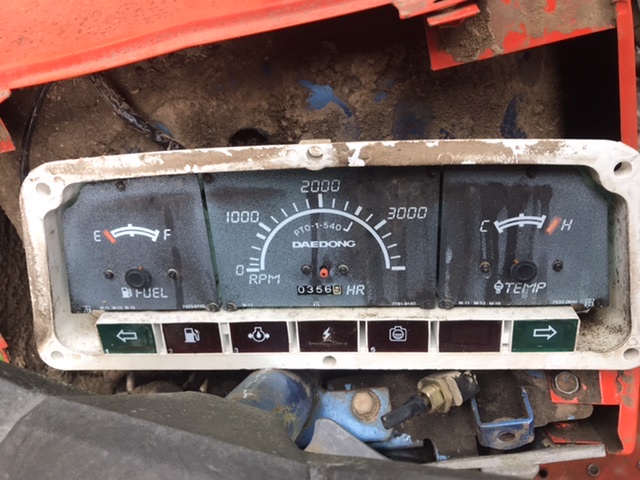

A couple of months ago my tachometer started vibrating very aggressively and before I could shut the tractor down, every needle on the gauges broke off. Well, I figured I would order a new panel as I needed some other parts anyway.
Turns out the instrument panel is no longer available. Now I am thinking about finding one that is close and modify it to fit. Any suggestions or ideas would be appreciated.

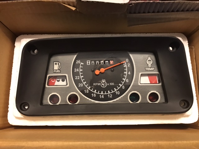

Well been very busy and getting new Branson set up has delayed this project for too long! I am starting to focus on a solution and need a little advice.

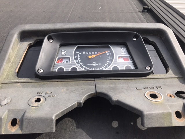

I have purchased a universal instrument cluster that I plan on making work. I need to build a adapter mount to make it fit the dash. I have a plan for that.
What I haven't figured out is where to source a tachometer cable. The tack on the new cluster appears to be 5/8-18 square end. Tractor side appears to be 10mm slot.
Any ideas on where I might find such a animal?
Here is a picture of the broke gauges.
And here is a picture of hopefully the solution.

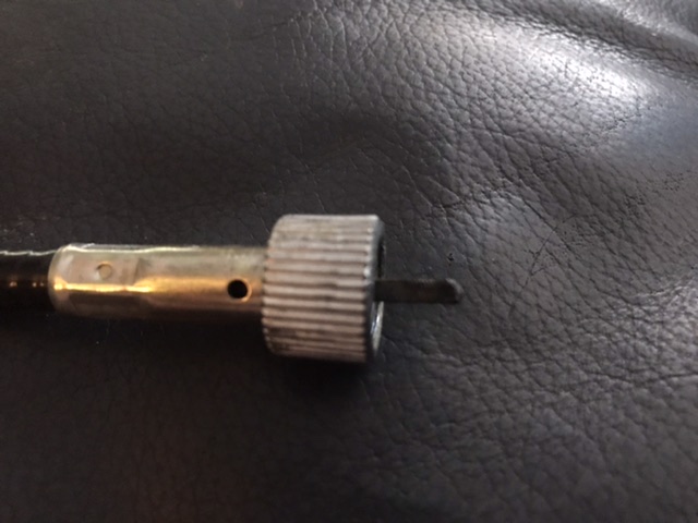

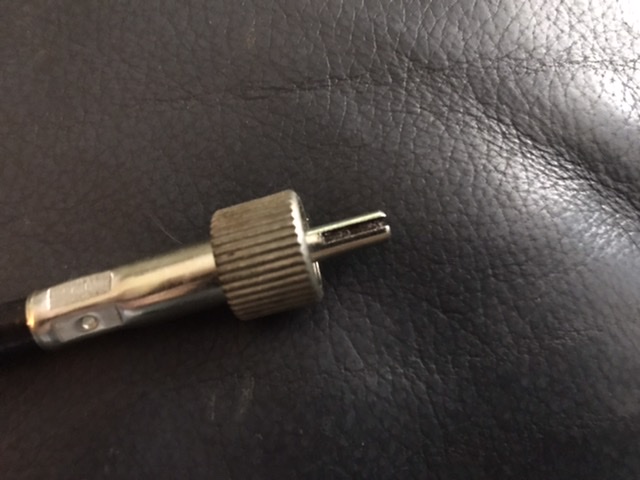

Thanks for the reply. I am actually working on the Kioti LK2554. The tractor end is slotted. The tachometer end is square. The new tach takes square as well but is a little bigger hole. Nothing a match book cover won't fix.
My issue is with the nut on the tach side. It needs to be 5/8-18 thread.
Here is some pictures of the Kioti cable. Picture on top is tractor end and the picture on bottom is tach end.

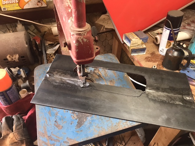

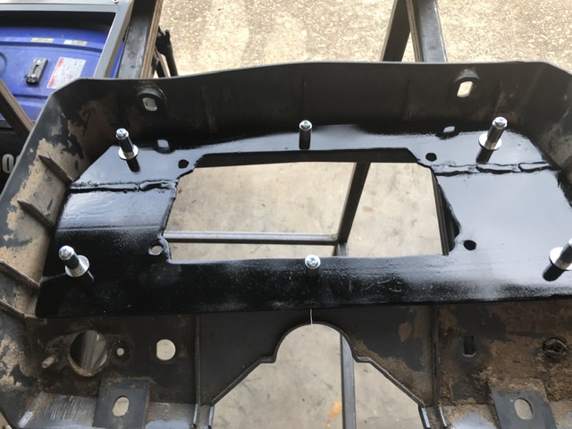

Finally finished the instrument panel install. The only thing left is installing the tach cable. The cable is built and I should receive it early next week.
I ordered the new universal cluster from Complete Tractor. Good folks and shipping was fast.
I had to fabricate a mount to install the unit. I used 1/8 flat bar that was 4" wide. I had to weld two pieces together to be wide enough. I had the flat bar that is why I did it this way. I made a template out of cardboard then transferred it to the steel.
Then I used my old table scroll saw to cut out the center. Used my band saw to cut the outside.
I made my welds on the back so from the front all you see is the seam. Cleaned the part sanded and painted.
I used 1/4" spacers and longer screws to hold the mount to the cover.
I put weather stripping around the new cluster before install to make a seal.
Then I wired and installed it to the Kioti. In order for the warning lights to work you must take the small circuit board out of the old gauges. It is located behind the covers for the gauges. I labeled all the wires before removing them from the old cluster and determined which wires I needed. Then installed it on the tractor.
All lights and gauges work and I will update once the tach is working. This is a good solution to replacing the instrument panel on the 2554 and 3054 tractors. I think it looks fine enough for me as I am more concerned with functionality than looks.

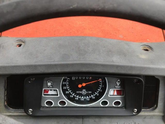

Here are a few more pictures of it installed.
   / Lk2554 Instrument Cluster
Tach cable arrived and is installed. Worked no issues. It might be off a few hundred RPM but not a deal breaker.
I hope this helps someone someday. It is not too bad of a fix. There might be a better solution out there but this is what I came up with.
Here is idle and at PTO speed.

That's a nice fab onto a working tractor, congrats. It's a booger when parts aren't available anymore, but you fixed it with ingenuity :)
   / Lk2554 Instrument Cluster #9
looks good to me,
that "universal" looks a lot like a Ford panel.
   / Lk2554 Instrument Cluster #10
My first impression was that you installed it upside down until I noticed the fuel and temp writing was OK. Odd that the tach is backwards.
   / Lk2554 Instrument Cluster #11
Nice work K5! Very clean install considering that these are usual quite tricky to fit just right.
#12
Rex, thanks for the kind words. Sometimes you have too just get it done.
Lou, you are correct. The company that makes these also makes one for the old Fords. The only difference is they put a clockwise tach instead of the counterclockwise one like the Fords then called it "universal". Partly why I chose this one. I could not find any that would give me measurements but remembered the Fords having a smaller panel. It was a gamble if I could make it fit. It is tight but just enough room too make it work.
Oaktree, the direction is the same as on the LK 2554 but just starts at the top right instead of lower left. Rotation direction is the most important thing that has to match. There are work arounds for the rest.
Ptsg, thanks and yes Sir, it can only go in one spot and still be able to attach the tach cable. This is why I slotted a few of the mounting holes to allow for fine adjustments. I am not that good of a fabricator so I have to make some provisions. :thumbsup:

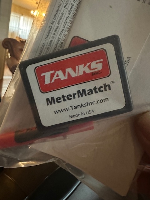

Hello,
How did you wire the new gauge up if you don’t mind me asking? I had to order the same one
#16
The cable for the tachometer will need to be custom made. The wiring was straight forward. I just used the same wires that were on the old cluster. The fuel gauge is the only thing that is not right as of now but I have the fix that needs to be installed.
   / Lk2554 Instrument Cluster #17
Can you tell me how you wired the old unit in comparison to the new unit? I have all the wires marked. Thanks.
#18
I would have to take it back apart to remember everything but it is not difficult. If I get a break in weather and some time during the holidays I will install the fuel gauge match unit and can get some pictures of the wiring for you.
