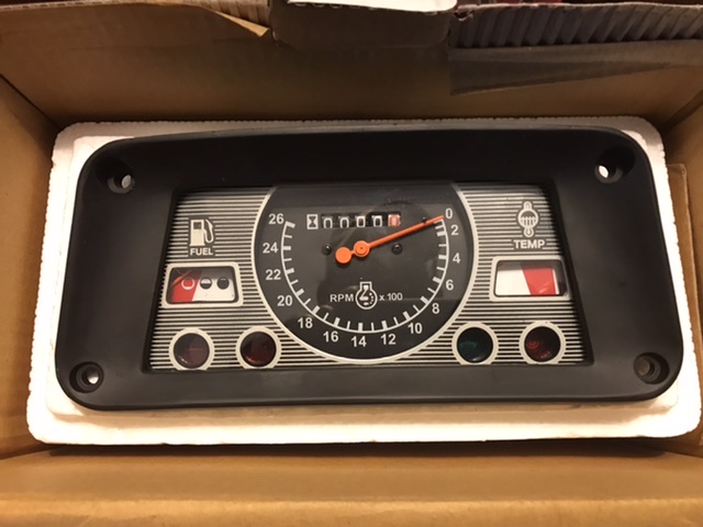

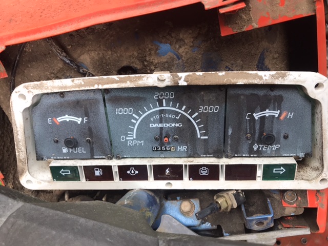

Well been very busy and getting new Branson set up has delayed this project for too long! I am starting to focus on a solution and need a little advice.
I have purchased a universal instrument cluster that I plan on making work. I need to build a adapter mount to make it fit the dash. I have a plan for that.
What I haven't figured out is where to source a tachometer cable. The tack on the new cluster appears to be 5/8-18 square end. Tractor side appears to be 10mm slot.
Any ideas on where I might find such a animal?
Here is a picture of the broke gauges.
And here is a picture of hopefully the solution.

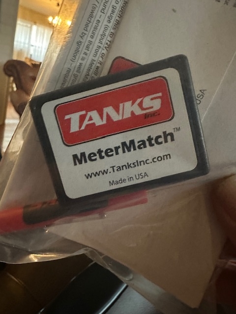

The cable for the tachometer will need to be custom made. The wiring was straight forward. I just used the same wires that were on the old cluster. The fuel gauge is the only thing that is not right as of now but I have the fix that needs to be installed.

I would have to take it back apart to remember everything but it is not difficult. If I get a break in weather and some time during the holidays I will install the fuel gauge match unit and can get some pictures of the wiring for you.

I just used the wires for the fuel gauge and temp gauge. I used the bulb sockets for low water level in the reservoir in one of the holes and oil pressure in the other one. They were a little smaller so I wrapped them in electrical tape to make them fit tighter in the hole. Nothing fancy but it works.
