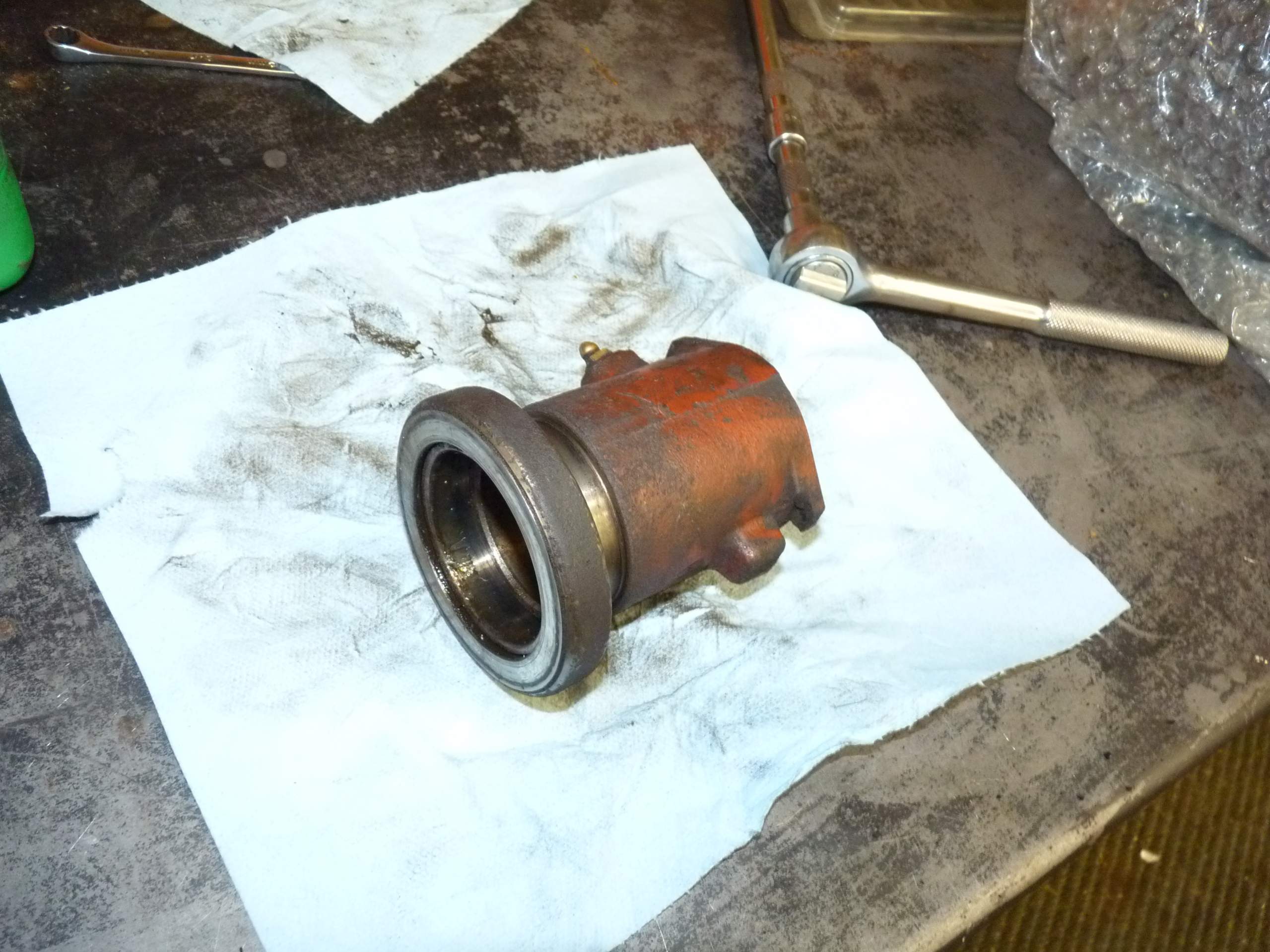

Here is the grease point for the throw-out bearing, Actually, the bearing is sealed, the zerk will grease the input shaft that the slide bushing -- which holds the throw-out bearing -- slides on. The whole bushing with thow-out still attached is shown on my bench. You will see it when you remove the inspection plate and look to the rear. It will be an awkward reach.
The release bearing shaft lubrication point is shown by pencil point. That is the actual shaft end exposed, keep it lubed with a thin lube like chain lube that will protect from moisture. Especially if stored outdoors.

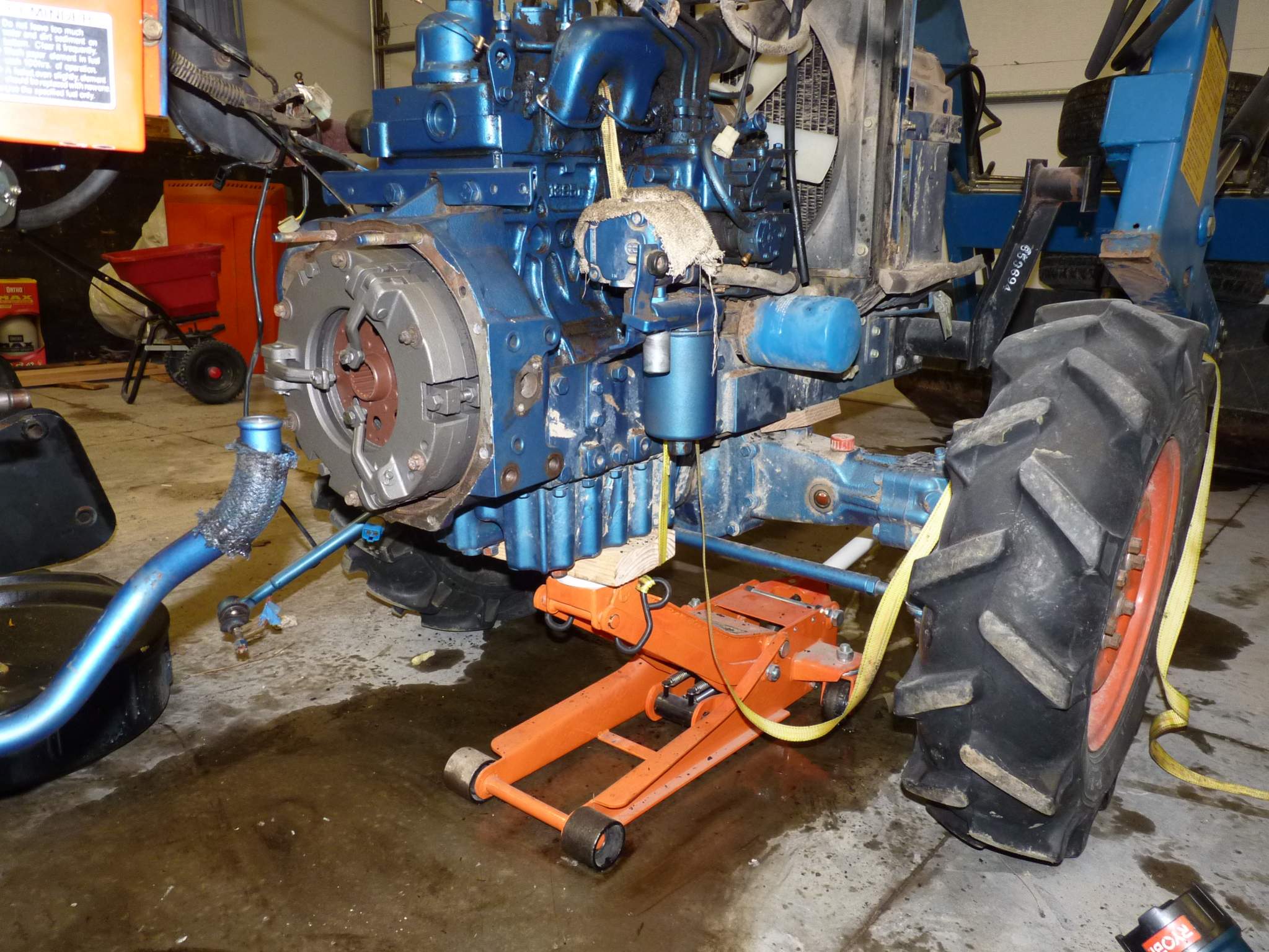

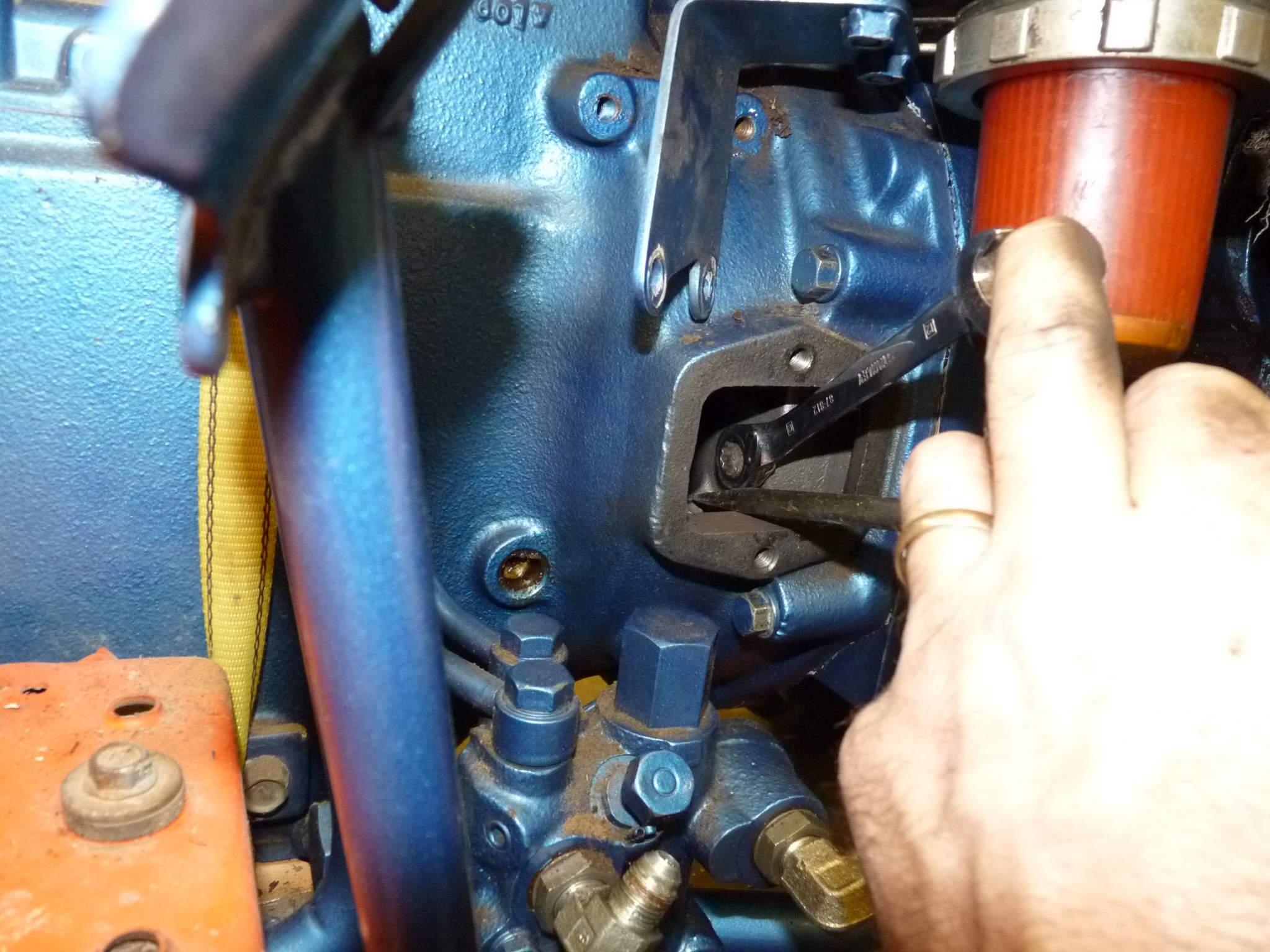

Reassembly was a bear. The only way it went back together was to lossen the clutch mounting bolts and retighten them after joinging the 2 halves. The picture shows doing so through the inpection plate.
Another pictute shows the front half. Look closely at the peice of scrap 3/4 oak wedged in between the top of the axle housing and the bottom of the engine. Do both sides before splitting.
