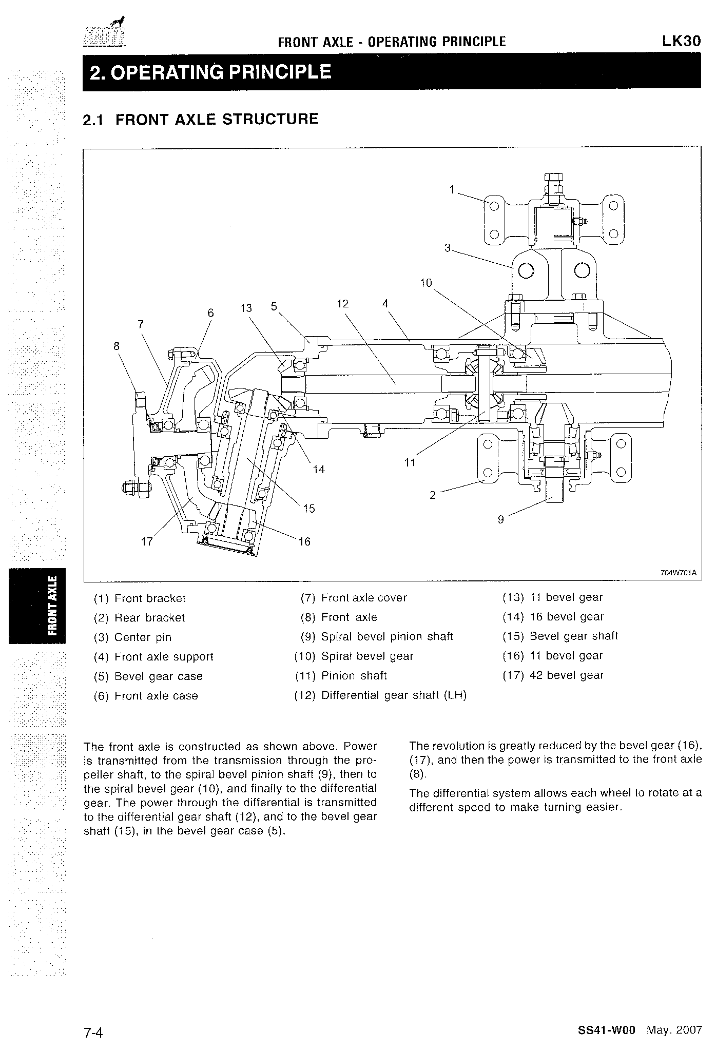

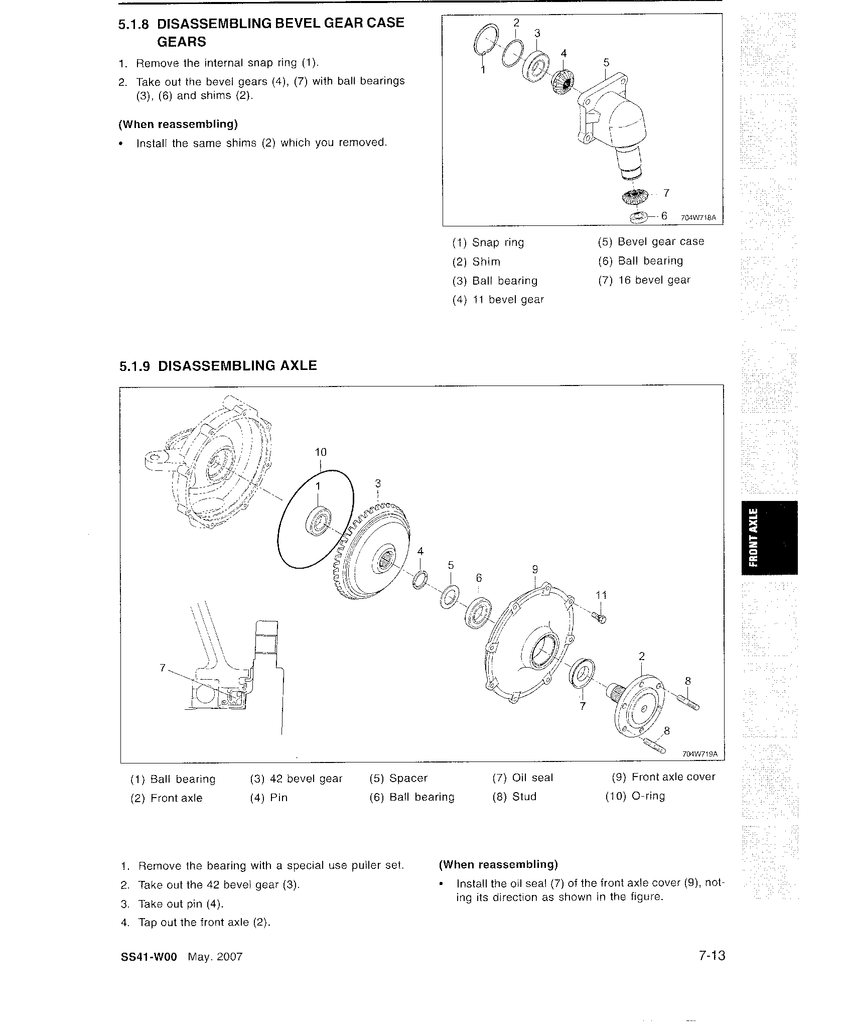

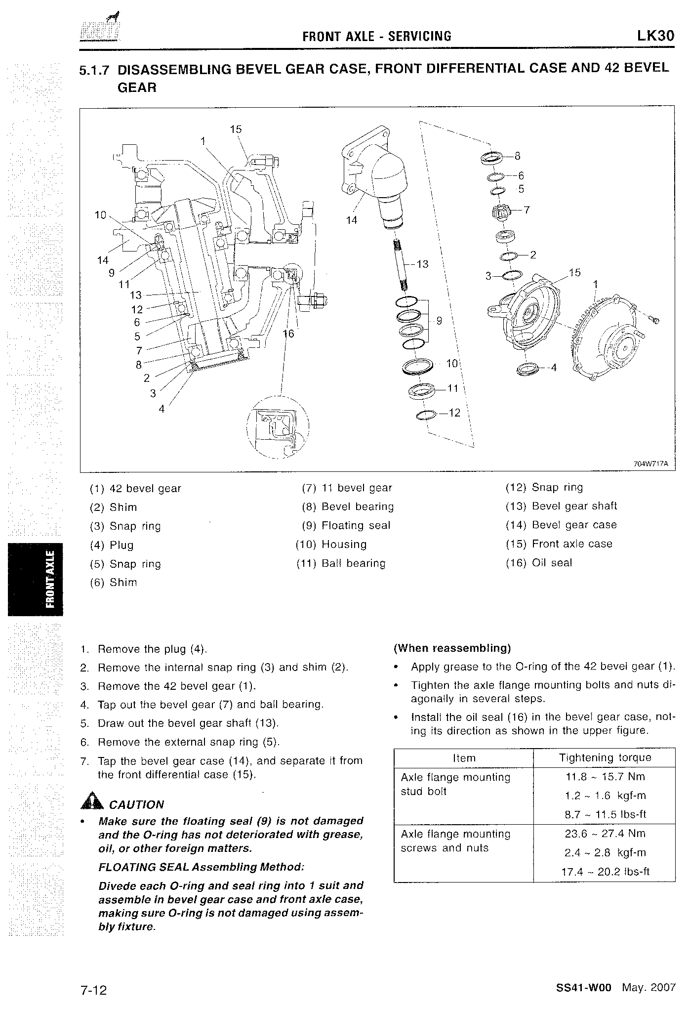

Sorry for the delay guys. My wife had congestive heart failure. Ambulances, ER, trips to doctors, etc. She is doing OK now. I am attaching pictures from my service manual. Again, I just do not have traction under a load on the left side. The left side slips and re-engages. Front axle3.gifFront axle2.gifFront axle1.gif

I think your going to have to pull that side apart and see what is going on it should be fairly obvious just look for the most ground metal.

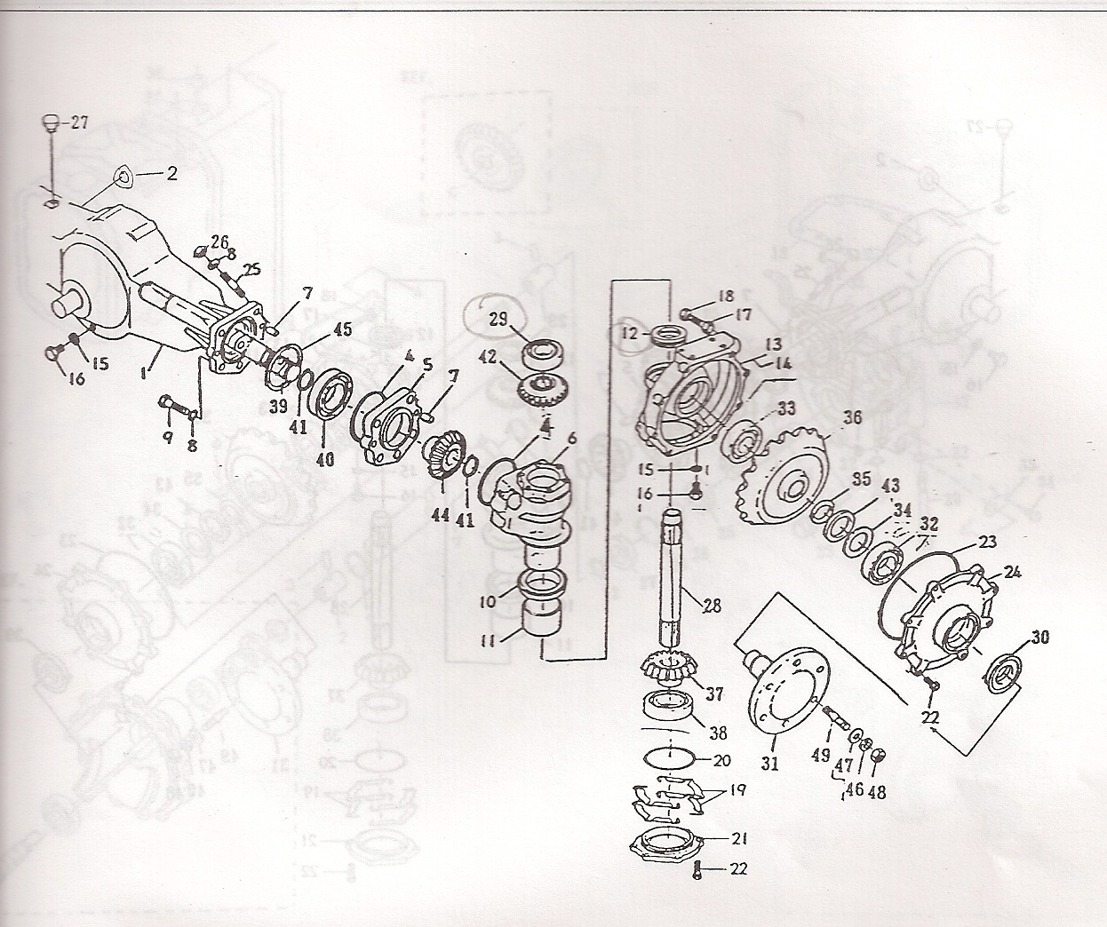

Happy New Year folks. Thanks to a day of 60 degrees weather (it is currently back to 12 degrees this morning) I was able to take apart the front end. As I drained the 90 weight, I noticed metal and a few roller bearings came out. Pulling everything apart, I discovered the roller bearing (see attached diagram #29) broke apart and trickled down the bevel gear shaft #28 gouging it terribly. Pieces ran down to the lower thrust bearing #12 and destroyed that one too. I was able to order both bearings off Ebay last night for about $25 and both should arrive by Jan 24. I'm hoping the shaft might be OK to reuse as the gouged section is between the splines as it doesn't appear to do more than connect the splineKioti front end.jpgs.

Update: I decided to replace the shaft (#28) and the upper (#29) and lower (#38) bearings. I feared the shaft would cost a fortune (like last year's $800 sector steering shaft) and almost decided not to replace it. I looked it up online and was delighted to find it only cost $54. Bearings are reasonable too. Bob over at Michigan Tractor had them all in stock and was very patient with me through the ordering process. Lull in the action now until UPS delivers. God is kind supplying a lack of snow and some unseasonable warm temps.
