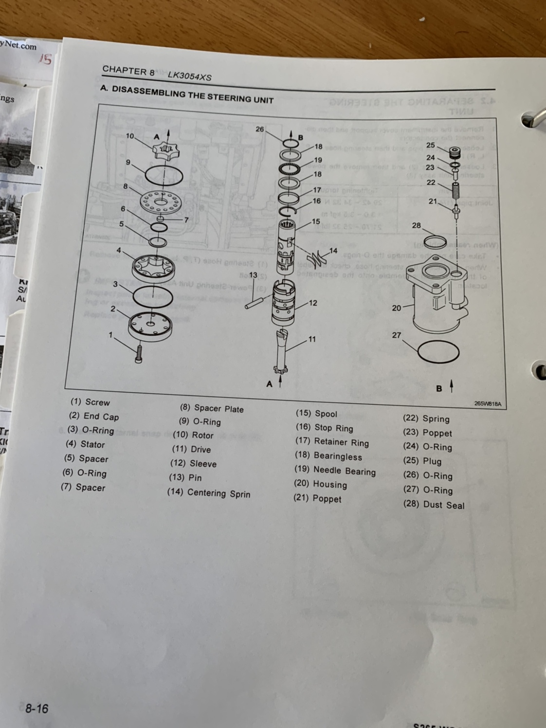

Crazed Camaro; Information on the valve is minimal in my manual: A single picture of the disassembled valve shows 4 springs { two long springs and two much shorter springs with associated hardware, a cylindrical object they refer to as a spool, and a disassembled relief valve}. There is no information showing or referring to a difference in the springs or their respective positions in the valve. The only instructions for reassembly state; "Apply grease to o-rings in the valve. When installing the spool, align the marks. After reassembling be sure to adjust the setting pressure. If either the valve housing or spool are damaged, replace the valve housing and spool as a unit". They list the setting pressure as 1636 to 1707 psi with the engine speed at 2600 and oil temperature of 133 to 131*F. That's it?
Thanks Patches. Yeah, there are 4 springs, two of which are longer and thicker, and two which are shorter. I wouldn't have taken a second look a the shorter springs but I saw the part numbers were different in the Kubota breakdown so I figured they might be different spring rates, although the Kubota breakdown I am using doesn't show 4 springs, only 2.
