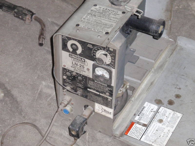

well after another hour no matter what i did i cant get it to work.The wire feeds no problem through the liner but when i go to weld within 5 sec it is jamed...Looks like a new gun and/or liner... After measure it is 15 feet..which looks like the standard.. Is there a sopecial liner to use with .045 fluxcore wire?
You say i should get a Tweco Model 4? I gotta do something..need this working as i sold my old stick welder..**** i should have kept that..LOL
   / LN-7 feeder Keeps Jamming #14
Well I like Tweco, been using them since the 1970s. Weldors on the welding forums really brag on the Bernard Q-guns, I've never used one. You may get away with a 200-amp gun, but you might want to think about a 400-amp gun, the Tweco model 4 is a 400-amp gun. Don't know about the Bernard guns but with the Tweco gun you'll need an adapter to fit your LN-7. Heres what my adapter looks like.
