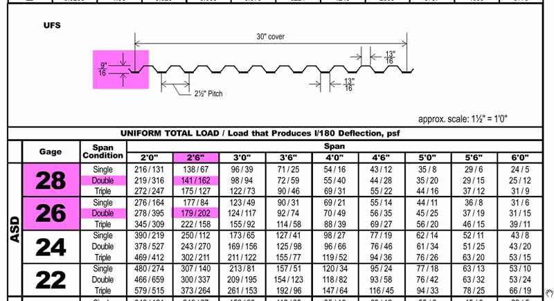

I was shocked too about the steel decking. It is 9/16. But I can't argue with an engineer. I ran it by the steel deck people and they agreed as well. It doesn't act as support for the load. It acts as support for the concrete until the concrete cures, then acts with the concrete as a composite structure. The steel deck eliminates the need for the rebar. 9/16" @ 24-26 guage is what the manufacturer calls for for a 30" span. I'm not shooting from the hip here. I'm getting my info from an engineer and from the manufacturer. It didn't make sense to me either until they explained what everthing was doing.

So basicly, you'll have a very expensive steel floor with a concrete top on it. Have they quoted you a price for the steel yet, and did you have an oxygen bottle ready or was one provided for you by the engineer and vendor?
I've seen and worked on a lot of steel decks as well as plywood forms for decks, and have yet to see a deck that thick.
Corregated steel decks less than 1/16 thick are self supporting across 6 to 8 feet when concrete is poured on them, and wood forms are usually supported with form jacks till the concrete cures. 9/16 steel on a 30" span is absolutely overkill.

Franz & Makers_Mark,
<font color="blue"> 9/16" @ 24-26 guage is what the manufacturer calls for for a 30" span </font>
There must be some confusion going on here (as often happens in this form of communication). Is this 9/16" thick plate or some kind of mesh with one of the dimensions being 9/16"? I ask this because you mention 24-26 guage which is about .024 - .0217" thick (galvanized)
9/16" steel plate weighs 23 pounds per square foot! You certaintly woudn't need any concrete on top of it to support a load.

I used the steel deck and it is a heavy gauge sheet metal
w/ 1" hi steps about 2.5" apart.
This stuff was HARD to cut w/ tin snips, used cutoff wheel.
I wonder if this has 9/16" high steps?
The higher the steps the more strength, my pour was 5'

I've attached a shot of the deck spec for anyone who is interested. Should clear things up. I even said to the engineer that I had no problem going to a heavier guage and taller "wave" pattern but said it wasn't neccessary - go figure /forums/images/graemlins/confused.gif

A picture is worth a thousand words. clears things up for me! Thanks!
