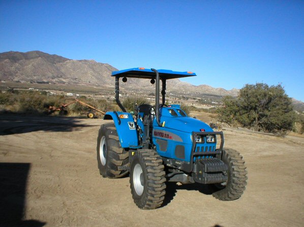

My 18-year old JD 870 has finally worn out it's front tires and I'm getting ready to replace them. It uses 7-14 R1's.
Both front and rears are loaded, and set a wide as they will go because of our hillside property. My tire dealer says the fronts shouldn't be loaded if I'm using it with a loader, claiming that doing so wears out the front wheel bearings. I suspect he just doesn't want to deal with re-loading them.
I do use it with the loader, though not heavily. I also use it with the loader off for mowing with a rotary cutter. With the loader off I add 4 suitcase weights to add control on the hillside.
I don't believe that the loaded tires have much impact on bearing wear, but I wonder if the weight of loading pretty small tires makes much difference in hillside stability.
Any thoughts?
Terry
Not sure how much actual side stability you will get out of it seeing as the front axle articulates freely. :confused3: Now with that said, I have all four tires loaded on both my 32hp & 75hp tractors. Filled tires give you a better ride, better traction, better steering, better load carrying capacity. Don't know if there is a real down side to filling them other than the flat tire scenario. :( Mine have been filled going on 10 years now. My only regret is that I waited 1 year to fill them from new on the 75hp machine, what a mistake that was. My 32hp tractor tires were filled 5 days after the purchase. :thumbsup:
My thinking is to fill them and get the additional front weights. Front weights can really make a difference. I doubled the front weight capacity on my 75hp tractor, HUGE working improvement. ;)

As I said initially, they have been loaded since I got the tractor new. My question was whether to have the fluid transferred to the new tires. I think the answer is clearly yes.
I should have been more clear about what I meant by "hillside stability." I understand loading the fronts does little or nothing about rollover because of the free articulation of the front axle. What I was referring to was steering control, which I suspect loading, and front weights help. I think I should go ahead and fill the other two weight slots as well.
Thanks to all who replied.
