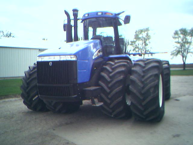

The tires on the tractor below have 7 psi and look flat but that is what the manufacture calls for. They are around 36" wide.
Dan

The tires on the tractor below have 7 psi and look flat but that is what the manufacture calls for. They are around 36" wide.Dan
They look just right with slight squat of sidewall.
That's a very nice rig.
