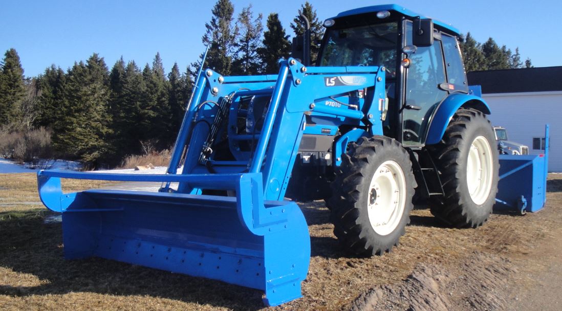

I use AGRI-LIM 50, it is made in Quebec and is environmentally friendly. Non corrosive and all that stuff. The rest of my toys have calcium but I did have to change a rim and tire on a 510B John Deere backhoe, expensive. Made a mess of the lawn for sure. Nothing lasts for ever, but it sure helps to keep your rims painted up. Eventually I can see calcium being phased out in big industry due to environmental concerns. I worked in a potash and salt mine for the last 31 years and anytime we had a brine spill it would have to be reported and cleaned up. Not like years ago when you could just hose it down.
