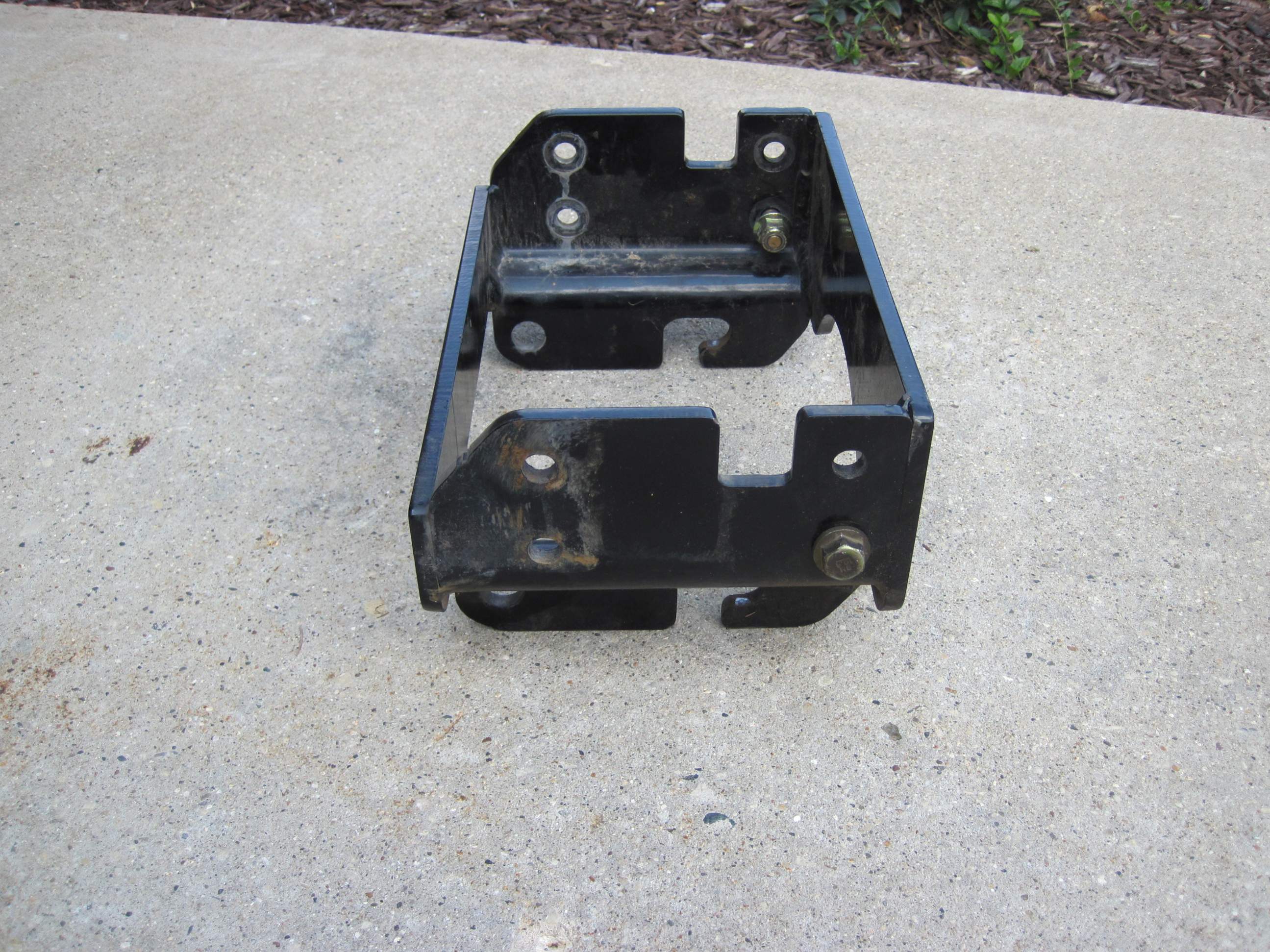

Yes, we used the 47" snowblower on our 2320. As far as changes for the 2520, I worked in a new PTO shaft (the 2520 requires a little longer shaft) into our purchase of the 2520. I also ended up trading with our dealer straight up my Front Attaching Support Kit, LVB24895 (2320 - pic 1) for LVB25302 (2520 - pic 2).
There are plenty of discussions as to whether the 47" is wide enough for the 2520. I am going to try it and see how it goes this winter. If I am not satisfied, I will investigate extensions or upgrading to the 54". I also intend on moving my rear tires back to the narrow position when I place the blower on the fall.
I recognize what you said about the slow loader on the 2320. I will say there is a very noticable difference on the 2520. As far as HP, I don't notice the difference between the 2320 and 2520 but I do not do a lot of heavy work with either of my tractors. But I have to imagine if you moved up to 2720, you would notice the increase in HP.
