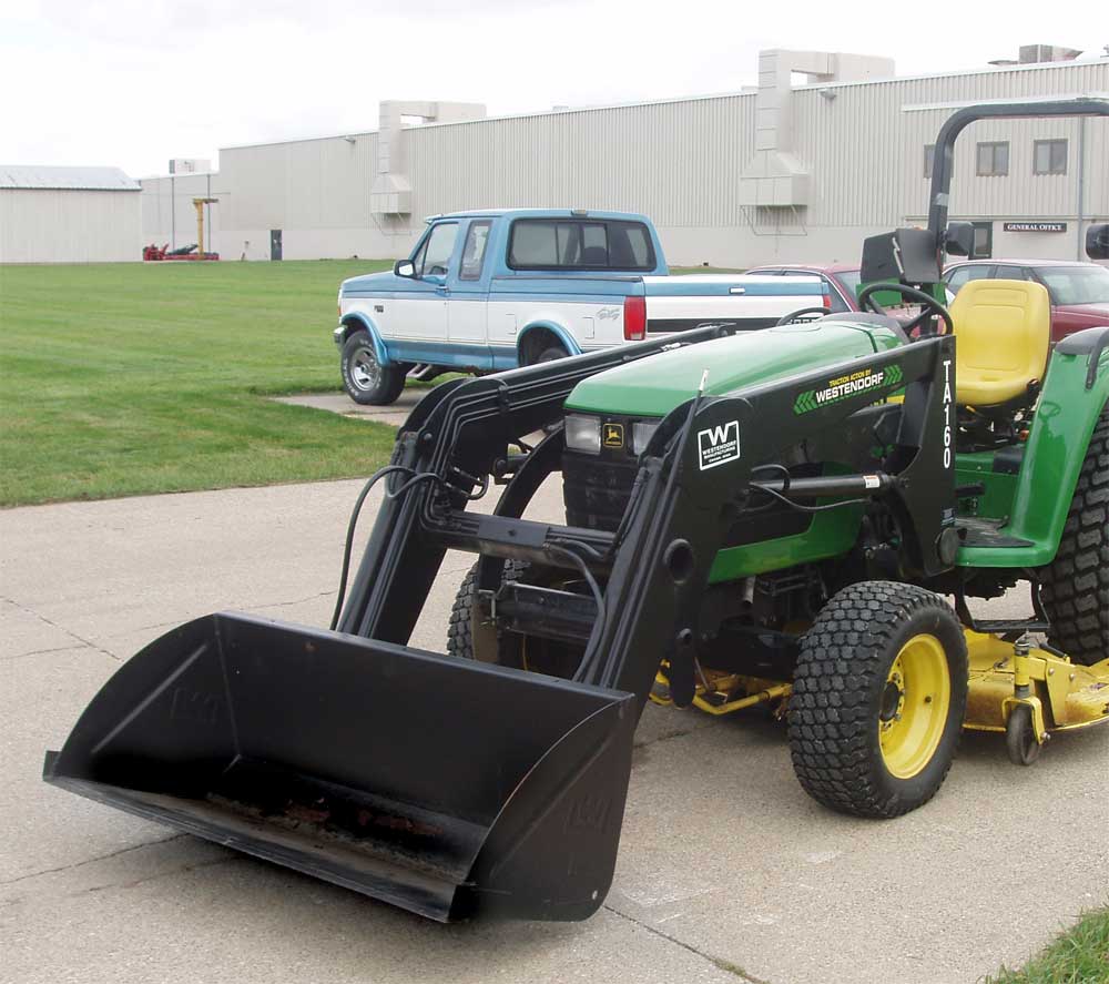

Lookin at the Deere 3203 tractor and looks like a good machine. Although after I checked out the specs on the 300 loader, I was not to crazy about the lifting capability of it at only 700lbs.
I know that this machine is a "knock down version" of the 3320 and am wondering if anyone ordered one with a 300X loader? would It mount up to this tractor?
Also was looking at the Woods backhoes and discovered that they offer a solid mount 7' or 8' backhoe for the 3203.
Has anyone put a backhoe on this machine?
Thanks for any input/info!

If really interested in 3203 suggest follow up with member JohnDeereDLR, based on this comment in his post 2/24/2007 in thread "John Deere 3120 against Kubota"
Quote"
You can indeed put a 300X or CX on a 3203 tractor. I do it all the time at my dealership. The 3203 and the 3320 have the same pumps in them. You can even put the 447 hoe on this tractor.
JD DLR
End Quote"

Wouldn't know a thing about the backhoe. I do, however, have some practical experience with the 300X loader. My 3203 came with it, the dealer (whether he knew what he was saying or not) endorsed it, and I've had no problems with it after many hours of rigorous use.
