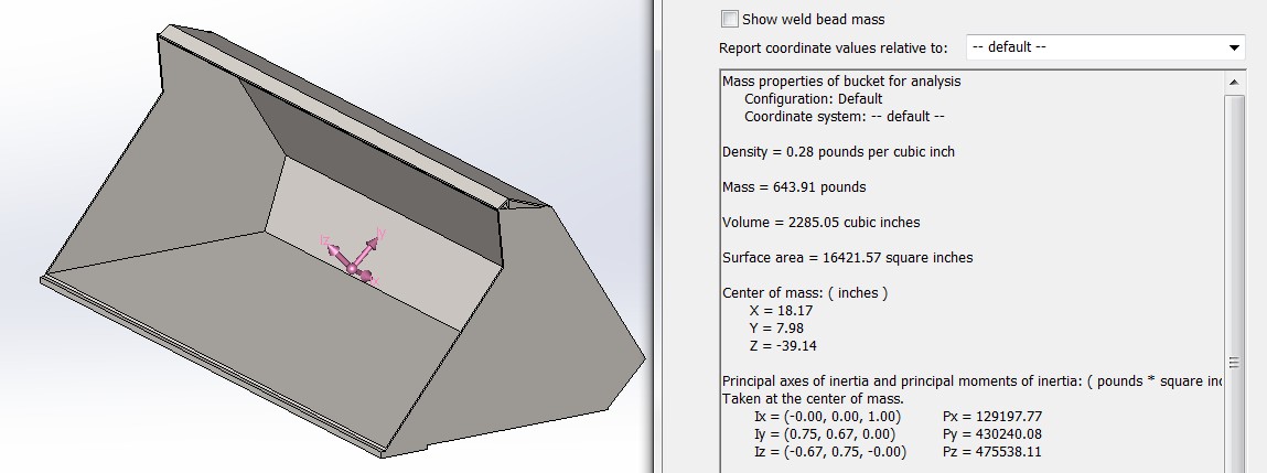

#32
I updated the solidworks model to include the actual wear plates I installed, etc. Looks like I'm at 650 pounds plus welding wire and chain hooks.

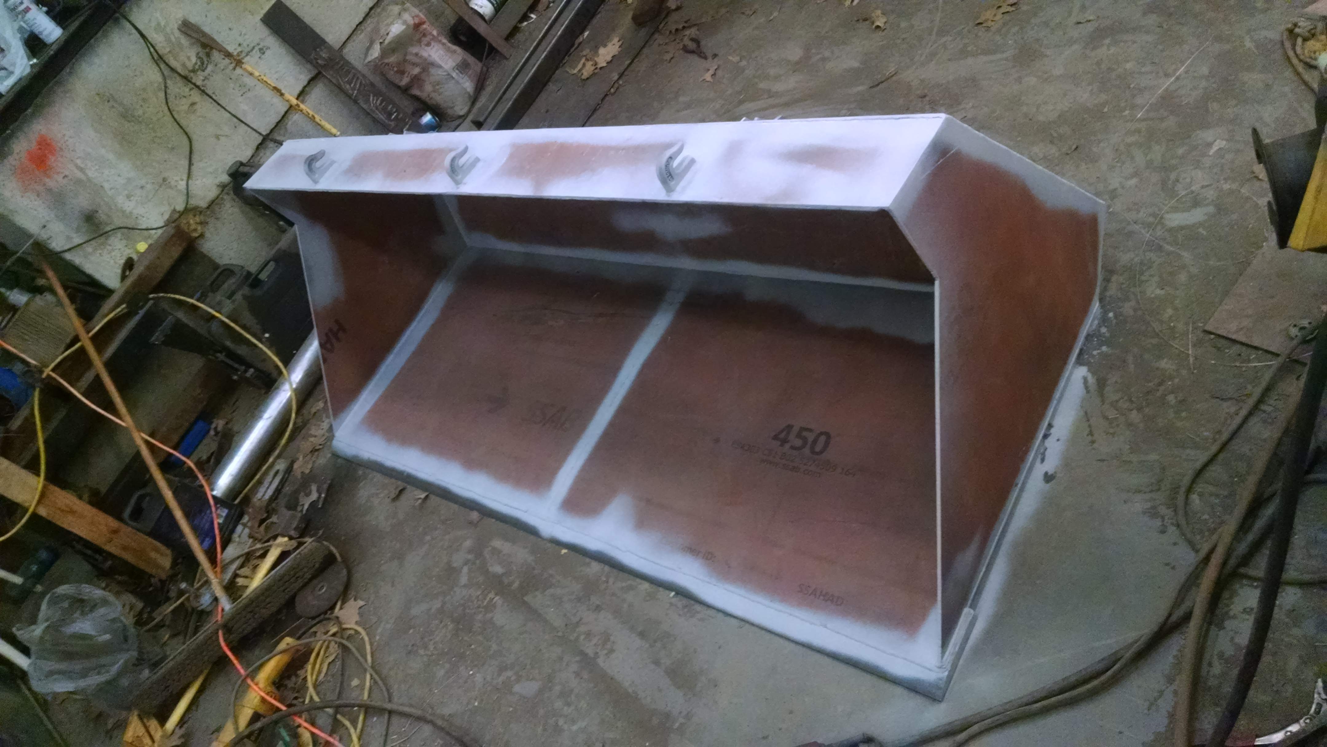

#33
Bucket has primer on all the exposed welds.
I tried to get a picture of how I reinforced the top lip, phone camera did what it could with poor lighting.

   / Loader Bucket Build #34
jb1390, seems you are getting some flak on material choice. I also would have used an AR steel, as I have tweaked a few standard duty buckets with a 45-50 hp tractor, now I have a 72 hp tractor. Your mounting angle is not excessive. It closely resembles the angle of my LS P7010C bucket.
I think you have inspired me to build a HD stump bucket.
CT

Thanks CT, be sure to post up a picture of your build for us to enjoy!
The mount angle is a bit steeper than the stock bucket or my neighbors skid steer bucket. 60 Degrees, so a 30 degree angle on the bottom plate when rolled back at ground level. I did cut a piece out of cardboard first to make sure I was decently happy with the size and angles held up to my machine before I cut the steel.
