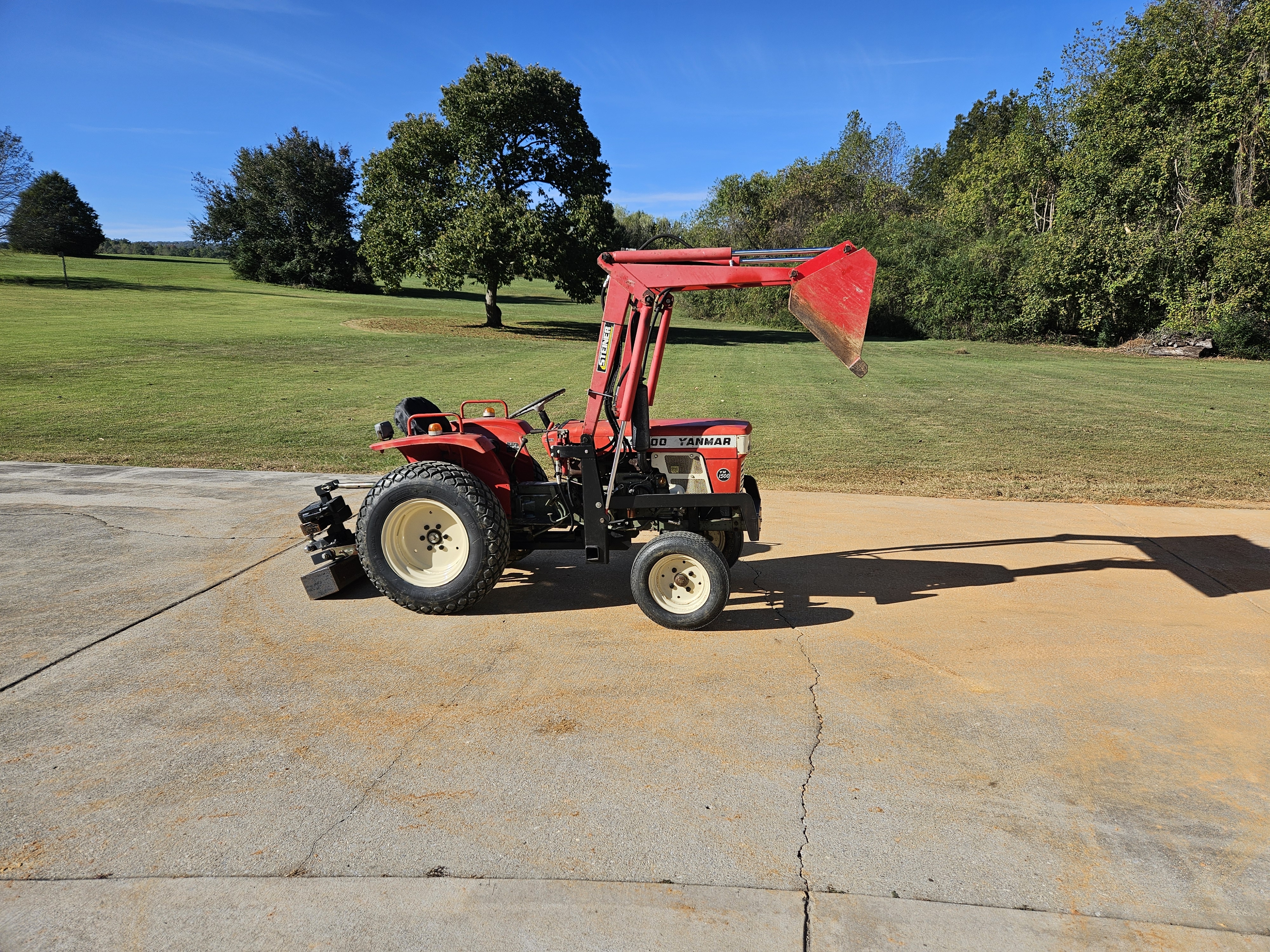

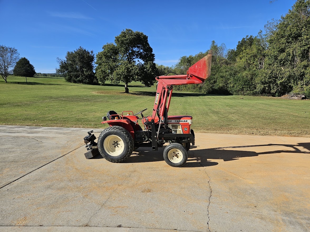

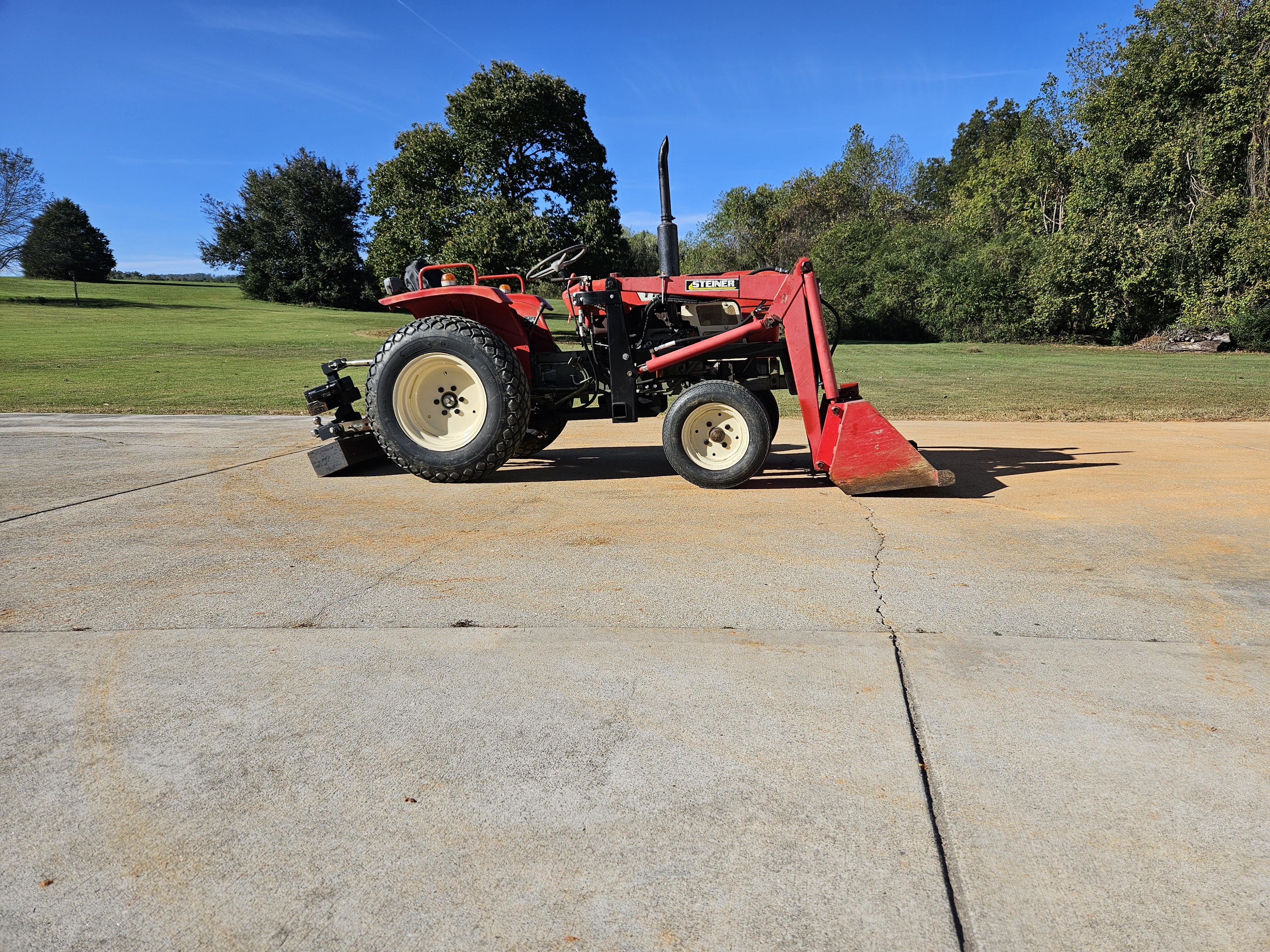

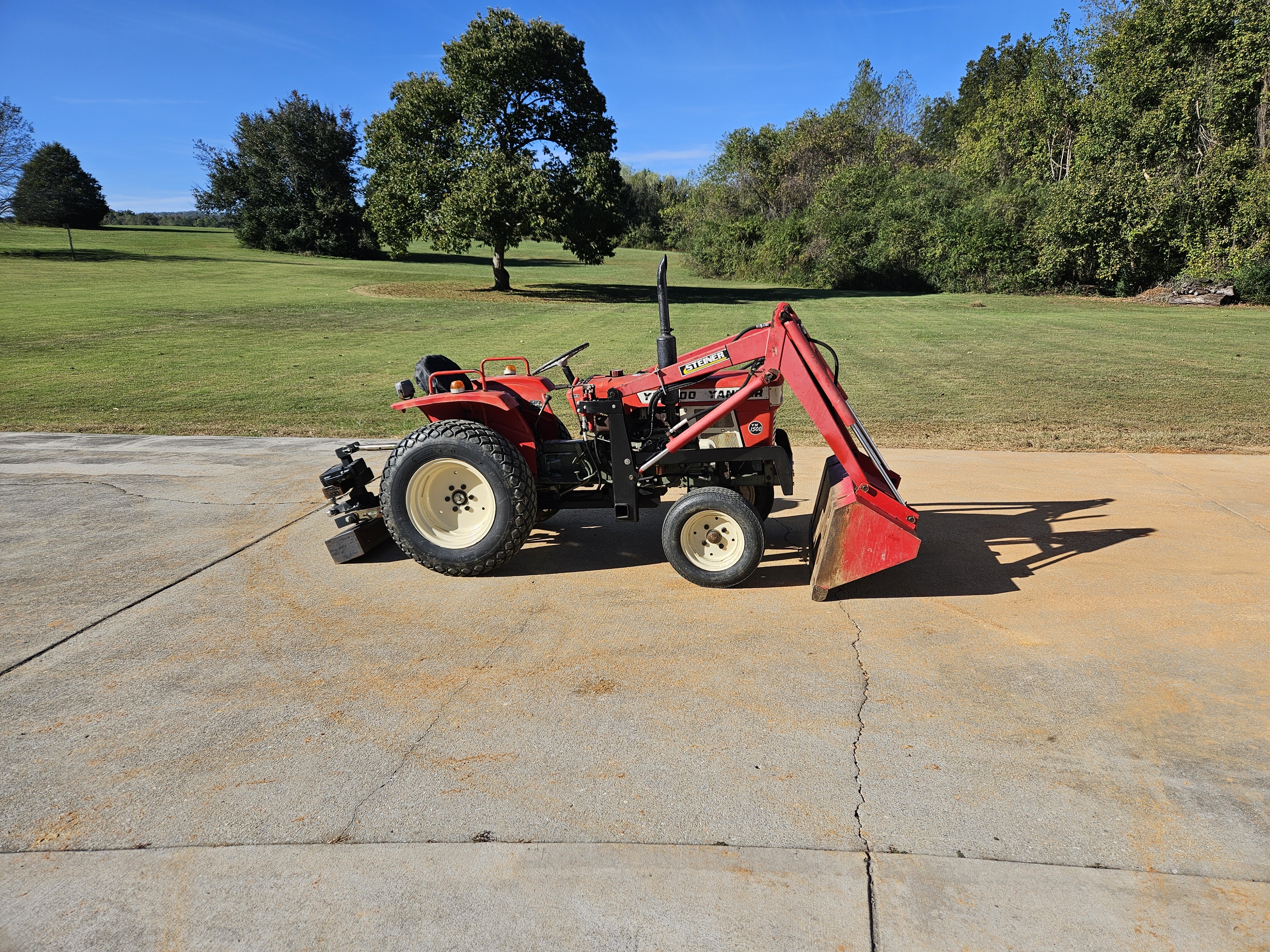

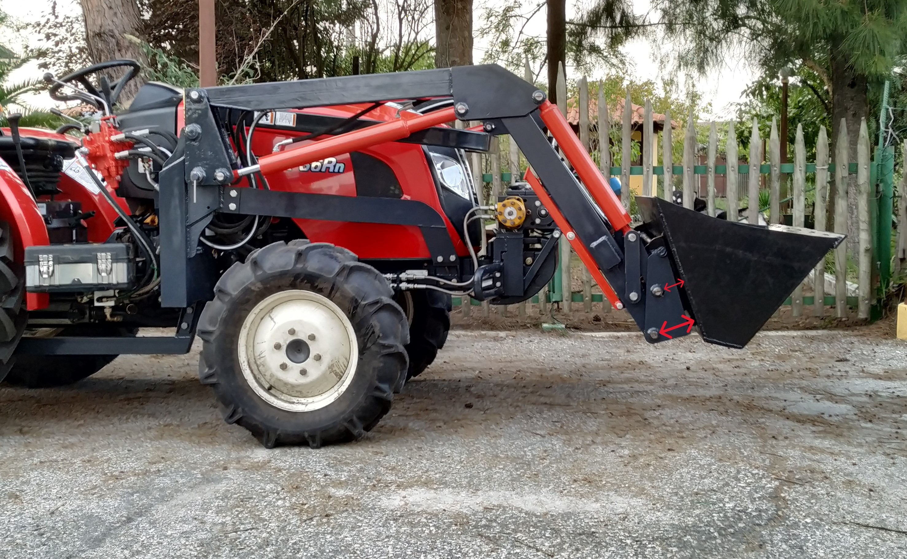

I adapted a loader from a Steiner to fit my Yanmar tractor. My issue is that the bucket does not curl back far enough at low heights; when I drive around with a bucket of dirt I lose a lot of it. How should I change the geometry to gain more curl?
Ground level full curl:
Ground level full dump:
Max lift full curl:

Max lift full dump:

Looks like my bucket geometry.
If I have dirt in it, I have to raise it up to headlight level if it's fairly full or I'll lose a bunch.

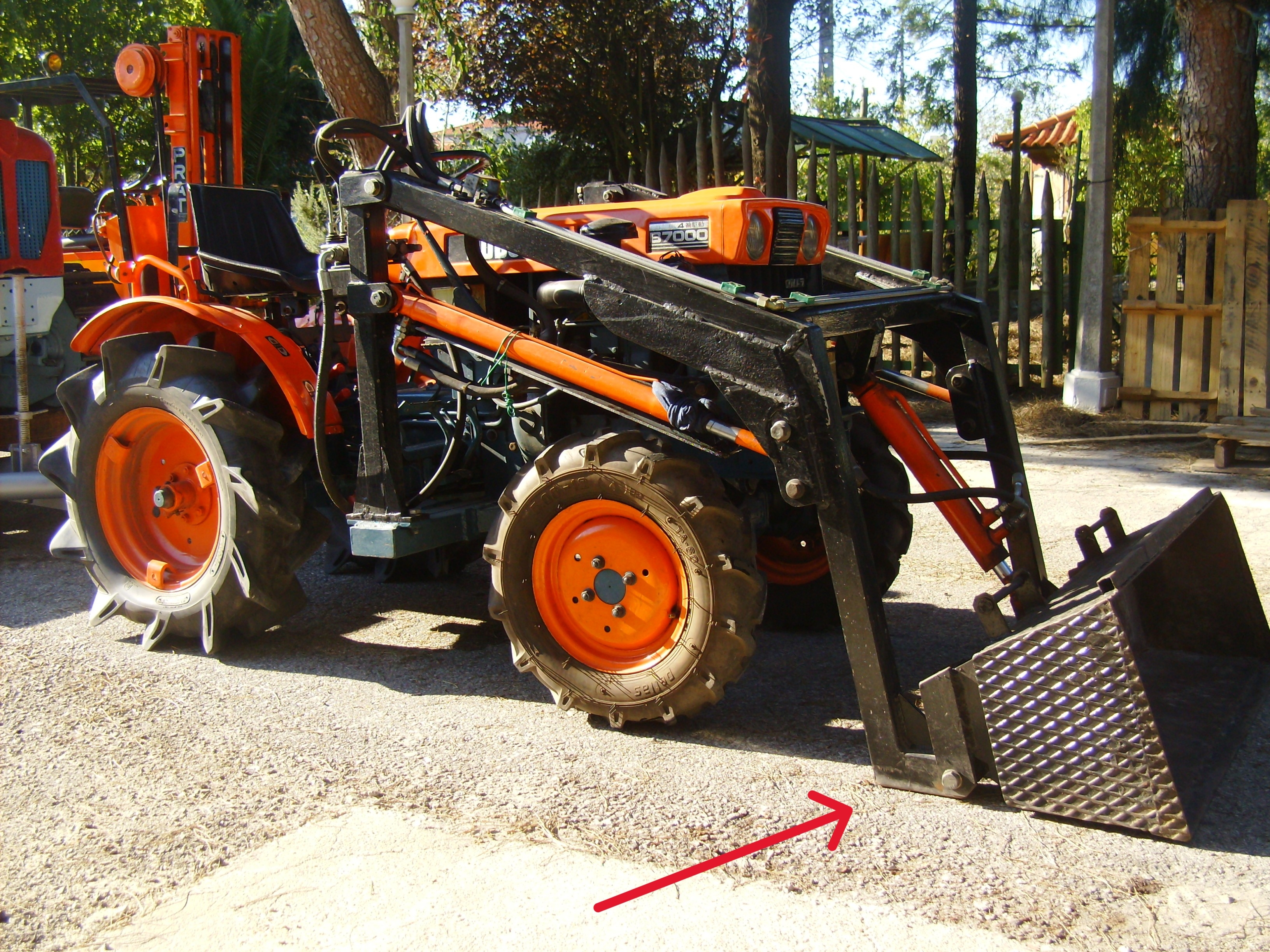

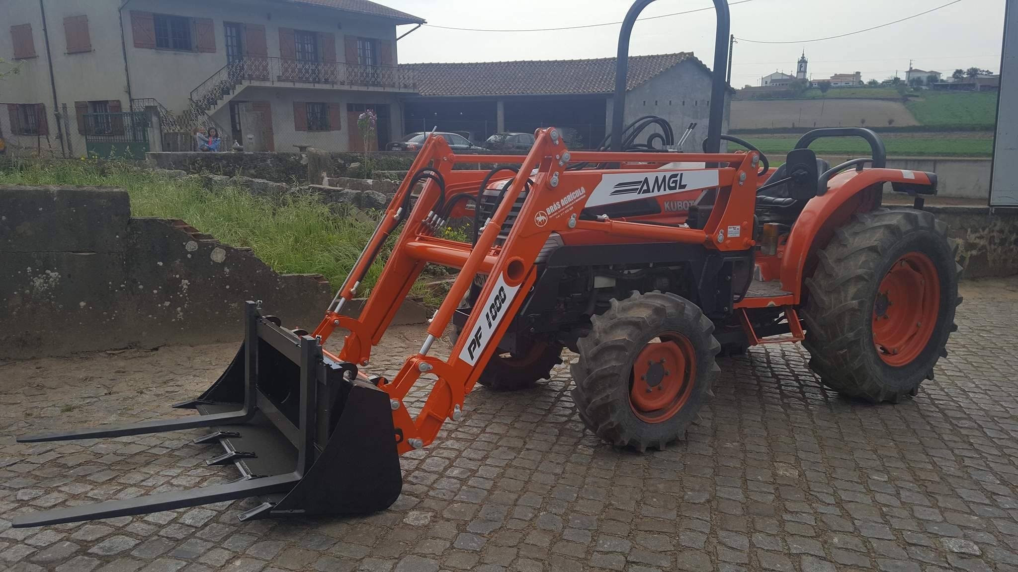

The way I see it, you can either modify the bucket or the end of the loader arms, but I'll say right away, it will give you more curl but not an huge amount more, plus it will cost some dump angle at max height.
Essentially, you want to space the bottom of the bucket from the loader arms while keeping the top pin on the bucket as close as possible to the bucket. Like I said, you can either do it at the loader arms (see picture) or at the bucket by extending the ears out.
Before welding anything solid, make sure you have full travel of the cylinder and it's binding anywhere. Been there, done that.

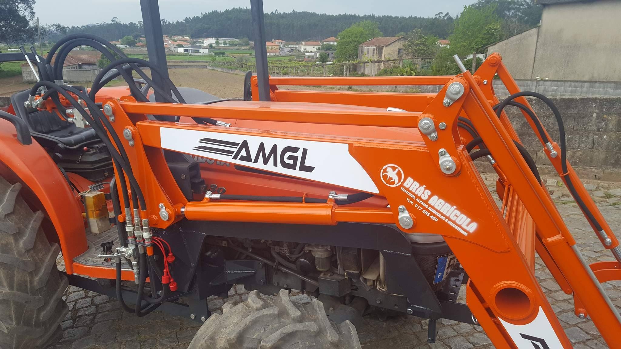

Here is a picture from the loader I built for the Kubota B7000 I had back in the day. Note the "kick out" at the end of the loader arms.
Without having that parallel linkage you see on other loaders, it's very tricky to have any sort of curl back while maintaining any sort of useful dump at higher heights but to add this linkage to your loader, it's quite a project and would require shorter cylinders.
Here is another picture from the loader I built for my Branson. Mine has a quick attach but let's ignore that and imagine it's just welded to the bucket. This is what you would do if you extended the bucket ear. Note the distance between the bucket and the pins. The bottom one is spaced further than the top one.
Further more, you could cut the bucket and make it more triangular shape at the cost of bucket volume and also bucket dump at higher heights.

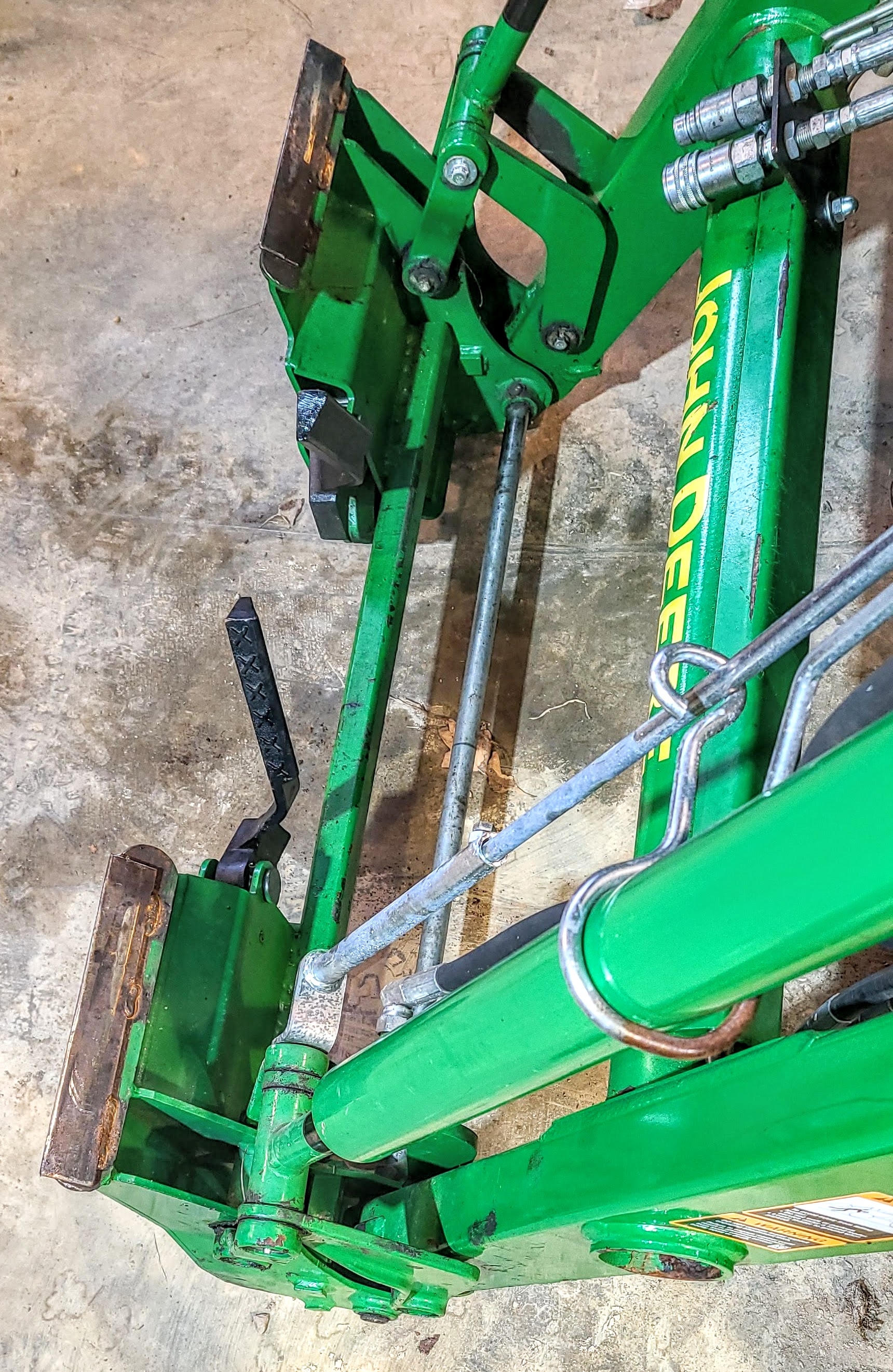

   / Loader bucket needs more curl #7
Great discussion and some beautiful loader work. I agree that adding any more curl to what you have risks dumping the bucket in your lap at full height. I bet most of us have done that or close. Some early skid steers were well-known for dumping on the operator. I watched a guy loading wood chips spill so many on himself that we had to dig him out of the cockpit. Unhurt. Good thing it wasn't gravel.
So I'm going to say that with those loader arms and that bucket you have done about the best you can. And congratulations to everyone for really good loader designs.
I agree with ptsg and others that kicking the bottom of the bucket forward seems to be the key to more curl, before doing that please consider some sort of spill plate to protect yourself at full lift.
But you asked if anyone had a geometric solution, not just more problems.... and I don't see a simple solution just using the parts you have there.
I do wonder if there is a solution that involves leaving your arms and cylinders as they are, but switching to a round back type of bucket. A round back bucket might be able to be combined with ptsg's clever extended bucket ears to make a make a more usable curl geometry. Might be worth drawing up that sort of design.
