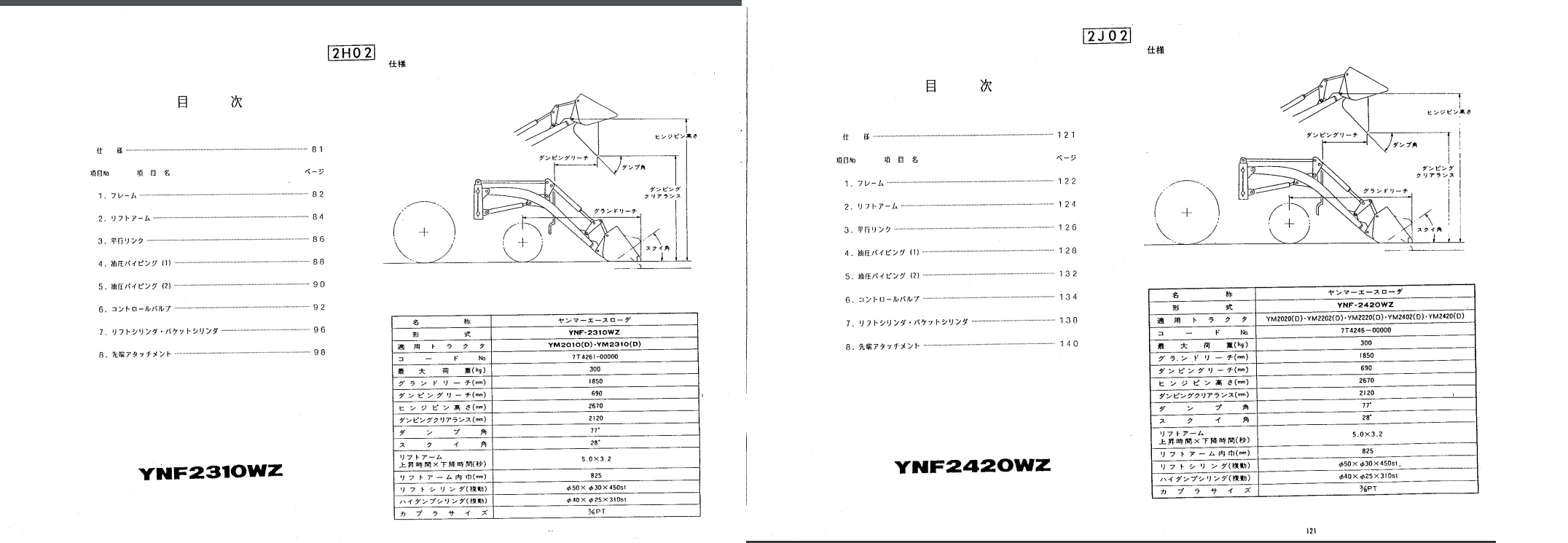

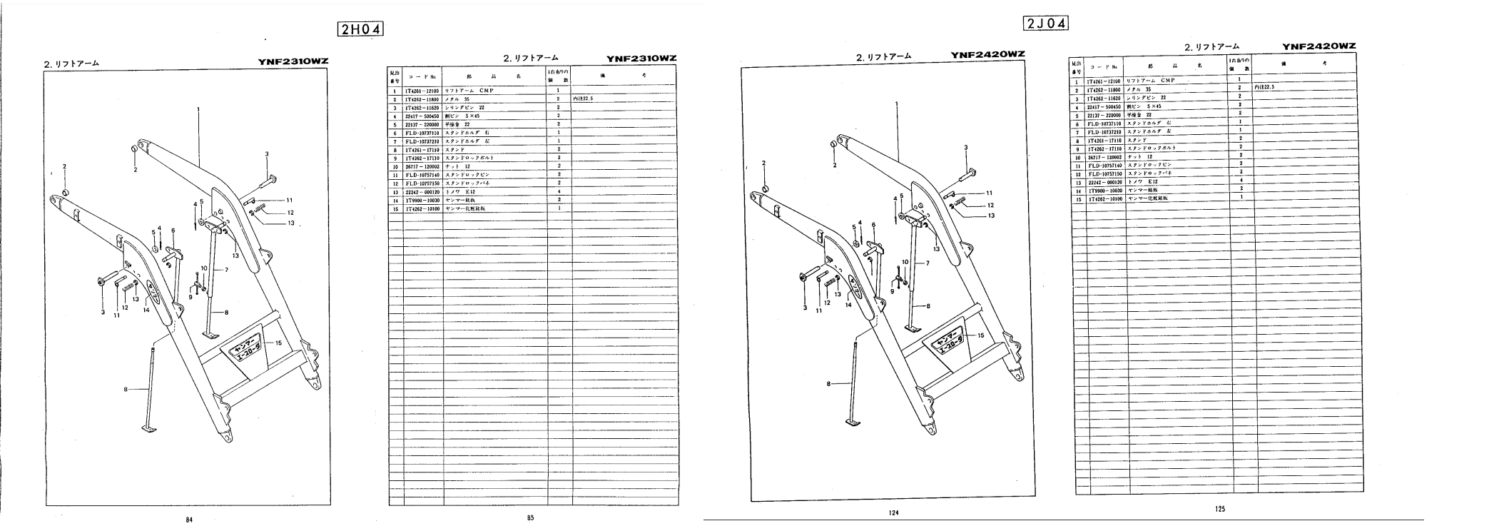

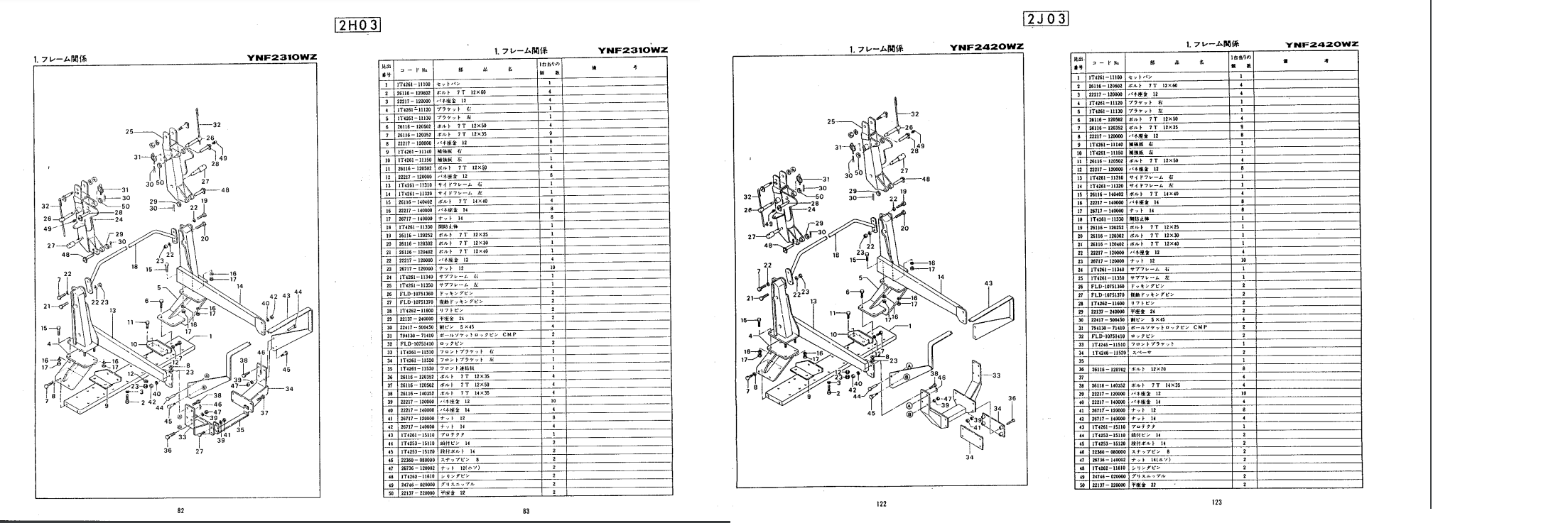

I would say the loaders are a direct fit between the 2310 and the 2420 given the factory loaders. Included some comparison shots for future reference should this topic come up again.
The overall factory kit between the two tractors has a different part number but that appears to be due to plumbing differences for the hydraulics. The various structural assemblies have the same part numbers between the two. Again you don't start seeing different part numbers till you get into the hydraulic plumbing assemblies. To me that makes sense given that they're mechanically 2 different series of tractors.

Realizing now my comparison screen grabs aren't the best. Anyway, you get the picture. If I get a chance I may redo these at a higher resolution..
ETA
So mechanically for mounting the loaders between the two models, the same parts are used. This is a huge plus in your favor as the Koyer loader would have it's own hose and pipe routing.
Looks like it's a GO to grab that loader now. :)
