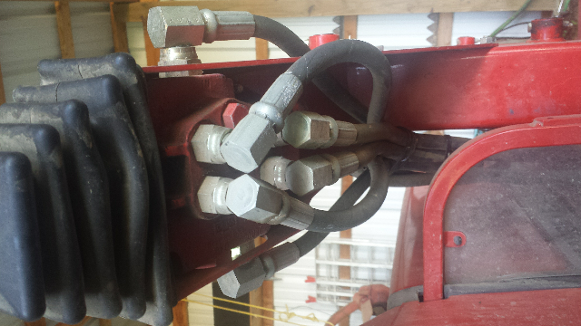

/ loader control for rear remote
#9
So by looking at this where do I add qd's to thanks for info
/ loader control for rear remote #10
jacobsdaddy06
Does your SA cyl have one hose port and a breather port, or is that cyl a DA cyl with a breather adapter in the rod end.
Can you show picture of your SA cyl.
Most SA cyl pressurize the base port to extend the cyl rod and use gravity down.
Is your sickle bar mower powered up or down?

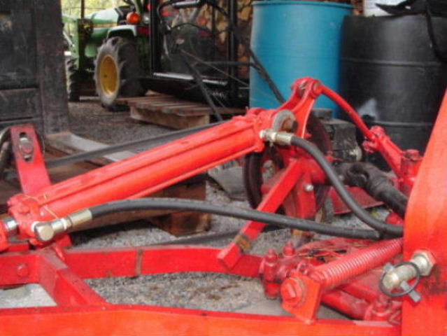

#11
this is what im looking to do found pic on red power website, if i have one going to curl and one to dump this should work right?
/ loader control for rear remote #12
Those are DA cyl and a loader valve will work, just don't use the float or the regen.
Actually, you could use float if you wanted the sickle bar to follow the contour of the ground.
Any two spool valve will operate those cyl.

/ loader control for rear remote #14
Jim,
That SA cyl has a port somewhere, or it would pull a vacuum. It might be on the gland nut. If you put your ear close to the cyl as you retract it, you should hear air or if you put soapy water all over the cyl, you might see bubbles.
Those cyl posted above with two hoses each are SA cyl or someone has added a hose to the vent port.
You should be able to tell by looking at the valve, If he is controlling a SA cyl using a DA valve, one of the work ports would be plugged, or the other hose is gong to tank.
A true SA valve only has one work port.
