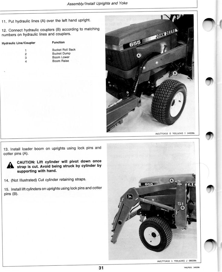

Hi there I have no way to tell how to hook up a model 52 loader to my 855....any help would be great!! I know there are 4 front facing hook ups but dont want to hurt anything by hooking them up wrong....THANKS!!
   / Loader control hook ups on 855???? #2
i would guess the inside two on the tractor are one function and outside two are the other. take the lift hoses and try it. you won't hurt anything just keep trying till you get the right combination.
thanks so much Hanson.....I figured it out....the loader had numbers marked on the hoses and as it goes..looking at the hook ups its 1-top left..2 is to the right of it...3 bottom left and 4 to the right of it....ya i feel like an idiot now...LOL thanks so much~:thumbsup:

   / Loader control hook ups on 855???? #6
I was going to provide this page from the 51/52 operator manual, but when I saw all it said was to match up the numbers I assumed yours must be missing/worn off. Glad you found them. Did your loader come with the optional parking stands? They are sometimes stored in the torsion boom between the arms.
