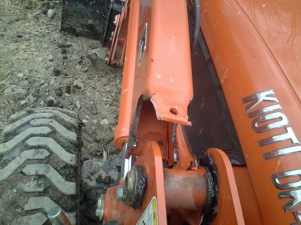

No penetration on those welds...factory screw up for sure. Man, I have picked up many many 2K+ loads and am glad that never happened...wow.
MotorSeven,I agree as I have picked up 2,000 lbs loads with my loader.WOW is a under statement.coobie

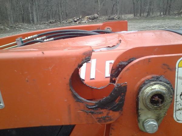

WOW !!!! That's about the worst case !! I'd ask Kioti to ship the parts to you at no cost and send the dealer to install once they arrive ! Kioti should cover the dealers costs to install !!!
   / Loader Failure
#23
Seeing that this was such a catastrophic failure that it dented the hood in the process, it had to be scary when it happened, Kioti, not the dealer, should setup and take the burden of cost for all necessary repairs, transportation included.
I wasn't on the tractor. My wife was driving it. No transportation and the dealer said they couldn't do it at my house. Still like $350 for transportation. Sucks.

One cylinder was bent; they are replacing that.

Hey anyone out there ever have this problem. My Kioti DK40SE is 10 months old and this happened while move a load of manure. Kioti is replacing the armiture structure and the hood, but I have to pay fr transportation to the dealer. Since I live pretty far(about and hour) it's going to cost about $350. I'm kind of pissed about that. Let me know if you've had any dealings like this.View attachment 314629View attachment 314630View attachment 314629View attachment 314630

So how did the hood get dented in this process anyway? Did the loader arm move over that far and hit it?

Catastrophic failure due to defects in materials/workmanship. This is not a simple under warranty covered repair like a bad instrument cluster, or similar. Kioti should step up and cover the entire cost of effecting a fast and safe repair for the owner without any expense to him. It's called good will, and Kioti can afford to pay for it and write it off as a business expense. NOT every repair which needs transport should be covered, but this is one of the ones that deserves to be covered by Kioti.

Is there anything the user could have done to weaken the joint?
I was talking to a neighbor today who said his brother was propping the tractor up with the bucket (perhaps a crosswise extension on it) while using the backhoe, and the side to side action of the backhoe would tear up the bucket, although as I understood it was the mount between the bucket and the front end loader.
Even if the failure happened while working in the barn, it could have been weakened from earlier work.
Still, a catastrophic failure is not desirable.
