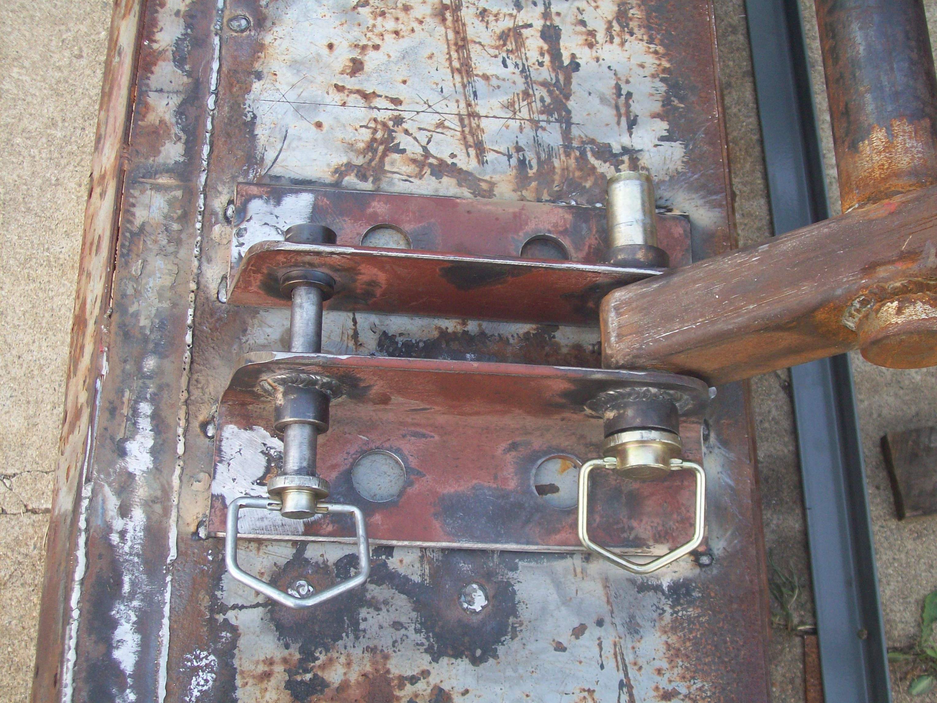

Great job. Like the pins you chose. They should be real easy to change when the time comes. What did you use for bushings?
   / Loader FINALLY Done!
#23
I used standard DOM tubing for the bushings. Trued them up in the lathe (Not absolutely neccasary, but it makes for a nicer job, and I get to use the lathe!) The pins fit very well in the bushings, with just a slight clearance for grease.
