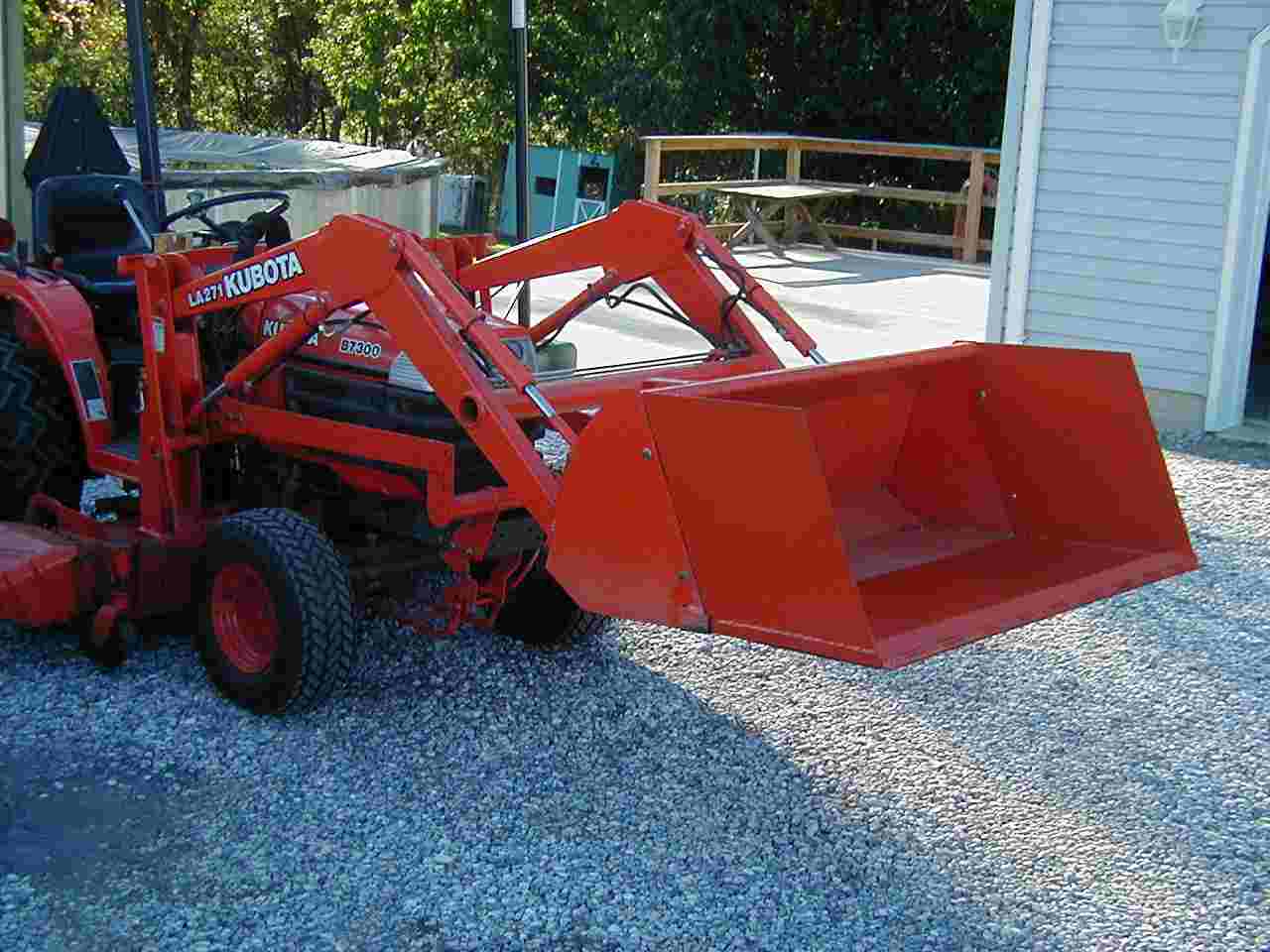

I use my loader in one specific area where drifting is always a problem. To combat the problem of a 6 cubic foot bucket, I fabricated a bucket extension that adds 18" to the bottom surface of the bucket. It's only good for light duty (snow or mulch), but four bolts and it's off. I also incorporated two skid surfaces on the bottom to keep the edge 1/2" off the surface. I've used it for three winters now and it almost triples the capacity of the bucket.

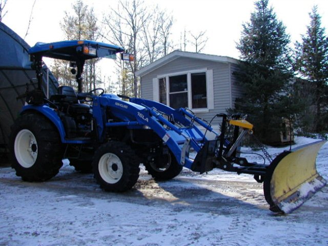

We have a snowblower but it's not the best choice for a gravel drive and the loader itself can be very slow for snow removal. However there is an alternative and this year we are working toward adding a plow to our 17LA loader, fact is it's in the works now. Used plows can be had in most areas for a song and a dance requiring only minor modification. A plow should be a lot easier to use than looking over my shoulder to use the 3 point snowblower and a lot easier and quicker than changing all those broken shear bolts because of the gravel getting sucked into the blower.
Attached is a picture of another TBN members plow, the same as we are planning to add.
