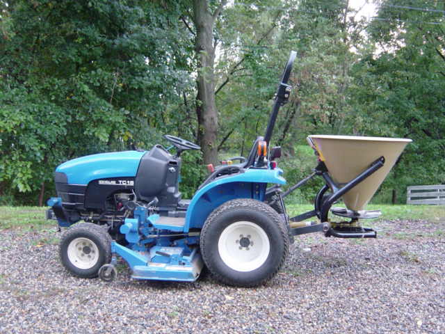

I have a 2003 NH TC18 (the one that should take a 7106 loader). I have the opportunity to buy a small, used loader and can make my own mounting brackets. However, I can't find a good picture of the TC18 with a 7106 (or Koyker 80, etc.) mounted on it to be sure I have the correct mounting points. I think these are on each side of the case (obviously) and to the front bumper (where my suitcase weights are now). Anyone have any help or a pic they can send me (TC18, TC 21, etc. are all similar)?
Thanks. John.

My '02 has the 7106 - I think they made the switch in early 03. What color is your CHassis - medium gray or closer to black.
