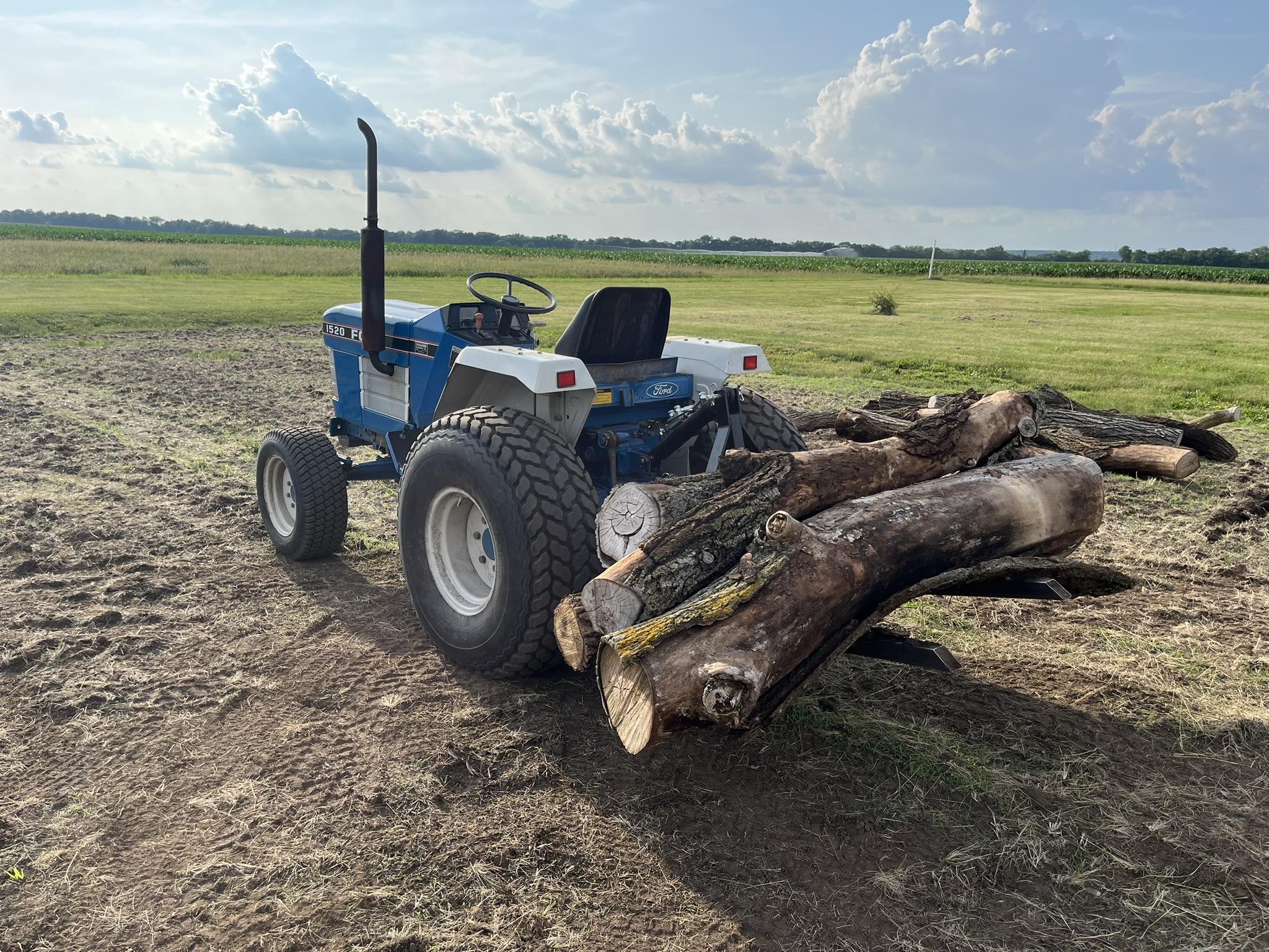

I'll still need a loader eventually, but this little tractor has been invaluable the last couple weeks. I built a set of forks and installed a hydraulic top link. Game changer for box control when grading the drives. The forks have been handy for moving anything and everything I have laying around. Really been enjoying the work.
