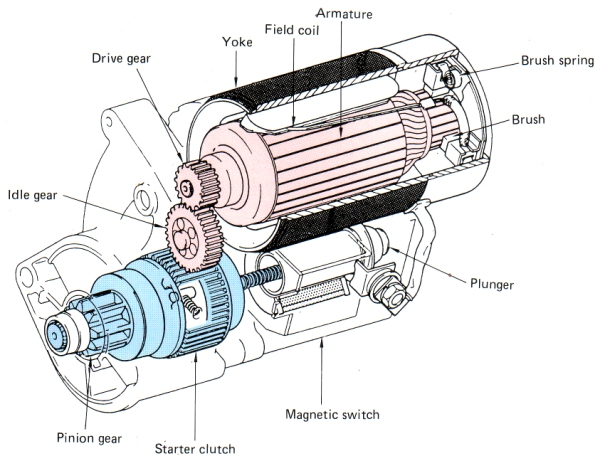

This is the new generation of starters for our machines. OSGR. Way better than the old solenoid type. Starts the engine in very cold temps too.

Yes, the original starters are rated for 1.2Kw. There are 2.0Kw version in the OSGR types. Thus, my posting showing the ASAP link. :)
Added: With an OSGR starter, some can have the driver motor replaced to a higher Kw type for more frantic spin as 'California' mentioned.
