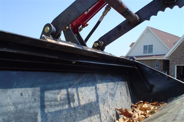

Wayne, does the grapple get in the way of loading dirt, etc. in any way? Looks like it might not be up and out of the way when going into a pile. Also, I'd like to make sure of how you attached it. It's the grapple on channel on the bucket, right? Thanks, John
   / Loader Grapple Upgrade
#16
The grapple raises high enough to be clear for loading dirt but it might be in the way of obstacles. You can take it off with three pins and two quick disconnects. The channel iron is under the top of the loader because the top of the loader is really not that strong. Here is a pic of the 4" channel iron.

</font><font color="blue" class="small">( The channel iron is under the top of the loader because the top of the loader is really not that strong. Here is a pic of the 4" channel iron. )</font> Okay, so is that a piece of wood under the actual grapple? John
#18
Yep, that is two pieces of 1" oak spacers. They may or may not be permanent. In the full down position right now the grapple is about 3" below the loader lip. Obviously with the spacers out it would be 5". Probably not that significant either way.
   / Loader Grapple Upgrade #19
Thanks for the responses Wayne. It looks like a real work saver and I sure will consider doing one myself. Thanks for sharing. John
