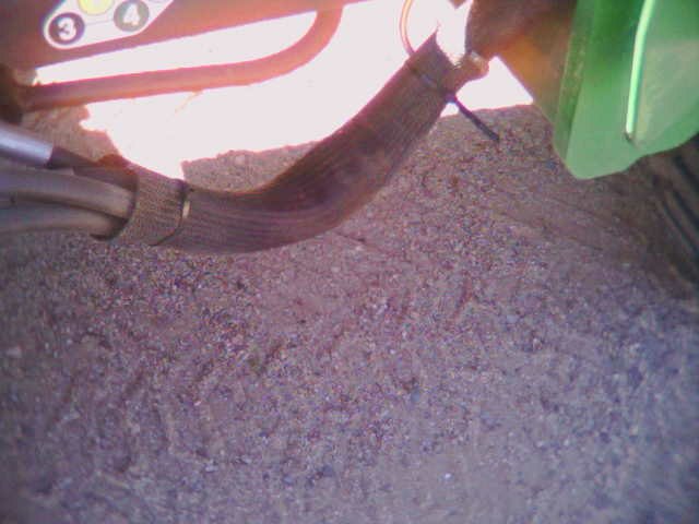

rvtech:
I have 2 brackets. One on the FEL Upright near the top that starts the line curving down and towards the engine side of the support bars that hold the FEL up when it is off the tractor. The second is under the platform just below the forward and reverse pedals. See the next few pictures showing how my hoses are routed. They do not rub against the wheel.
I disconnected the lines from the quick connects and re-connected them starting with connector #2 (silver) and the leaking seems to have stopped.

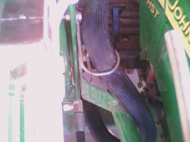

   / Loader hose question #13
Another angle on the line routing

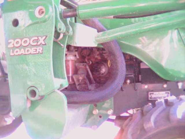

   / Loader hose question #14
One showing clearance between wheel and lines.

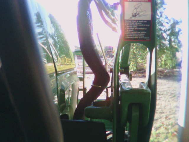

   / Loader hose question #15
Picture of first bracket from drivers seat.

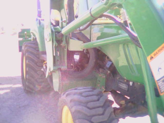

   / Loader hose question #16
Final picture is the bracket beneath the reverse pedal.
