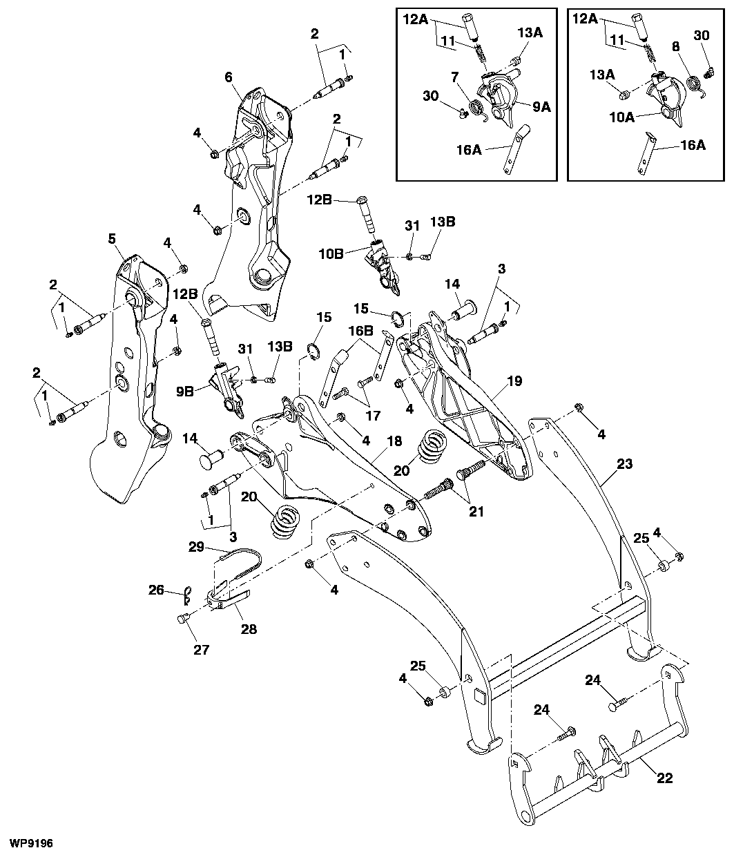

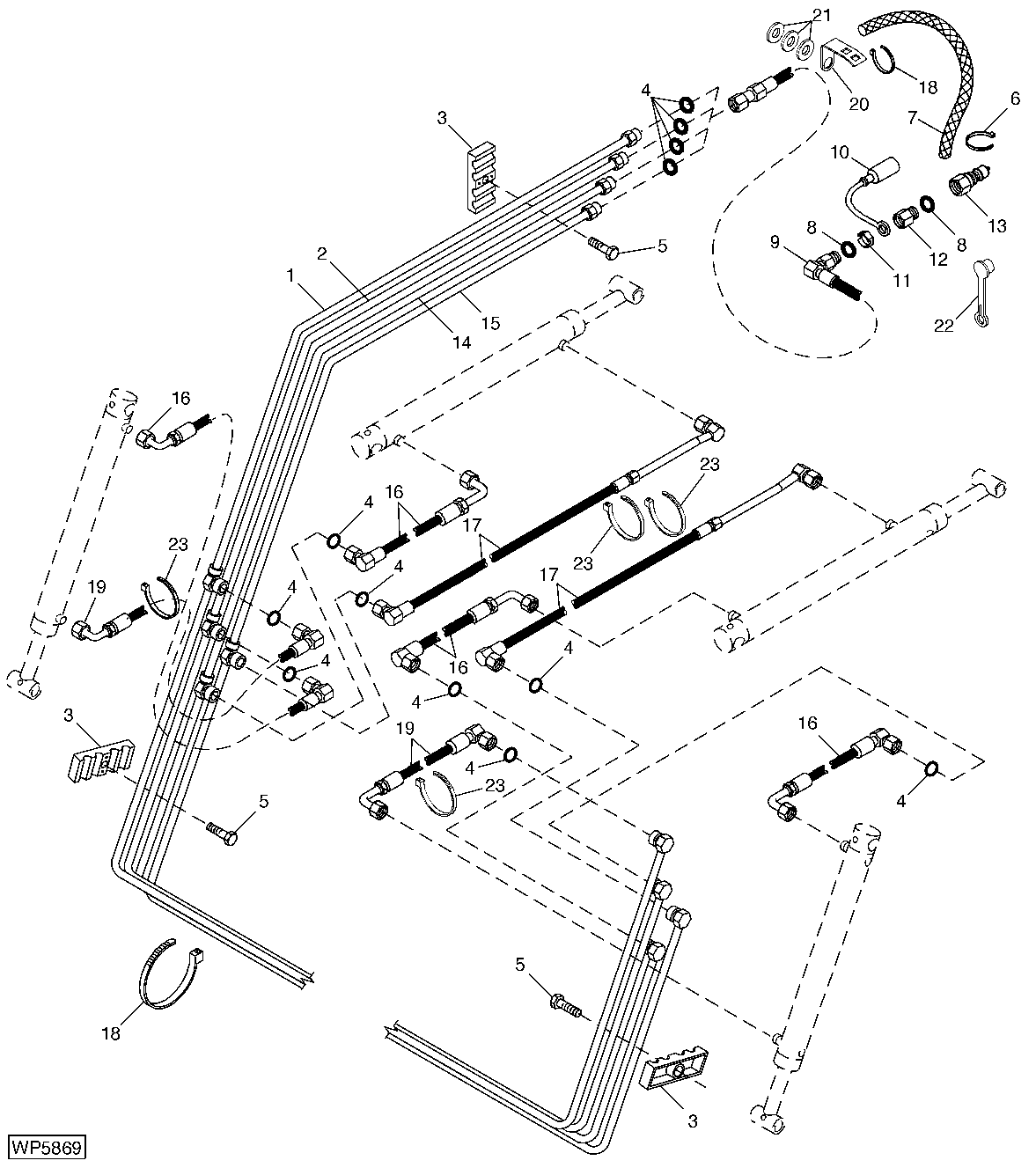

18 N189220 TIE BAND
20 W50298 HOSE SUPPORT
21 24M3527 WASHER (17 X 24 X 2 MM
Youi need # 18, 20,21 on the first picture and # 26-29 on the second. They came with the FEL but never put them on and the dealer will send them to you. Bungying to the rail isn't a fix.

just checked and they are on mine.......I think I found out why they were rubbing the hood......The dealer had the hoses hooked to the quick connects at an angle towards the hood forcing the hose bundle to lay on the hood side......I re-hooked them straight up and down and the hoses now clear the hood by 2" and stay close to the loader arm........Im still gonna tie them to the arm in one place to keep them from hitting.....
