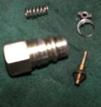

AHHHHHHH......I finally got it through my thick head and yes the tit that sticks out is no longer spring loaded. Could not repair, so I will pick up a new one tomorrow.Thanks to you guys for hydraulic quick connect 101. If you were closer I would buy ya a beer and a steak. /forums/images/graemlins/tongue.gif

Creeper, were you able to make the repair? If you could post a picture of what you replaced it would be really helpful.
Thanks from a fellow 790 - 419 owner.

I replaced the coupler and all is good back to cleaning up pasture tonight. I will try a pic.

The small split ring was dislodged and I was unable to repair it without bending so for $6 I bought a new one and a spare in case there is a next time. As others said it will look fine ,but if there is no spring tension it dont work.

Thanks Creeper, the picture helped me "see" what the problem was. /forums/images/graemlins/grin.gif Glad you were able to make the repair!
