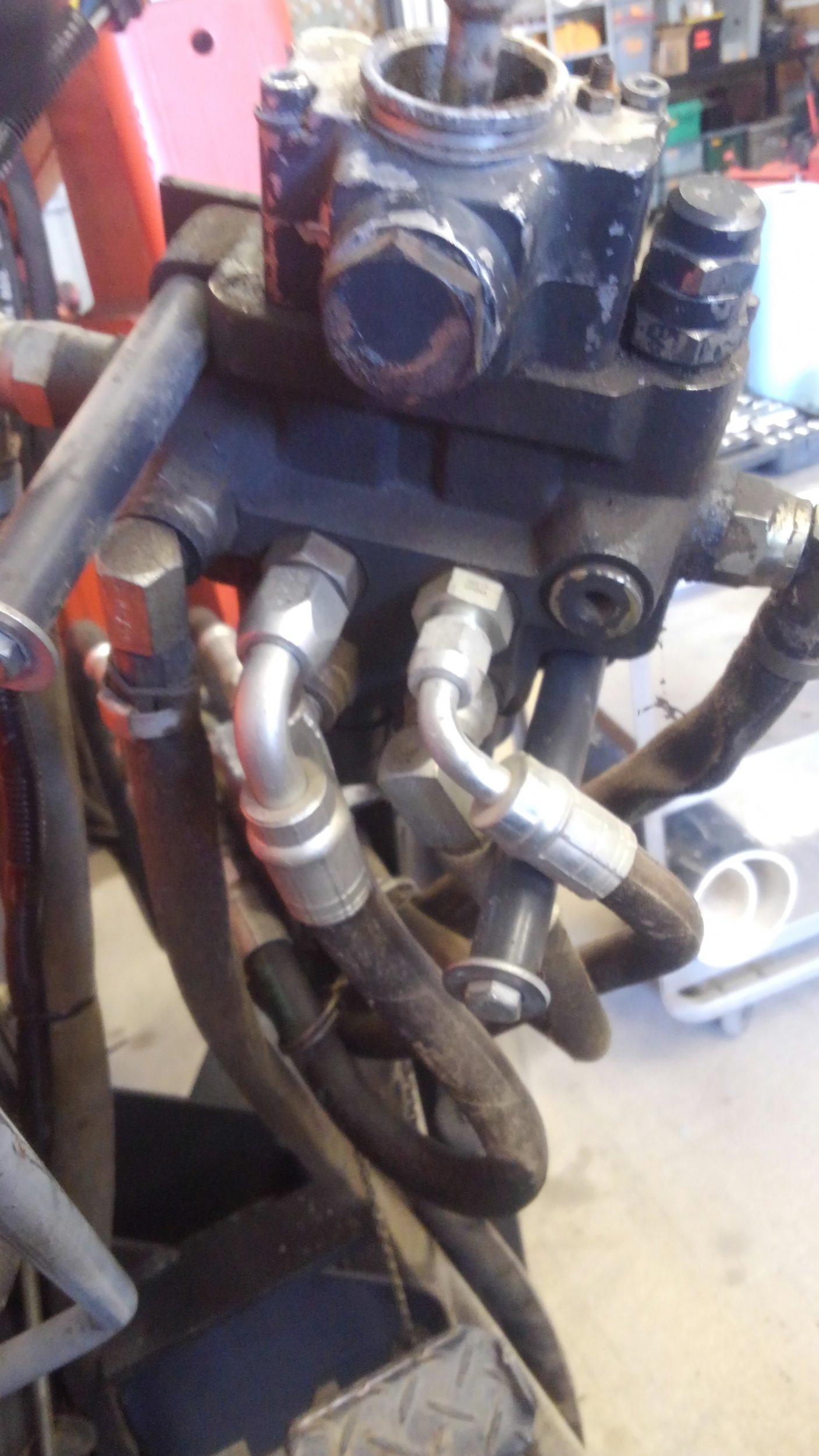

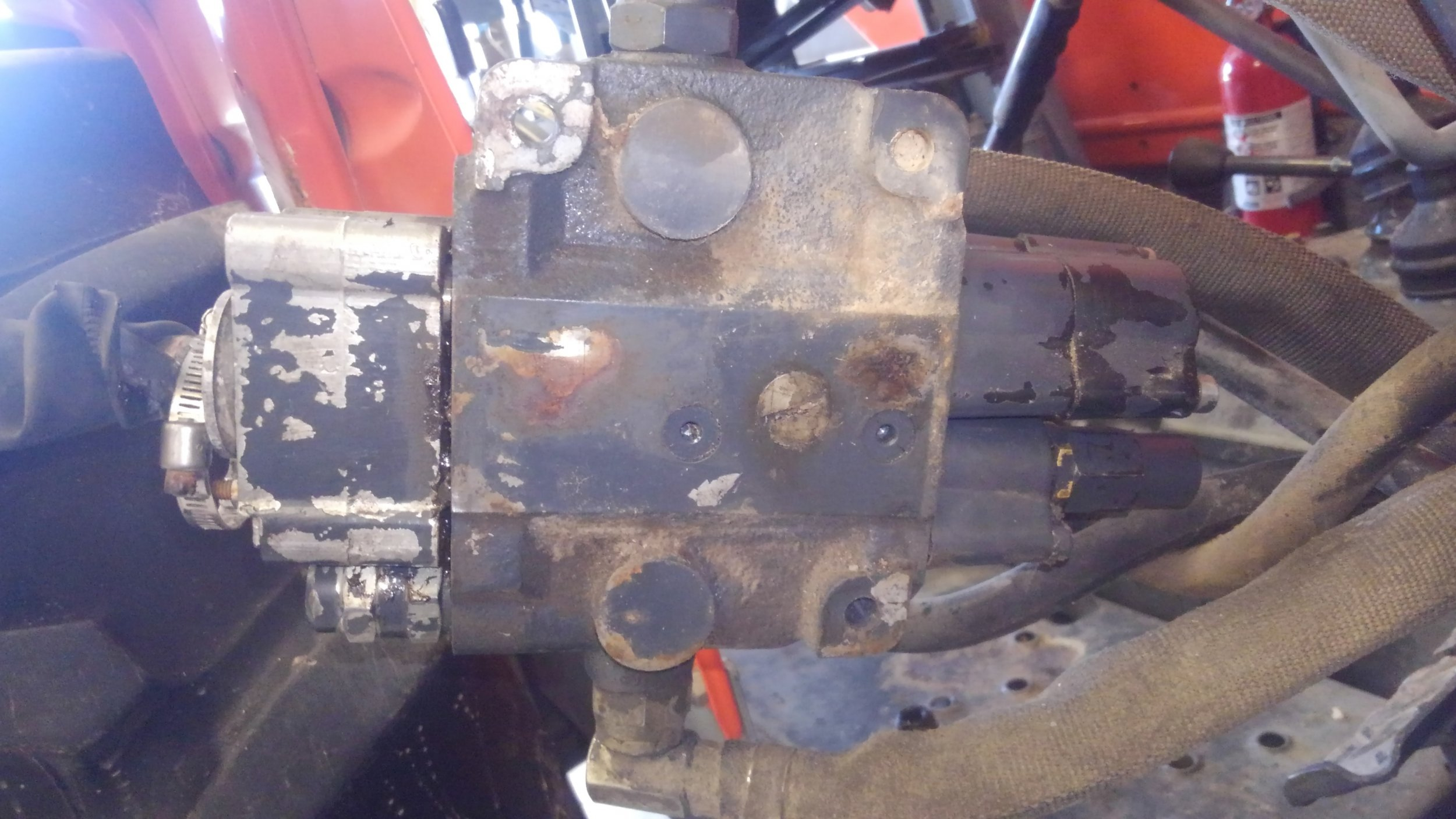

ptsg: I have the same diagram printed of in my packet of manuals for this tractor. My valve doesn't look like that valve, however. After blindly googling "hydraulic joystick valve" I came across one that looks very similar to mine, which pointed me to this youtube video ->
(Identifying Koyker Valve Series for Correct Repair Parts - Used on Tractors Less than 80HP by Short Line Parts, LLC) At the 3:44 mark is very similar to my valve. Mine has the same numbers and letters cast into it as the one in the video, but the back side of mine is slightly different, and there is an extra bit sticking out of one of the lower spool spring covers. I may have to get ahold of that company to see if they can help me further identify.
So, I think my valve is a Koyker Valve (I think they are made by Pace Manufacturing)
I have attached a few pictures of my valve (albeit poor quality pictures)
View attachment 698145View attachment 698146
I can't find much information on these. I'm not even sure where the check valve would be on this valve.

Aaah! That makes total sense now! Sportsman762's video helped tremendously. If the internal seals failed, there can't be any creep, as the actual rod would have to displace more or less fluid, which it cannot because of the valve. I always enjoy learning new things.
I do not think this is my problem, however. I swapped the bucket and arm functions on the loader as a test. After swapping, there was no drift in the arms, but the bucket would drift. I as able to slowly lift the arms as I would expect with minute movements. This tells me that it's the valve, and not the cylinders (unless I'm missing more hydraulic black magic that I don't know about)
I don't actually see a check valve on this valve body. So I called that company that had the video I posted above that was able to help me identify the type of valve I had. I explained my problem, and basically what I was told was to replace the entire valve, it's not worth rebuilding. Does this sound like the acceptable solution here? They said they have lots of experience with these valve bodies, and that most of the time they are just so worn out internally that a rebuild kit does very little. Wow.
Thoughts? My immediate thought is that I'm going to have to live with the drift for now, and buy a good quality replacement in a few months once the budget allows.
