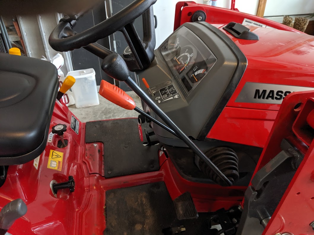

Old thread, but I'm with ya on that. I'm debating bending the arm, but then it would always be in the way when getting on the tractor from the right side. Wondering if anybody did an extension with a lock, one that is hinged at the end of the joystick, so that it folds down parallel to it when not in use. And when you use the loader, you flip it/back and lock it in place at a 45-90 deg angle to the joystick. That way I could just rest my arm on the arm rest while working the loader. Now that's luxury w/o having to upgrade to the 2019 GC with the fender joystick. Well, the research is on!

Weld or thread your extension onto the end and you'll be able to position it and fold it back like you want.
The loader knob is basically just glued on the stick. Tap the hole and you'll have a starting point to mount anything you'd imagine on the end to do what you need to.

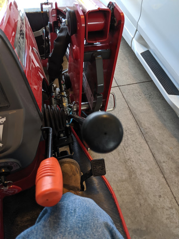

Ok, so a quick update to this. My plan was to carve a thread on the joystick and screw on an extension I could bend this or that way to fit my needs. The loader joystick rod matches a M14x2 thread, so I got a tap & die set off ebay, got a threaded rod and a couple coupler nuts also off ebay, and tapped a m14x2 thr. hole in a plastic knob I had laying around .
So yesterday was the day I was gonna mess with all that, and then my blowtorch caught my eye, and I though, hmm...
Was it smart to do it that way? Probably not. Did it work? Yes. I'm happy now.
