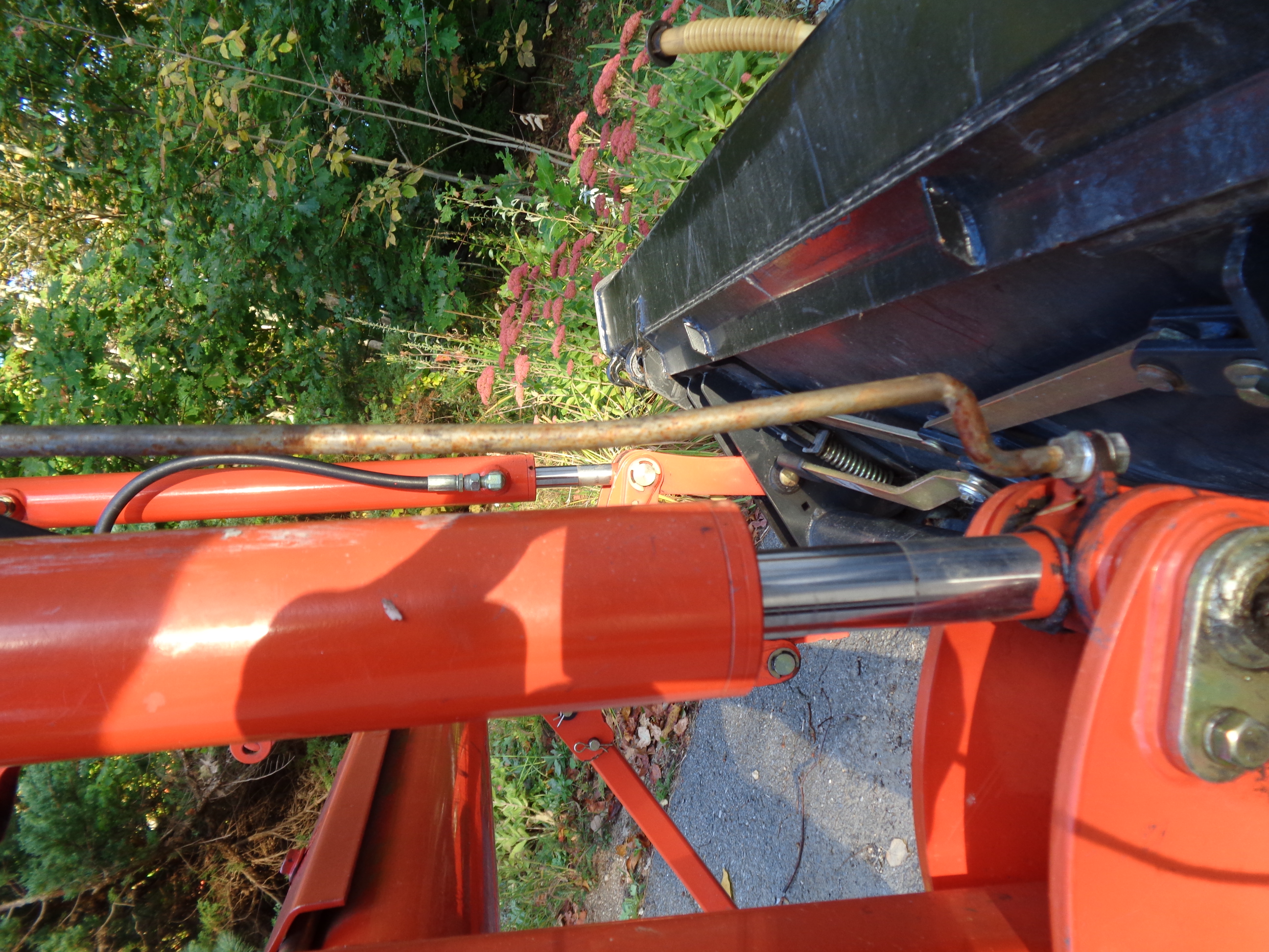

I made one for mine using a piece of 3/8's round stock. I put a double bend in the end, threaded it and installed it.
   / Loader level indicator? #12
I just put one on my 4110. I bought a 3/8 rod at tsc and welded a 3/8 bolt to the end, stuck the bolt through the bracket. add washer, lock washer and nut. The tube was on mine but I had to remove it to get the rod through. After it was on I retracted the cylinder and took a bar and bent the rod to align with the cylinder. the only expense was the cost of the rod.
