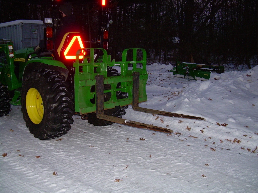

I have a set of pallet forks for my 200cx loader. I was thinking about buying/building a caryall for the 3pt hitch, but then it occurred to me: Why not build an adapter that would allow me to attach the forks to my imatch hitch. Then I can use the forks on the front or the back.

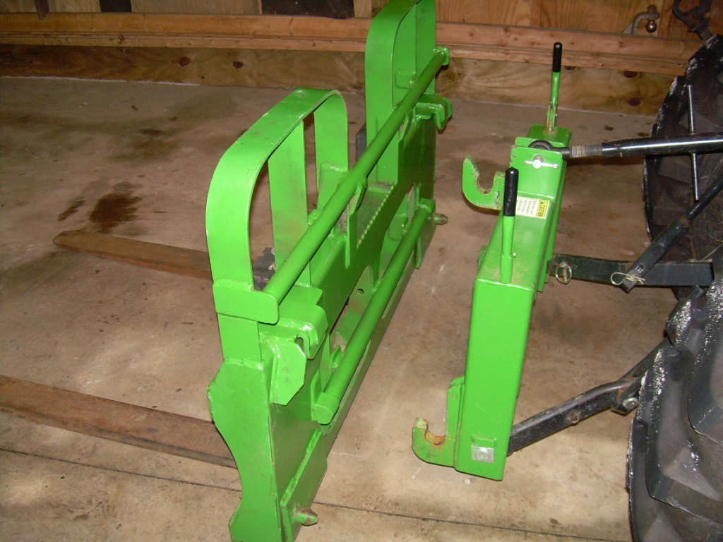

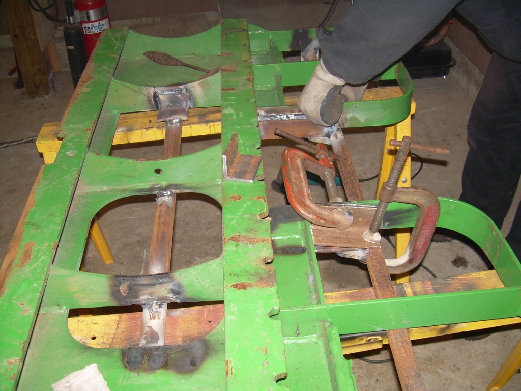

I didn't make an adaptor, I just welded 2 solid bars to my forks to adapt them to the i-match. I wished after that I did make an adaptor as I have not seen own yet and I think it would be a first.
Then you could not only put the forks on the i-match but also a bucket (don't know what you would do with it though?) also those 4-way snow plows everyone has on the loaders could be used on the i-match, that's something that might be practical as you could really do some heavy duty plowing with out the worry of doing damage to the front end loader.

Cool, thanks for the pictures JB4310! Good point about putting the bucket on the back -- why would I ever want to do that? This looks like a simpler solution!

Yea, I like newt's to, there's different ways to do it, with mine there was not a lot of engineering involved, I just did the simplest way I could think of, alot of extra bulk and welding but simple for sure.
I'm pretty sure the 3 pt will lift more than the loader on most of these CUTs, and for sure it is much easier to engage a pallet with the forks on the back, for me I have trouble with the forks on the loader, not seeing the forks and when you stand up to see, the tractor can't move due to the seat safety. Also I've spilled more than one pallet of material with jerky stick movements trying to level as it was lifted.
Of course the biggest drawback is the limited lift height of the 3 pt vs the FEL. Anywhere else that that's not an issue and I think the 3 pt mount is the way to go.
