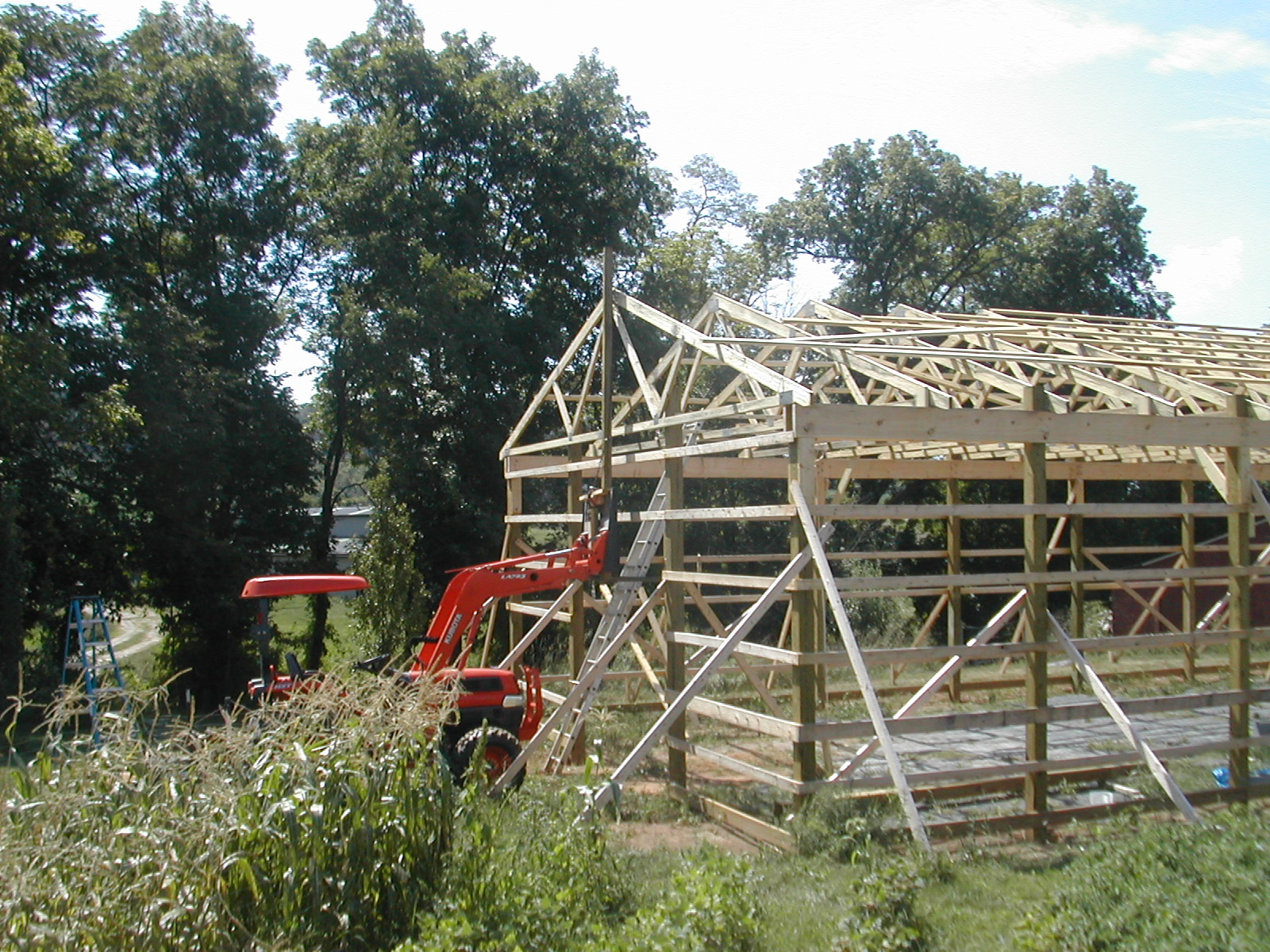

Has anyone made a boom pole mounted on a front loader bucket to lift things like roof trusses?
   / Loader mounted Boom pole #2
Yep - many here have. Suggest a search for "fel boom pole" Some built are dedicated FEL boom poles , and some attach to a bucket.. Maybe more builders will chime in.

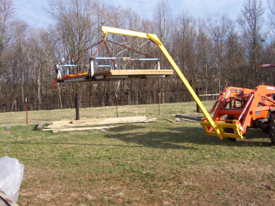

For the heck of it, here's mine: BobG in VA

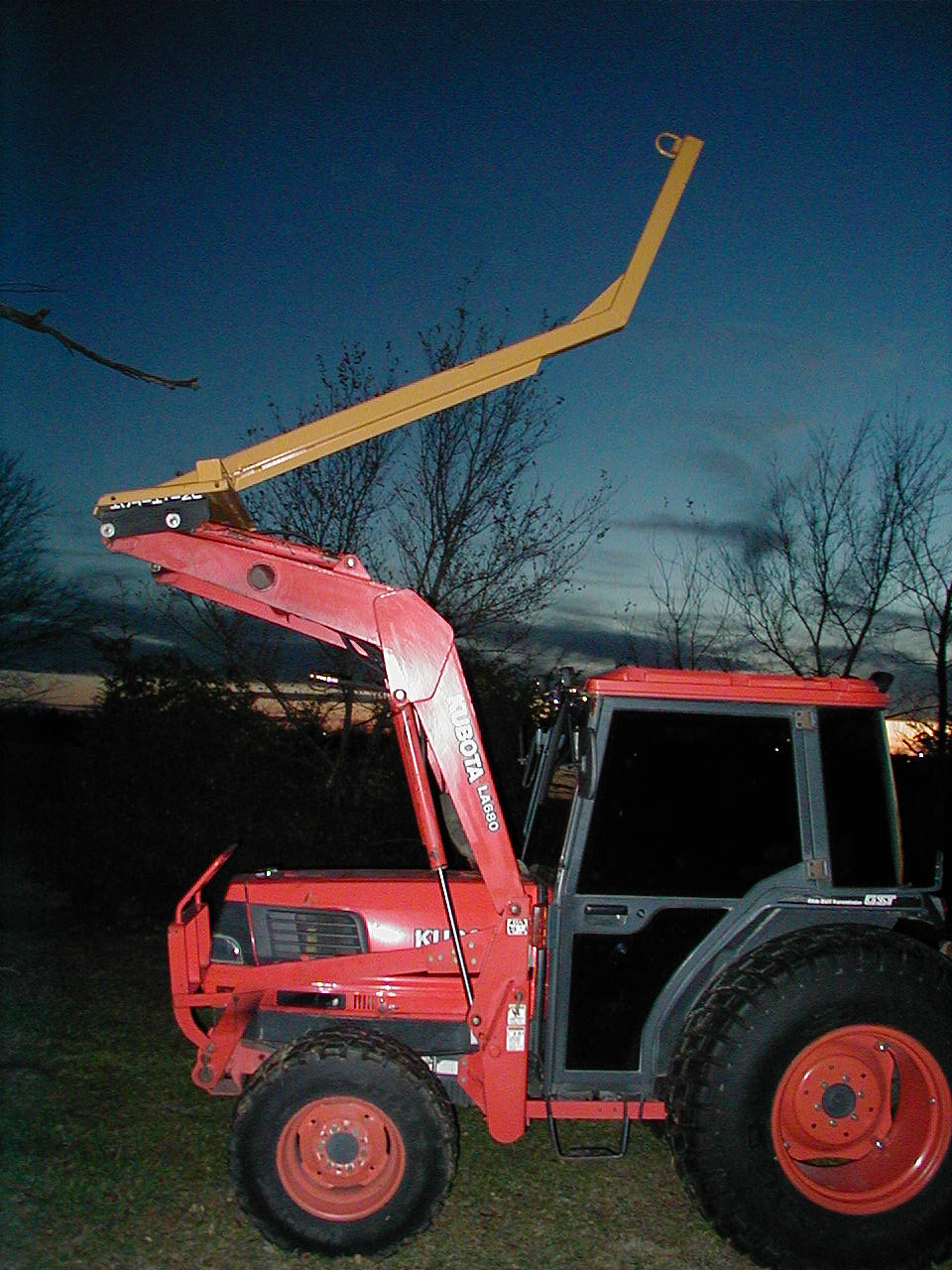

If you don't want to make one, you can buy them too. Millonzi makes one (photo) that attaches to a universal QA. I think I paid about $350 plus shipping. The boom is made of 2x2 square tube and there is no risk that my loader will overpower it.
