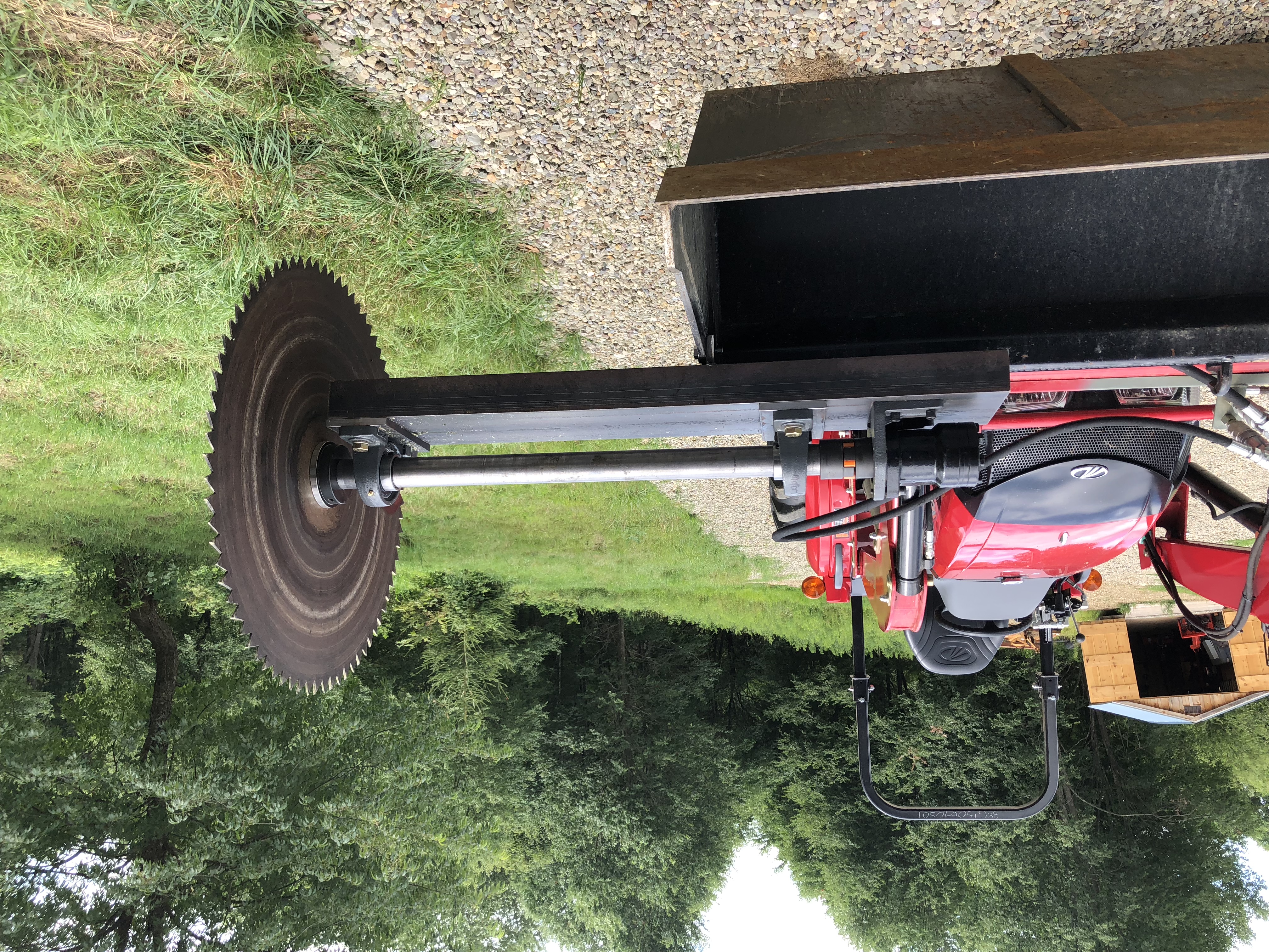

I built a loader mounted brush saw. Have a 900 driveway through woods. Wanted something to keep it trimmed back and to keep trails in woods open for tractor and Mule. Still have some guarding and braces to play with but I fired it up and did some cutting today. Trimmed stuff ranging from briars to tree limbs about 5 diameter. Worked quite well. Simple setup. Hydraulic motor, love joy coupling, couple pillow blocks, and a 30 blade. FB659888-C333-4BC0-B6C9-39669186A886.jpegC4D9B800-C518-4FB5-BDC5-545FC51C2E44.jpegBC0790B4-DB14-4087-B48A-1C9250F7D089.jpegFB659888-C333-4BC0-B6C9-39669186A886.jpegC4D9B800-C518-4FB5-BDC5-545FC51C2E44.jpegBC0790B4-DB14-4087-B48A-1C9250F7D089.jpeg

Did consider multiple blade setup. But that complicates things mechanically adding cost and weight. A 30 swath makes pretty quick work out of things. Looking forward to spending more time with it cleaning up around trees and field edges. Will make brush hogging much easier without having limbs in my face all the time:laughing:

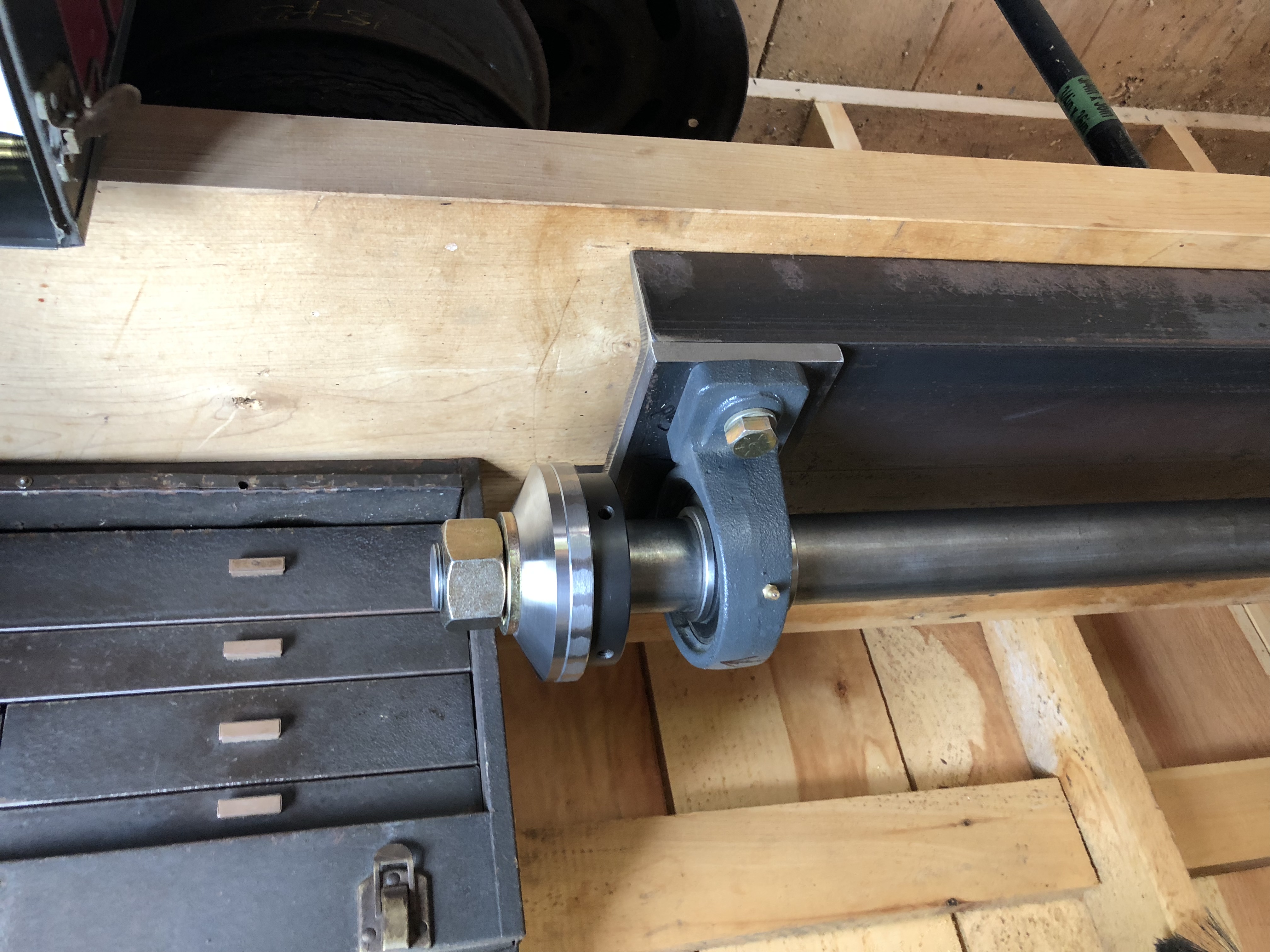

How did you mount the blade to the shaft?
   / Loader mounted brush saw
#11
Hopefully this photo will help. 2 shaft turned down to 1.375 to accept saw blade bore. Milled a key seat in the turned down portion and used a keyed chain sprocket with the teeth knocked off as a drive flange. Then a big custom washer under the nut to spread out the clamping forces C9A34A01-B743-4A95-B2C0-E8E42CD87CC5.jpeg

Hopefully this photo will help. 2 shaft turned down to 1.375 to accept saw blade bore. Milled a key seat in the turned down portion and used a keyed chain sprocket with the teeth knocked off as a drive flange. Then a big custom washer under the nut to spread out the clamping forces View attachment 590177
What rpm hydraulic motor are you using ?
Thanks
#13
Calculated RPM at my flow rate came out to just North of 700.

This hydraulic powered saw could easily be reoriented so the blade was parallel to the ground. You could hang it off your front bucket and raise and lower it with the loader valve to adjust the cut height. I could see that being useful too. For my application I needed a way to keep all of the brush and briars that constantly grow and and encroach on my driveway under control. Same for trails in woods. It’s worked well for me. And I know it’s scary looking but I honestly think it’s safer than other more manual methods since the blade is way out in front and to the side while you’re in the tractor seat. Just keep kids and pets away :shocked:

I thought that light stuff would get all wrapped up too but it doesn’t. I have a lot of that briar crap that grows up each spring and starts to spread out into driveway. It went through it like butter and cut it clean. I did take videos of it in action but don’t think you can post them here and I haven’t posted anything to YouTube in a long time.

If my math is right, at 700rpm, that 30” blade is turning at a rate of 1100 inches of cutting teeth per second.
I don’t know what OP’s hydraulic flow rate is, but I bet that motor is developing at least 5hp. I bet that blade will go through a 4” tree limb in about 2 seconds without even slowing down.
#19
Exactly! When I designed it I calculated 66,000 inches per minute. Which happens to be the same as 1100 inches per second. I liked the IPM number because it’s bigger and sounds more impressive :laughing: but yes it’s theoretically about 6 HP if I remember all my original design details based on flow and pressure when I speced the motor. And I have cut some pretty big stuff with it no problem.
