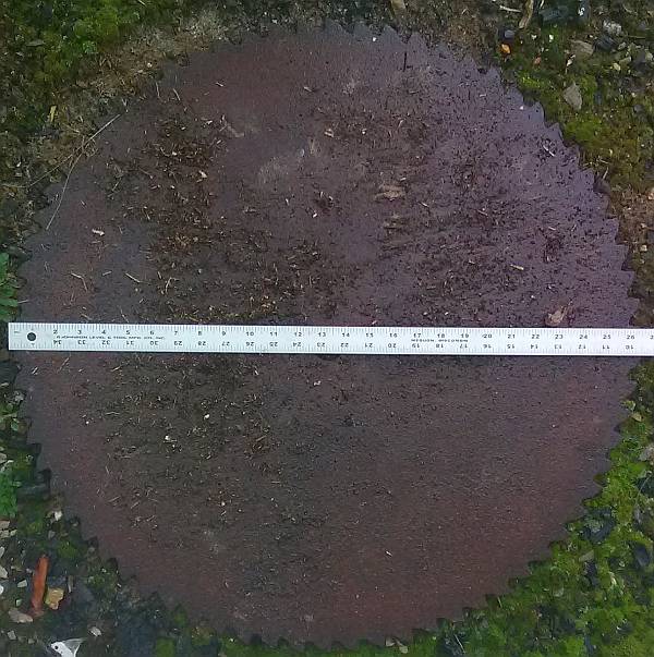

It's dirty, icky, rusty, dull, only 26" and has been outside for at least 30 years, but I gots me one. Came with the house. I use it as a base for a manual slide hammer wood splitter.
