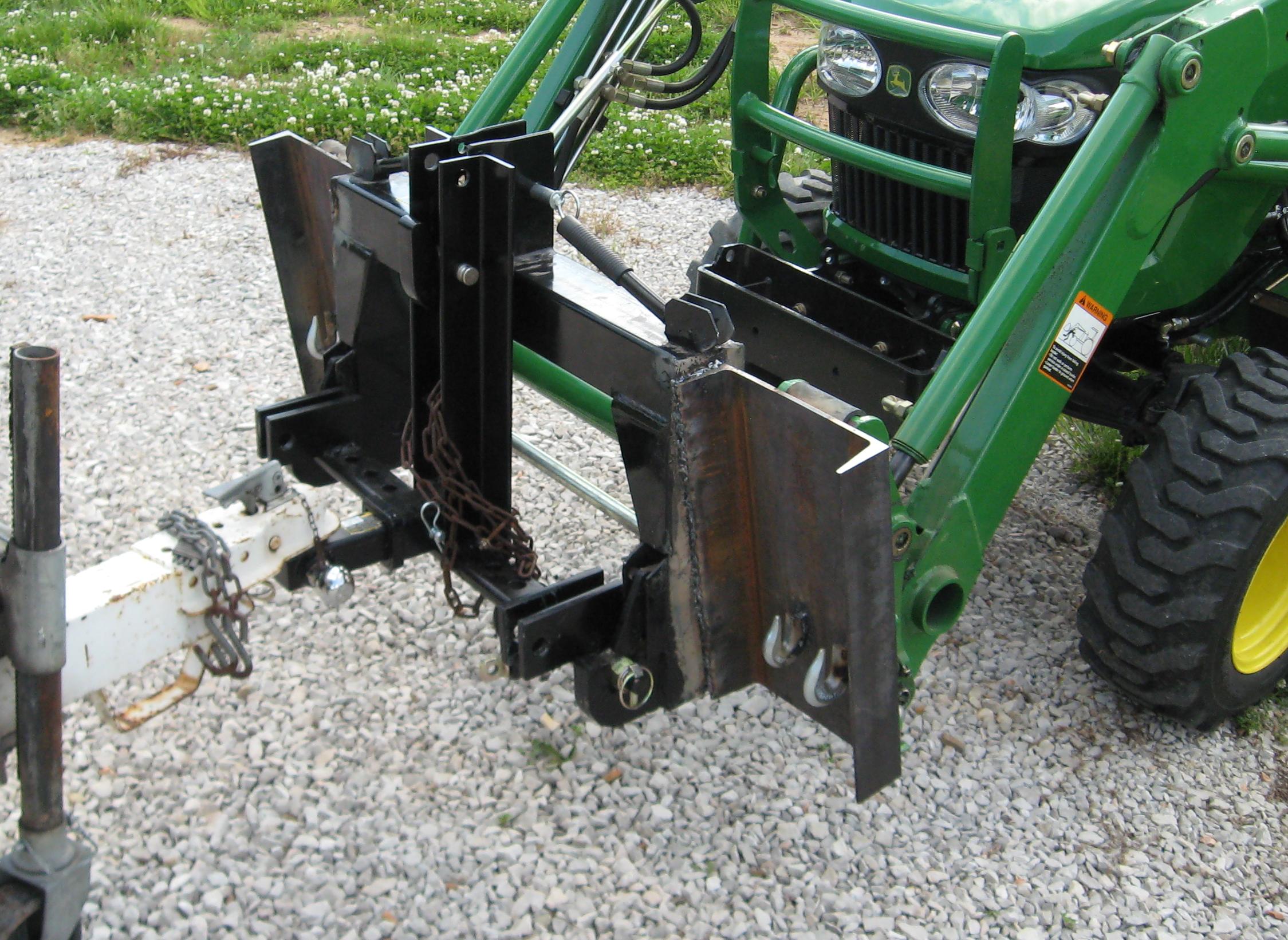

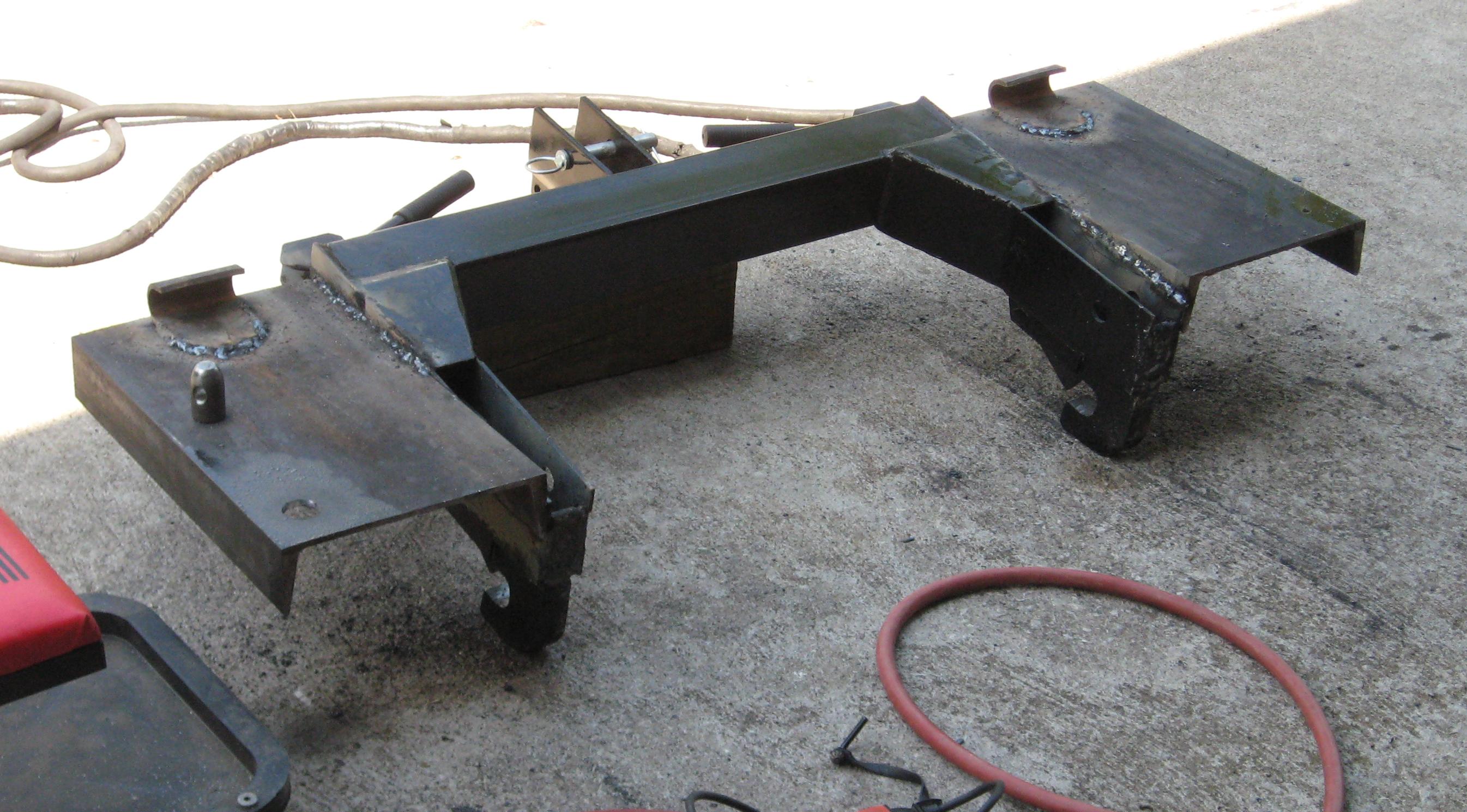

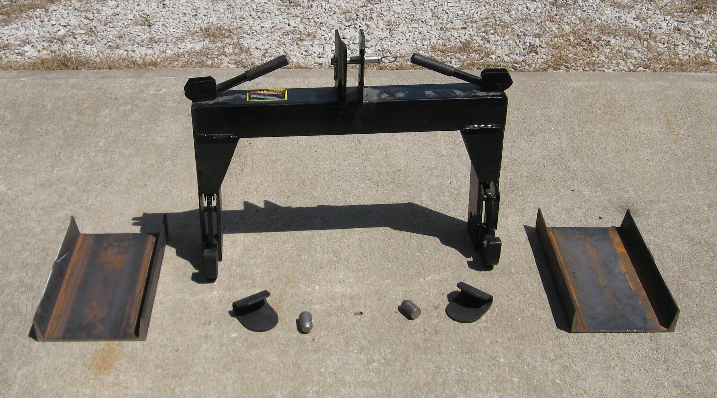

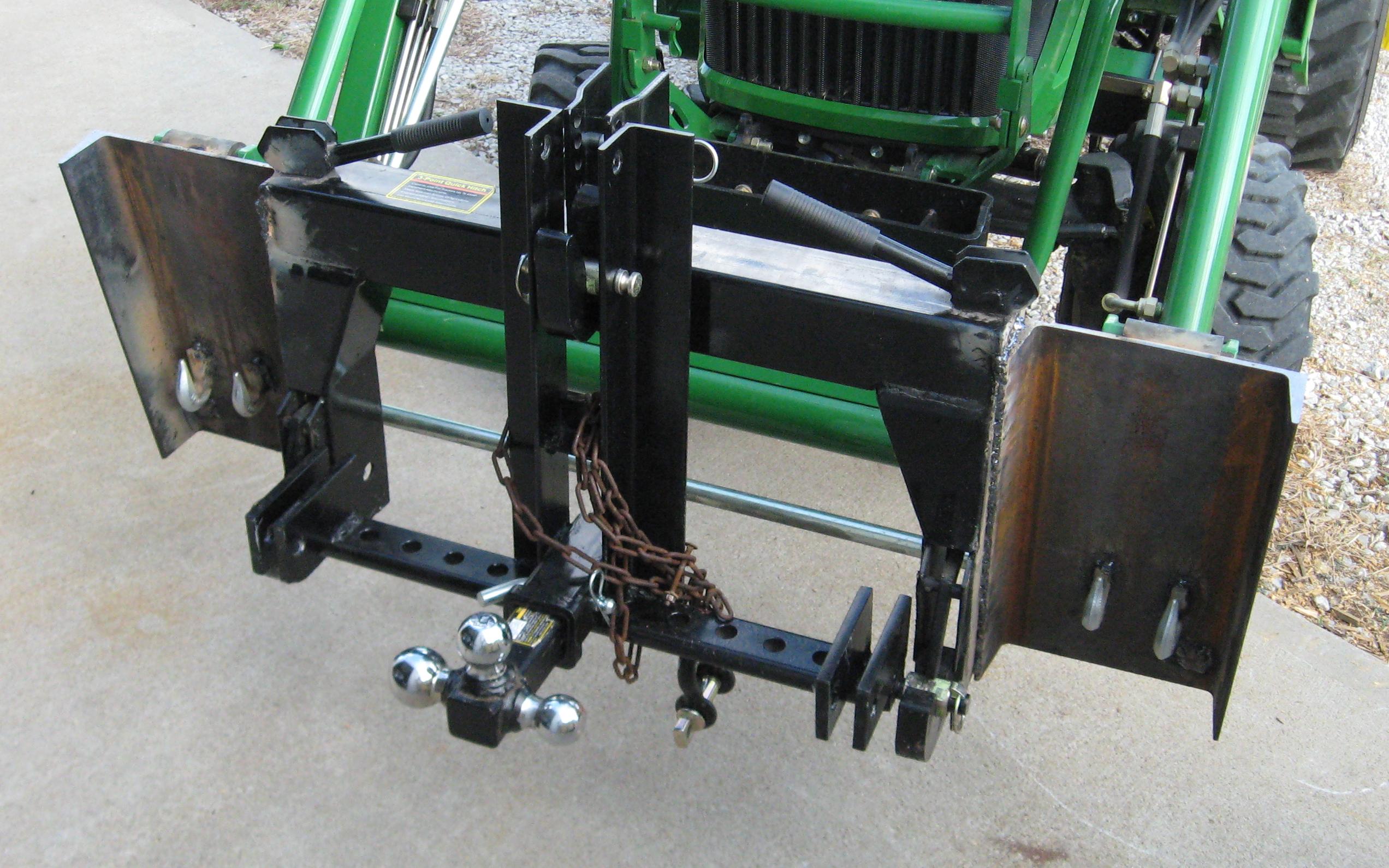

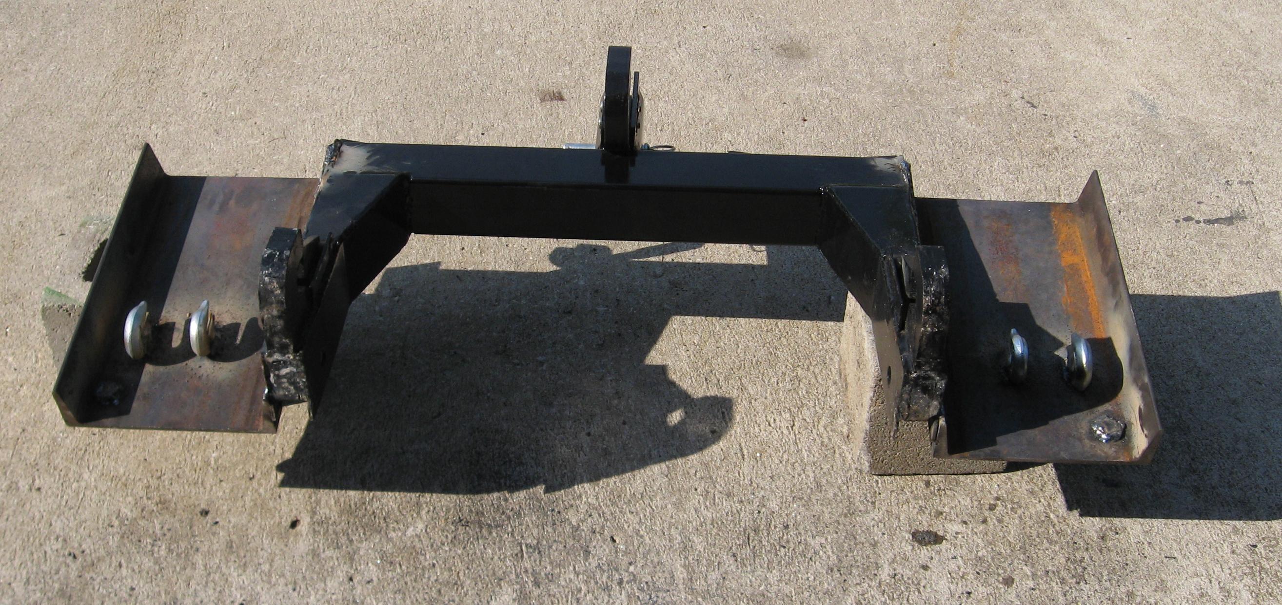

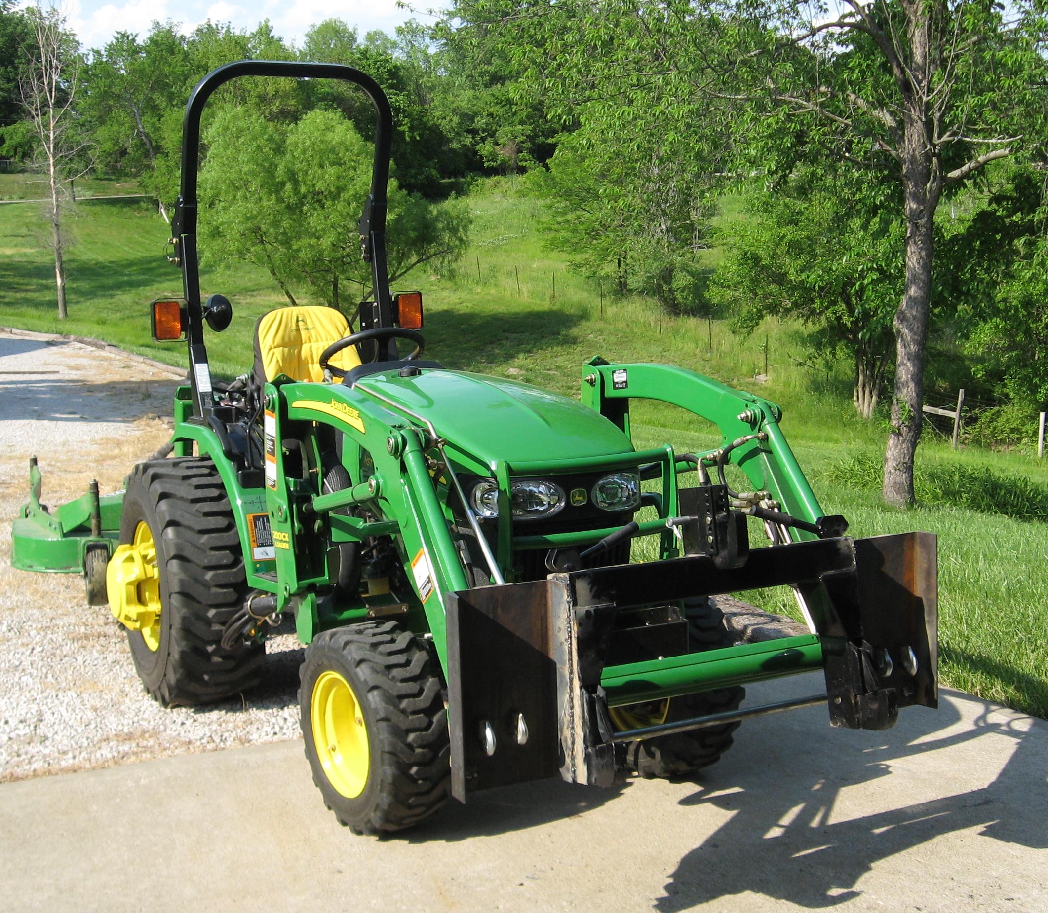

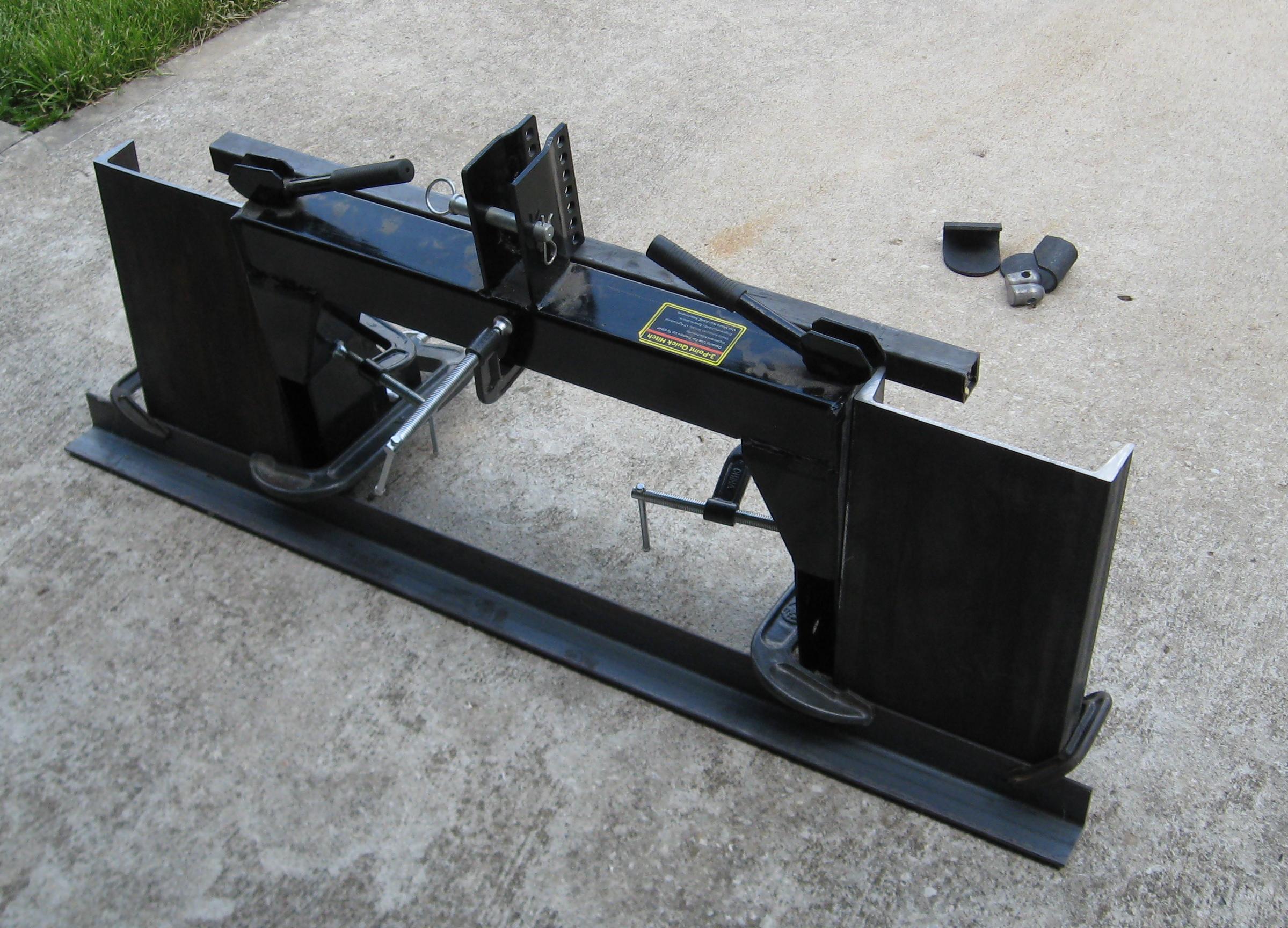

I put together a quick-attach loader mounted quick hitch for my JD 2520 with 200CX loader this afternoon. Parts needed were a Harbor Freight quick hitch, two 10 inch wide by 17 inch long pieces of channel iron and the quiick attach loader hooks and pins available from John Deere.

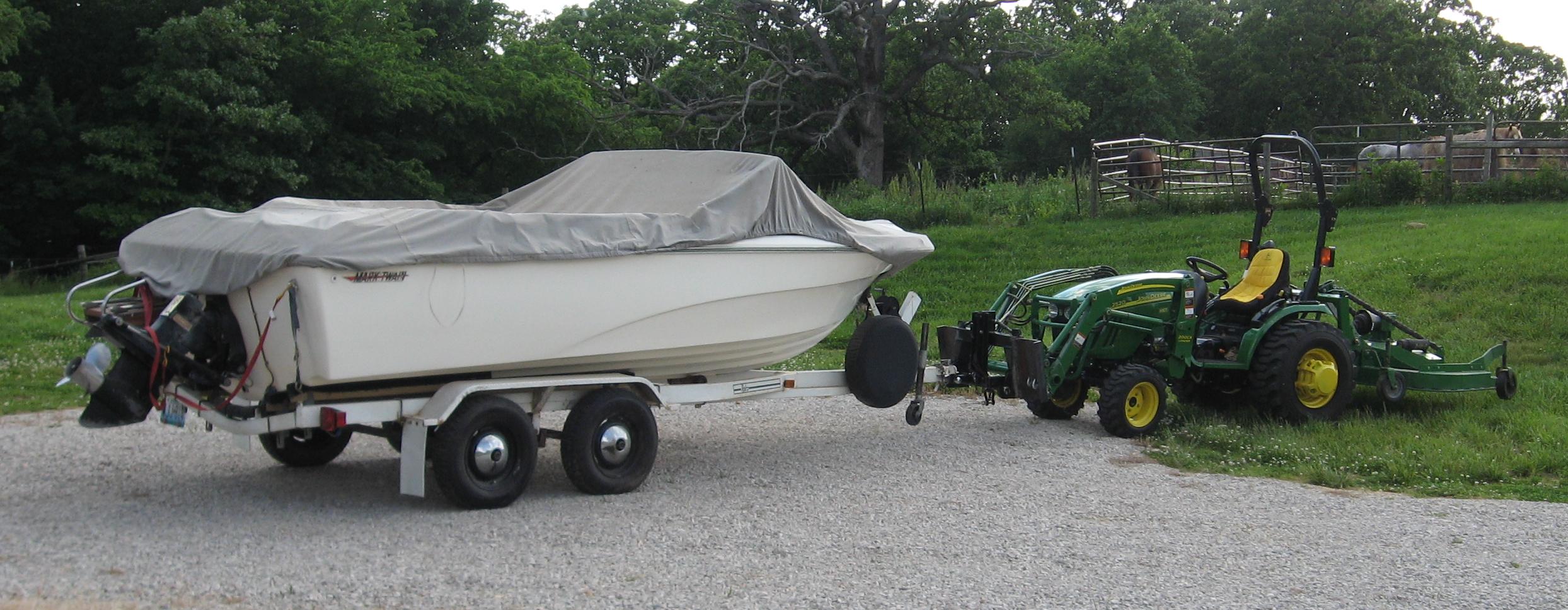

Pictures show the channel iron clamped to the quick hitch for welding, the hooks and pins being attached, some chain hooks added and the unit being tested lifting my box blade and using my quick hitch mounted trailer hitch.

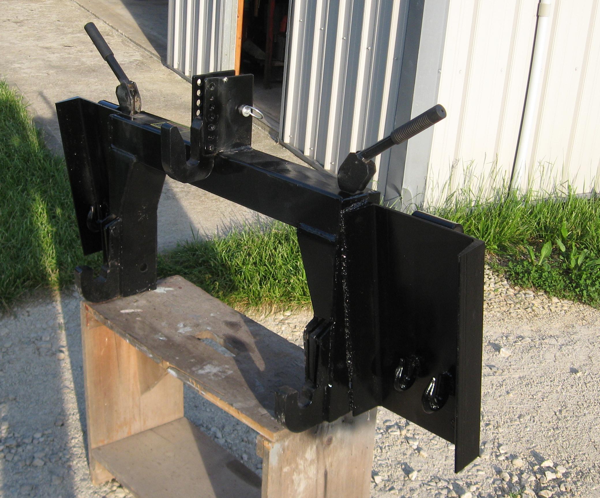

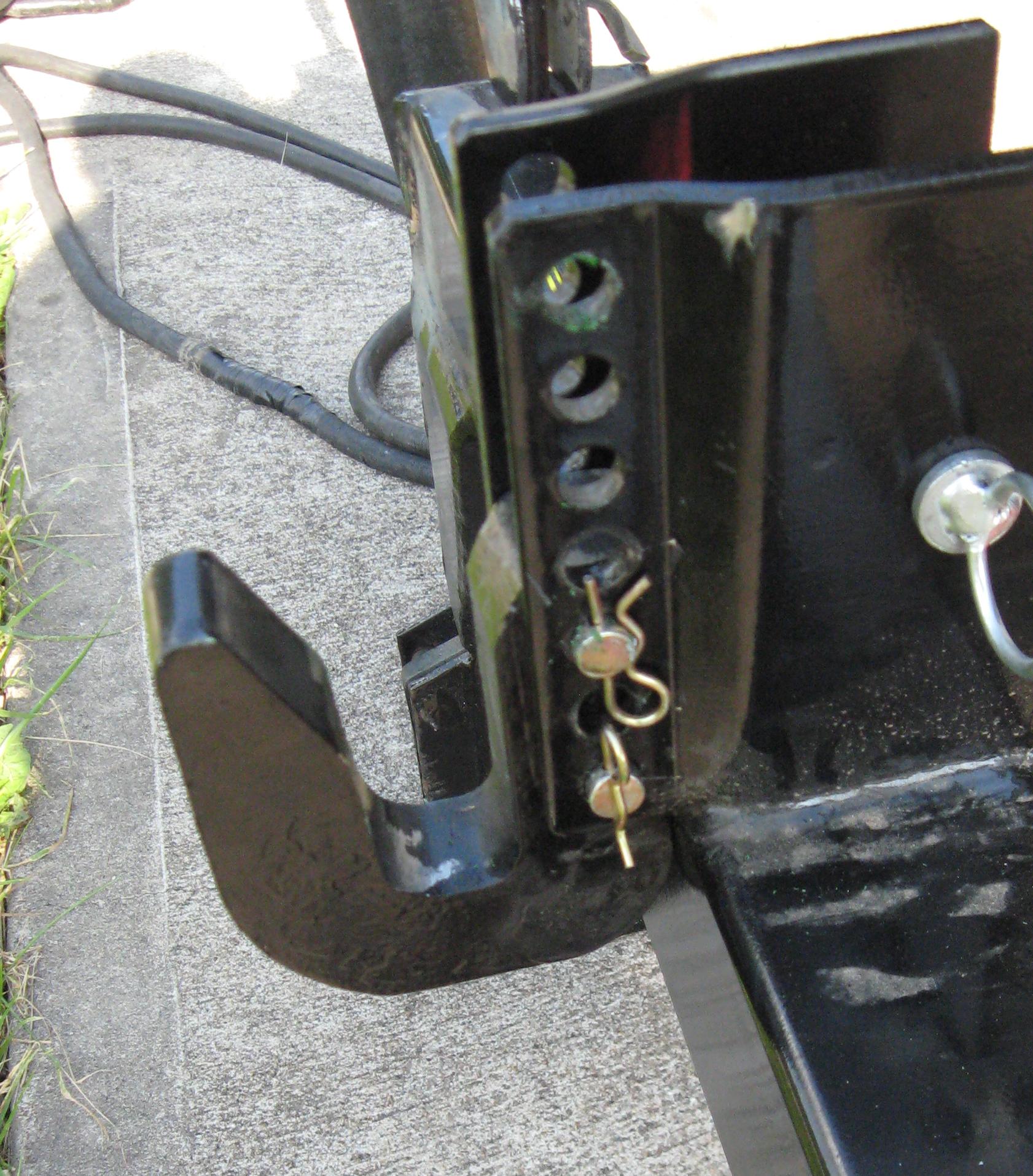

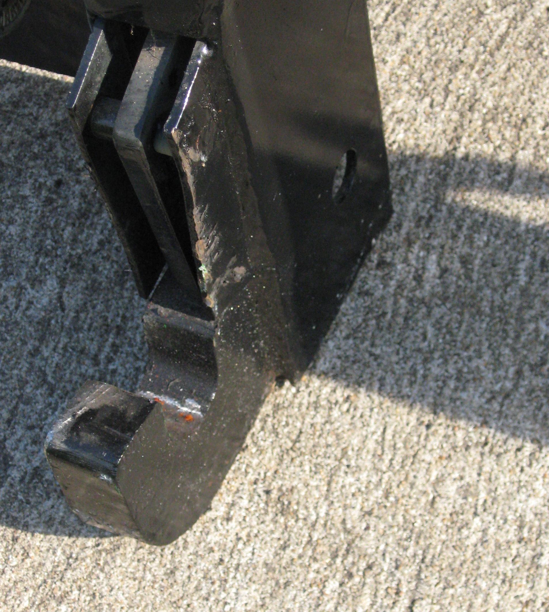

Lastly, some problem areas are shown. Mainly, the top hook, which is intended to be adjustable and is supplied with bolts from HF. However, the bolt heads and nuts are too big and get in the way of all of my attachments, so I cut the bolt heads off and tack welded the remainder of the bolt into the holes. The second problem area was the hinges for the latches at the lower hooks. These were spread too wide and got in the way of the attaching points on my attachments, so a slight adjustment with a hammer corrected the problem.
This project wasn't too bad, and the hardest part was creating the holes for the JD pins to go through for the mounting points. The step drill wouldn't do it, so I had to resort to opening the holes up with an air powered die grinder with a carbide bur tip.

Well done!!:cool: That will definitely be handy around the place. I can see lots of uses to use a QH on the loader. Nicely executed too.
There is one thing that would be problem for me and that is the sharp pointed corners on the outside of the channel--on that I would bang my knees, snag my pants or shirt, or dent my poor bald head. I think that I would have rounded those corners off--you would not loose any strength and might save a dent or two. :rolleyes:

As for the sharp corners, that concerns me to. I also thought about whether or not the channel iron has enough rigidity to handle the torsional forces of picking up and curling something heavy like my mower.
I thought about killing both birds with one stone by welding a pice of bar stock across the ends of the channel. That would basically create a box and would help eliminate some of the sharp corners. I could also just round them off with a grinder or cut them at 45 degress with the band saw too.
However, I decided to try it like this for awhile (until I hit my knee on it...) and see how it works.
As an aside, it took quite a bit of work to make the HF quick hitch work with all the stuff that my regular iMatch works with. I had to open up the hooks with a die grinder because they are only Cat I but the iMatch is Cat II and I didn't want to have to remove the bushings on my attachments every time I wanted to move one around.
Also, as mentioned, it took some "adjusting" to get the upper hook area to fit places the iMatch already fits and to get the lower latch mechanism out of the way.
I could have just bought an iMatch for this and kind of wish I would have, however, the HF hitch was cheap, about $65 and all total I've only got about $200 in the completed unit.

I did the same thing this Spring. I just welded a Q/A plate to the easy hitch.
I use it all the time for moving stuff around the yard, and I even use it to do some road work when I attach my landscape rake this setup. It's so much easier to use the landscape rake looking foward, instead of looking over my shoulder. I also feel I have more control over the lanscape rake when I have it attached to the loader arms.
I'm surprised more people haven't done this.

I just bought the JD Hooks, gussets and pins for a snow plow project I am doing for my FEL. I paid JD over $70 for these 6 QD items. Not sure how you got those hooks for that money??
FWIW.....I would put gusset straps on the hooks like JD does. (see a JD bucket) I had a grapple on my loader that did not employ the strap re-enforcements......and it cost me some down-time and broken parts / repairs to my loader and grapple. Beware.
I can see using your set up for a trailer mover or a light duty landscape rake.....maybe a few other implements. But too much force on your loader arms may make for some bent loader issues IMO.

"FWIW.....I would put gusset straps on the hooks like JD does. "
That is excellent advice. I've been planning on doing it, but just haven't gotten around to it yet...
