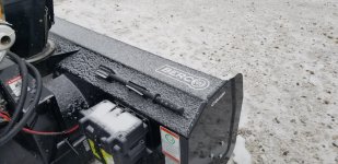

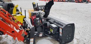

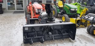

Saw this the other day at the dealership. Wonder how well it performs versus a pto powered snowblower.

The ones for quads seem to work ok from what I see on the tube. Specs are 25 hp for the 72 inch. At about 10k CDN, it's pricey.
/ Loader mounted snowblower #3
I looked at getting one. Cost killed it for me. My pull blower was $4000
The FEL mounted blower should be easier to use and great for attacking mounds and drifts of snow.
Another downside is the relatively low HP. Having another engine to deal with is a negative.
Yeah the h.p. seemed low to me and just about all the driveways in town here are gravel so for the time being I'm just using the loader and maybe my box scraper I just have to get some shoes made up for it to prevent it from digging in.
/ Loader mounted snowblower #5
Without seeing it up close, it looks like the bottom of the SSQA plate needs to be quite low to get the blower level. Seems like it could be a bit troublesome to have the curl/dump adjusted. especially on uneven terrain. Do you need to have the FEL in the float position? That's a lot of weight on the blower.
/ Loader mounted snowblower #6
It would no doubt be slower than a rear mounted PTO blower. The key to snowblower speed is the impeller size and that one looks pretty small due to it being sized for a small engine. With the smallest PTO snowblowers you should be looking at a 18-20" impeller diameter and an impeller depth of at least 8". The impeller diameter dictates how far it will throw the snow and the impeller depth dictates how much volume it can handle, thus how fast you can go.

I like the setup on the JD in the 3rd pic better. Doesn't stick out so far and uses a PTO (I assume). I have 1/3 mile of gravel so I'm sticking with the quad mount 50" plow, rear blade and FEL. And occasional help from the neighbor w/7' plow on his old Dodge.
