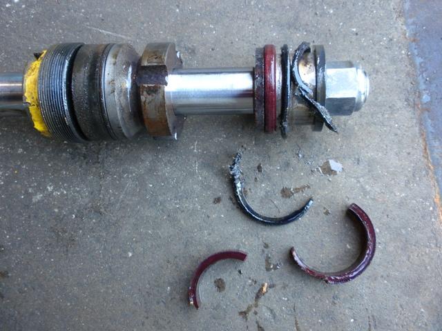

My loader won't lift it but otherwise seems okay. Is this a problem with the pump or is it just that some machines wont do it? Thanks
VT Sasq,
Some older tractors (J/D and Ford) cyls have double acting cylinders but have one set of "V Packings" on tilt and lift cyls......the packings will hold a pressure tight load only in one direction....
They install the tilt cyl packings so that they will hold a "Pull" load and they install the lift cyl packings the other way for a "Push" load....Same packings just installed in reverse.....
It's possible MF used the same setup but impossible to tell from the outside of the cyl....you'd need a parts breakdown to tell.....Maybe someone here has the exploded breakdown of your cyls......
Here's a pic of cyl from a Ford 3500 Tilt cyl......(Obviously this cyl packing set was blown which I'm sure yours is not....otherwise it would not work at all)
