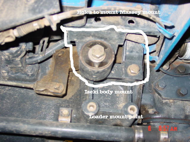

This is the first step. Remove the Iseki body mount .

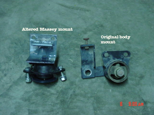

These are the Iseki and Massey mounts. I have added a lip for the sheet metal of the body to set on. Massey has bolts backwelded to attach to. I made a plate with the nuts attached to make it possible to use the holes in the body. I couldn't get a wrench in to hold them.

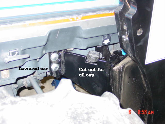

This is the mount with the alterations made. I cut a slot for the oil cap and cut and lowered the front ear.

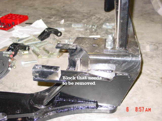

The block had to be cut off and the ear cut off. The ear was then welded back on an 1" lower and the holes had to be opened up to match the frame holes. Almost all the holes had to be opened some to fit. I had to mount it up using what holes would fit and them mark the out of line holes. I pulled the mount off and corrected the holes and welded the front ear back.

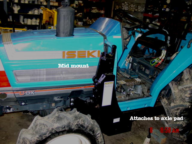

This is the mid mount on the tractor. The spacing is critical. There is a bar that goes between the mounts under the belly. If it will fit the loader will.
