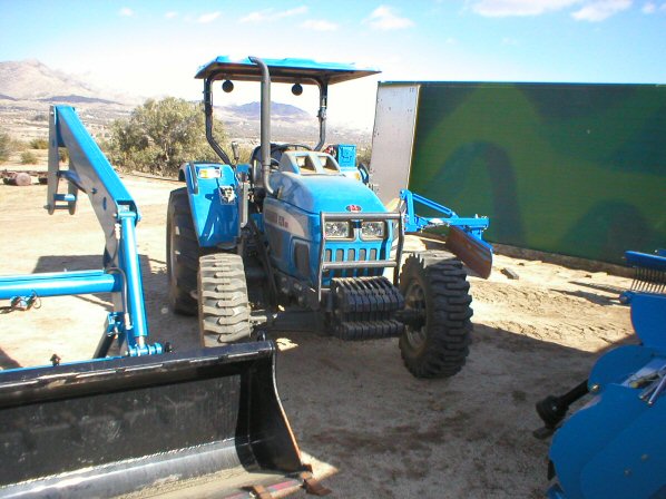

For me, a loader is great to have on when you are mowing the unknown, but after you have done it once then it is just that much more that is bouncing and rattling around. Much nicer when it is off in my opinion. Oh, I put front weights on when the loader is off.;)
Do your weight hang on the loader frame or do you take off the loader totally and hang them on the front of the tractor?
   / Loader quick attach adapter for 2415 - is it worth it #12
Remove loader assembly and hang weights on front of tractor.
