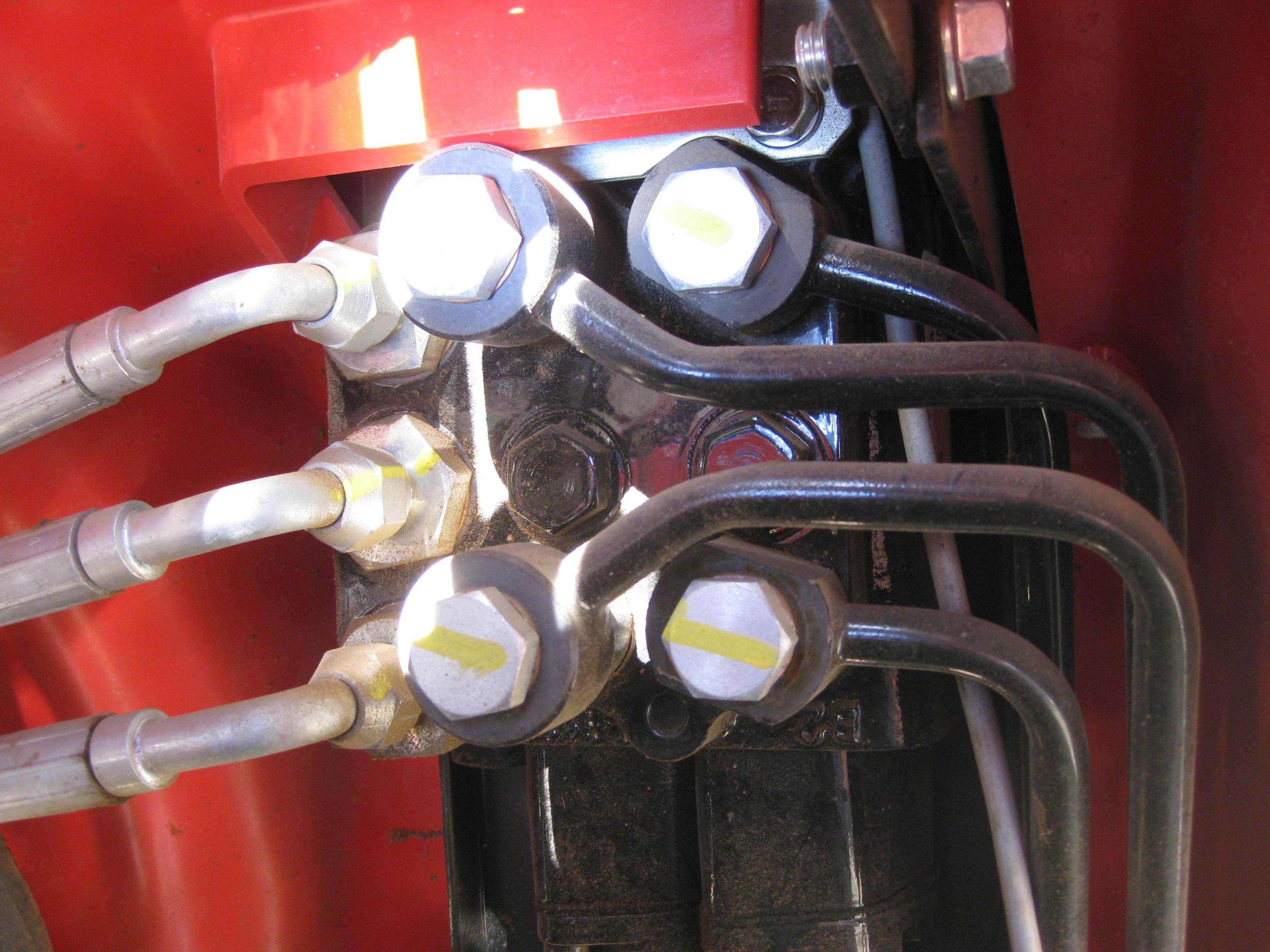

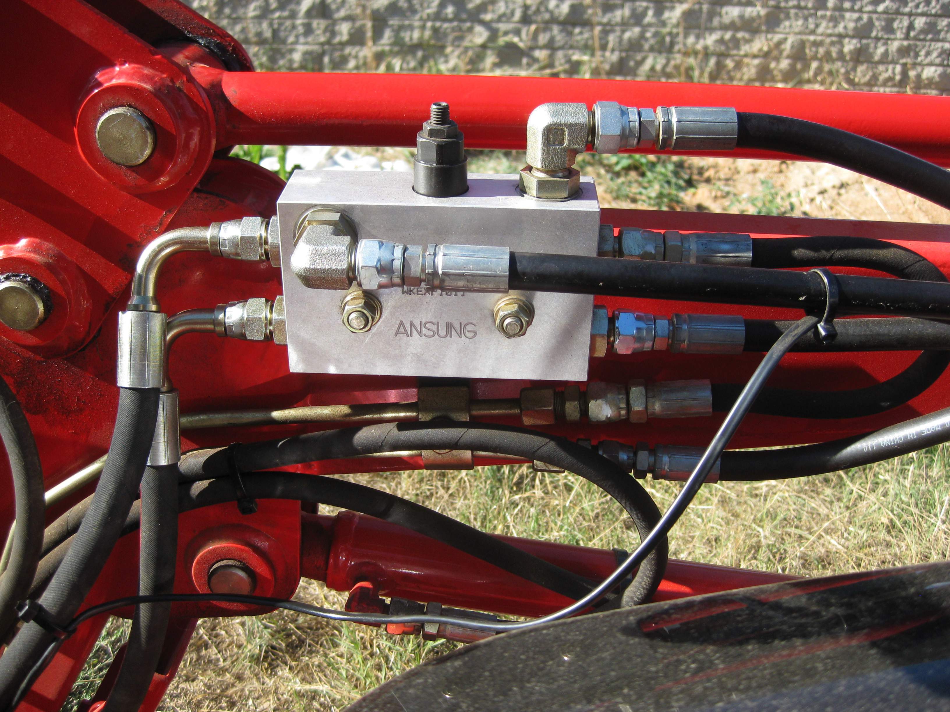

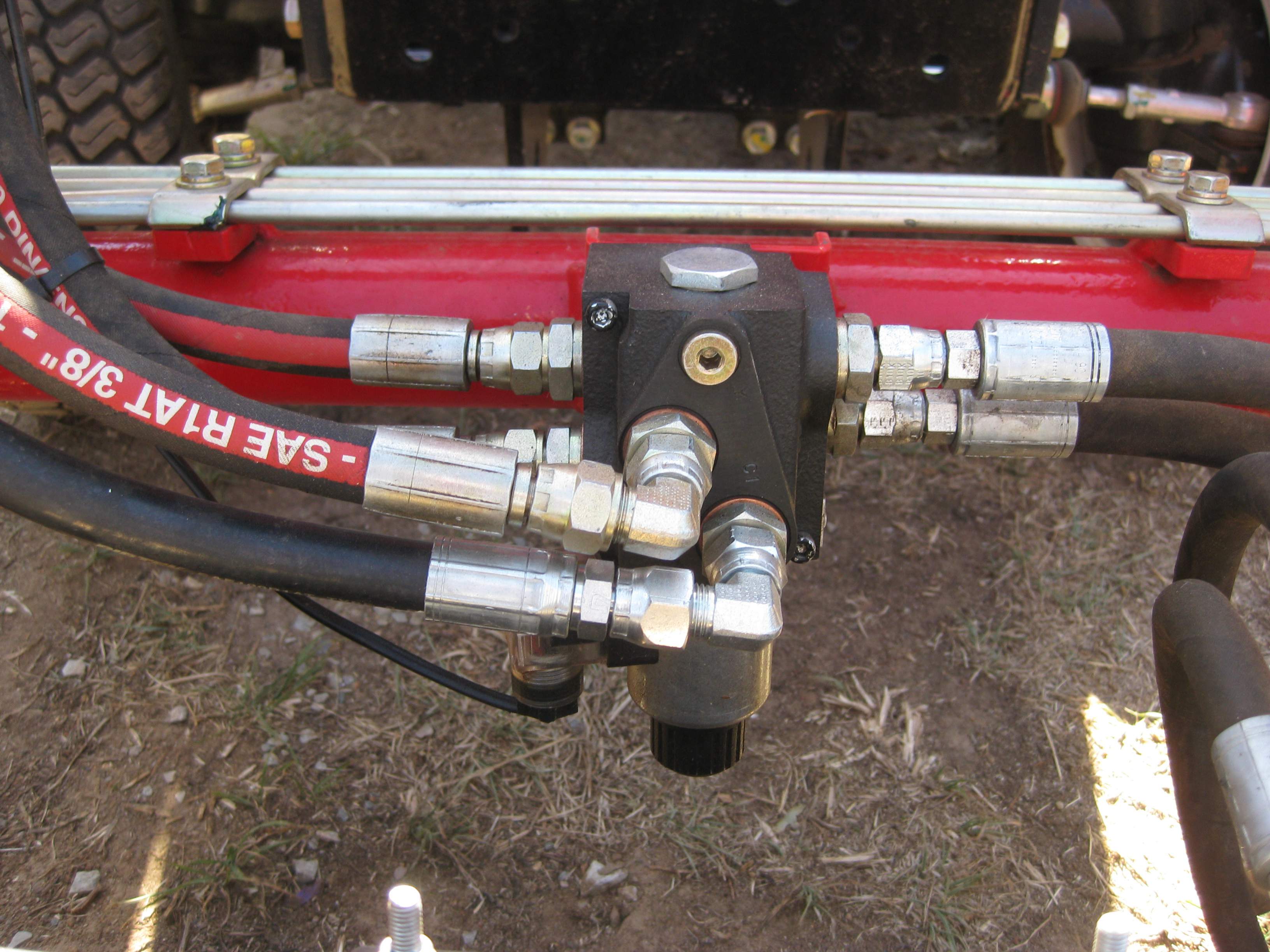

Yes - In between the FEL valve and the diverter valve, there is an aluminium "block" into which 3 of the 4 FEL hoses lead into and out from. The markings on the block for the hose connections are T1 - a paired connection for the bucket curl hose, T2 a paired connection for the loader lift, A for the in hose for the bucket dump and A1 for the out hose for the bucket dump. The FEL drop hose bypasses the block.
The T1 out hose for the bucket curl and the A1 hose for the bucket dump leads to the diverter valve as per your link - the diverter valve switches the bucket curl to bucket open and the bucket dump to bucket close when you press the button on top of the joystick of the FEL valve. The block has a relief valve which seems to only operate for the bucket dump/close function (the A1 outlet).
I don't know the purpose of the block other than for allowing the pressure to be adjusted for the bucket dump/close function. It's a mystery to me as to the purpose of the T1 and T2 connections - why does the FEL lift hose and bucket curl/open hoses go through this block - why can't these hoses bypass this block altogether the same way as the FEL lowering hose.

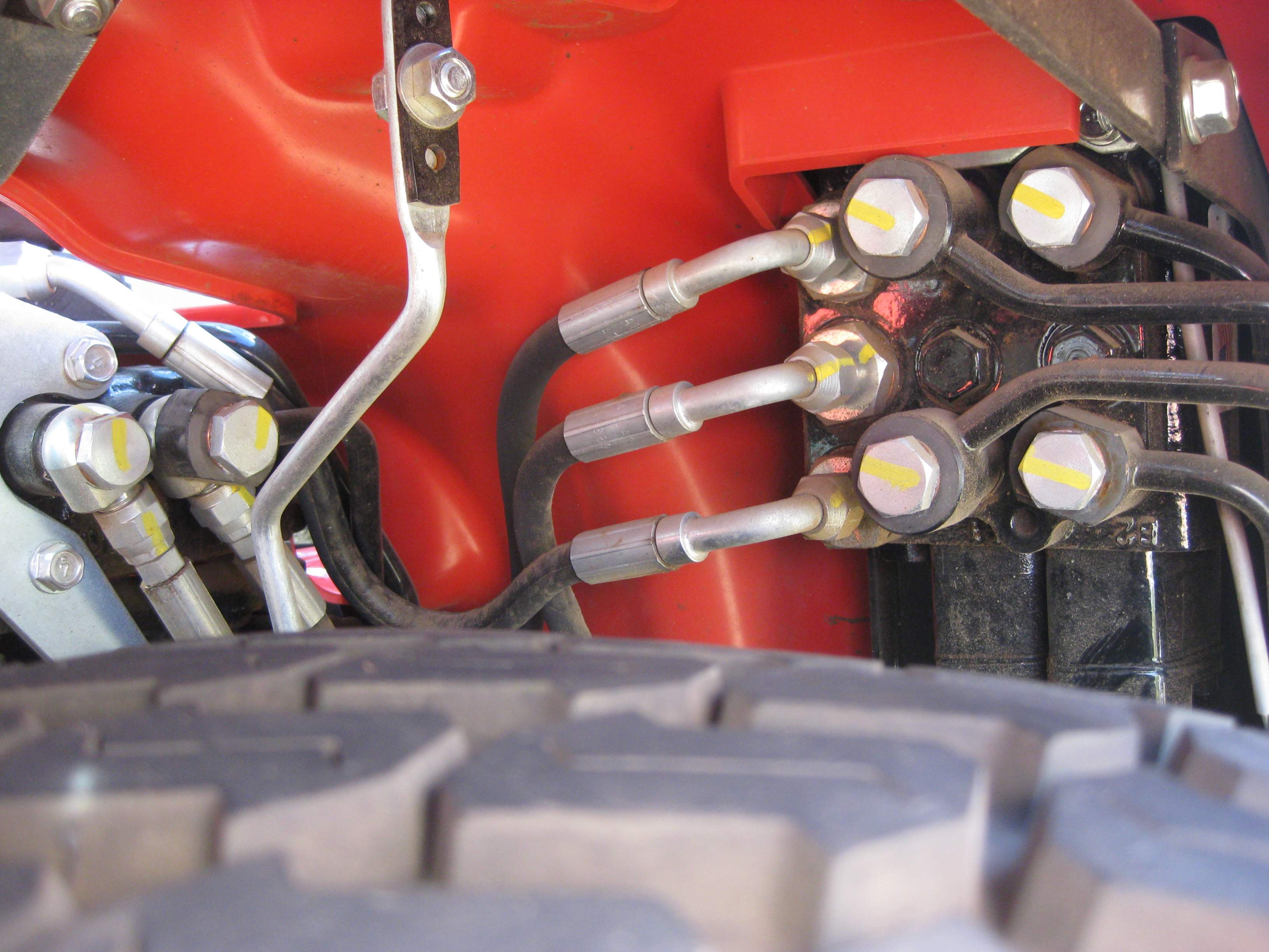

Pictures attached comprise of 1208) my tractor, 1209) FEL valve, 1218) the pump connection to the FEL valve (is that the correct terminology/understanding?), 1219) the mysterious "block" and 1212) the diverter valve.
John

J.J.
I have a joystick to operate the FEL valve which sits on top of the valve (4th picture). The joystick operates the FEL raise and lower and the bucket dump and curl. The joystick also has a button on top which when pressed activates the electric diverter valve which opens and closes the 4 in 1 bucket in lieu of curling and dumping the bucket.
The FEL valve has 7 ports - I imagine one from the pump, one for power beyond to operate the 3 pt linkage, one to tank, and 4 to operate the working functions of the FEL. Of the 4 FEL hoses, one goes directly to the side of the cylinder to lower the FEL. The other 3 hoses (FEL raise, bucket dump and curl) leads to this mysterious block attached to the loader arm - the 2nd picture. The one with the valve on top that adjusts the pressure for the bucket dump only, I think.
From the mysterious block, one hose leads out to the side of the cylinder to raise the FEL. Another 2 hoses controlling the bucket functions lead out to the electric diverter valve (1st picture). I think I understand the operation of the diverter valve - electric current off means joystick will dump/curl bucket; electric current on means joystick will open/close bucket.
It's the function of the mysterious block that's located on the loader arm that I'm puzzled about, other than it has a valve that adjusts the pressure for the bucket dump function. I'm in territory that I'm completely ignorant about. I'm guessing that this block is not the hydraulic block that you refer to but is something else, and peculiar to this tractor and dealer set-up. I also realised that my terminology may be incorrect - I previously referred to the valve on the mystery block as a pressure relief valve. Should I have called this valve a pressure adjustment valve? Could this block have another function, say, to adjust the pressure or flow for the bucket curl or FEL lift that I cannot see.

That block probably has to do with the self-leveling system that all loaders in Australia are required to have. That would explain why both the lift and curl circuits go through it.
   / Loader specification question #16
Well that is why! Thanks.

The selector/diverter valve, is used to control the curl and the 4 in 1 cyl.

The adjustment screw on hydraulic self-level adjusts the rate of flow (ratio) of oil coming out of the lift cylinder that is sent to the bucket cylinder to control amount of level. Turning it out adds more oil to the bucket dump, turning it in is less giving it less self-levle action. I supsect when JB turned his in 2 turns, it reduced the flow and thus cavitation being caused by the heavier 4 in 1 bucket, so now the Regen of the loader valve works better.

If his loader self-leveling system is mechanical what would it have anything to do with his diverter valve? I think that adjuster is a relief and that hose should go to tank and he should have that hose that is hooked to the boom should go to the other bucket dump port.
