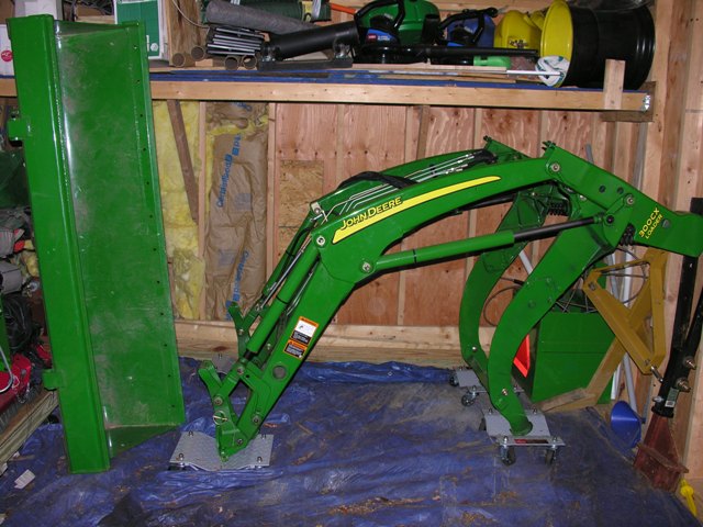

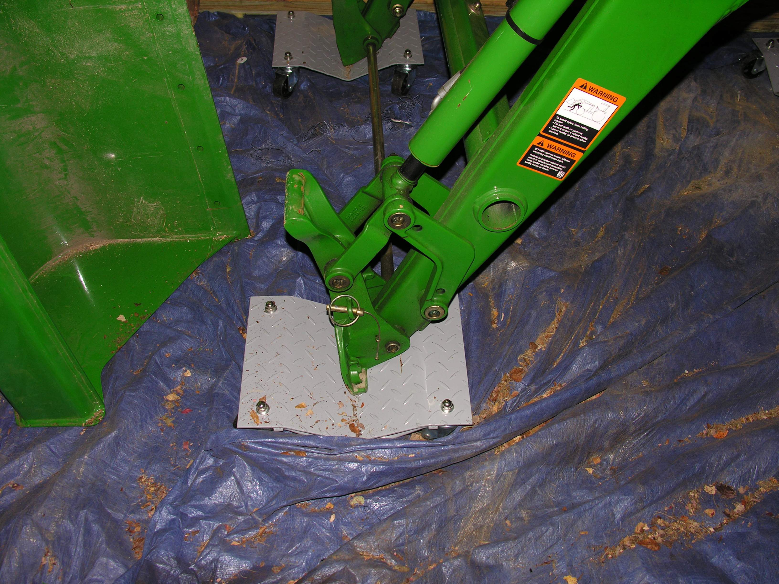

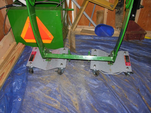

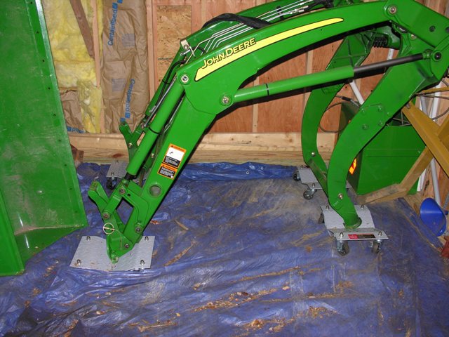

Ok, here is my solution. I used a small floor jack to slightly raise the loader off the ground on each end so I could get the vehicle dollies underneath the unit. The Dollies are form Harbor Freight. I am thinking of connecting them together somehow in the future to increase stability. Here are some pics.

Nuru,
Looks easy and should work well, too bad I didn't think of it myself :)
   / Loader Storagge and Movement - off tractor!
#13
Yeah, it was actually pretty easy. Much easier than I thought it would be. If I had a larger shed, I would have kept the bucket on instead of removing it.
