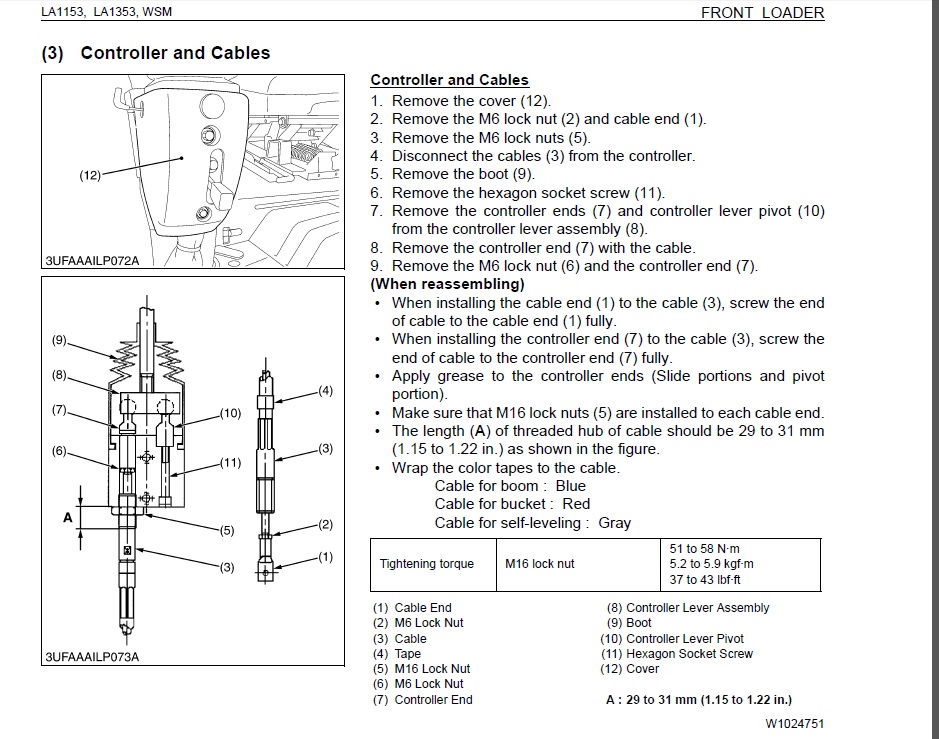

I have a M7040 with a LA 1153 loader. I noticed that the joystick felt rough in the raise position and the raise function is a little slow. I called the dealer and they suspected a bad cable. I dug out the ole spray lube and did the exposed ends of the cables and took the boot of the joystick and sprayed the three plungers there. ( Only two of the three plungers move during loader control and I'm not sure what the third plunger is for) Anyway after some use the roughness went away but I still find the raise function to be slow. I always found the hydraulics on this tractor slow as I have a 9' powerangle snowblade mounted on the front so that's a lot of weight on a loader of this size but it now feels a bit slower than it was before. Is it possible that I could have a cable that isn't travelling far enough to allow full hydraulic flow? Is there any adjustments that can be done? Any thoughts would be appreciated.
/ Loader Valve Cable #2
You can shorten (or Lengthen) the cable at the control valve. loosen the jam nuts on the cable outer sheath... easy to figure out once you look at it.
Problem is that you may have a few busted strands in the inner cable making it too long, short term fix, (if that is the problem) shorten that cable at the adjustment... Problem is IF the cable has some broken strands, it's going to bust eventually.
You can have new custom cables built at an industrial supply shop, much better built, stronger and at about 1/3 the cost of dealer supplied...I replaced both of mine several years ago, big difference in operation. KennyV

This page is from the M7040 loader WSM
It is not much but perhaps a cable adjustment or at least check is warranted.
Dave Mm7040
