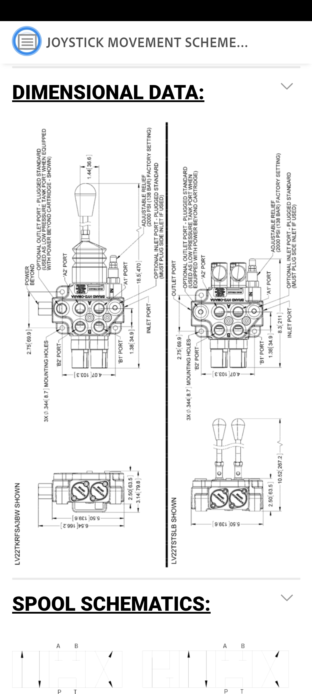

Oh man, I've used the rock shaft a bunch of times with the backhoe on. What is the issue with that?
The schematic shows the out port as optional? Why do I need an outlet to the tank? Not doubting just looking for an explanation. Should I T into where the backhoe returns?

SBC, I have no idea how/where your backhoe valve's supply and return lines connect to the tractor so I have no comment for you at this point. It's entirely possible your system is nothing like the one pictured here.
As for the other subject discussed earlier, it isn't about how the valve is supplied, only about how fluid returns to the tractor and under what pressure.

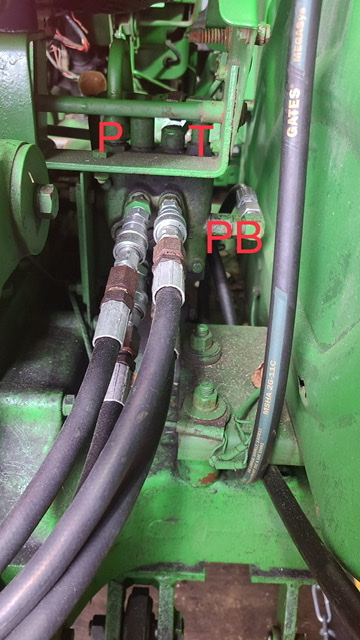

I marked your picture of the old loader valve with what I think the connections are. You would want to tee into the port I marked T for tank with a hose from your new valve marked T.
P=Power In
T=Tank
PB=Power Beyond
Hope that clears it up. If not I will try to help.
