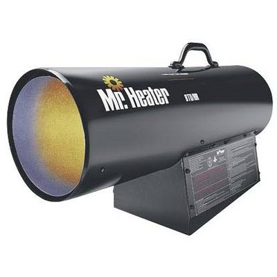

If your 3PH works, then the diverter is fine. The diverter just sends full pressure/flow to the loader's joystick valve(s). That fluid exits the loader valve on the PB line and then goes to the 3PH and/or remote hydraulic valves. If the 3PH is working, then fluid must be flowing into and out of the loader valves.
As JJ mentioned, water is your most likely culprit. I'd look at all the low bends in hoses and even see if I could carefully heat the cylinders. A jet heater would be ideal, but also expensive for this single job. Somewhere water is trapped and frozen, blocking flow to the loader. All low hanging loops or the hyd cylinders are suspect.
