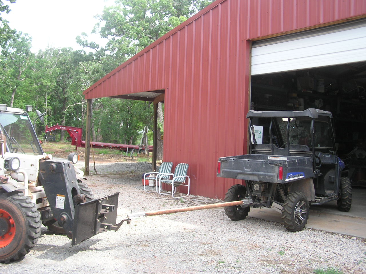

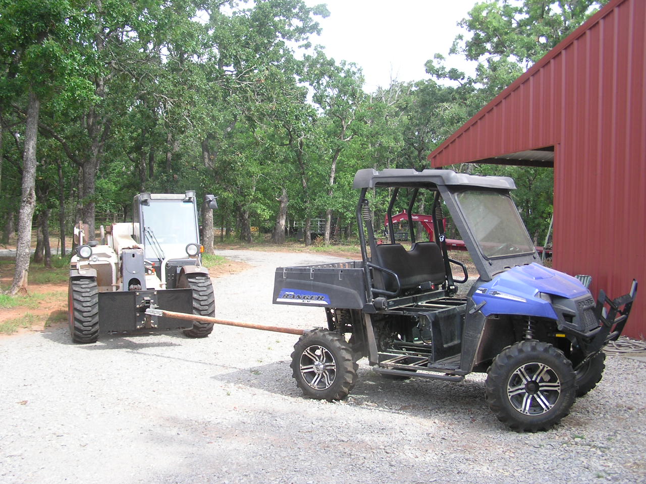

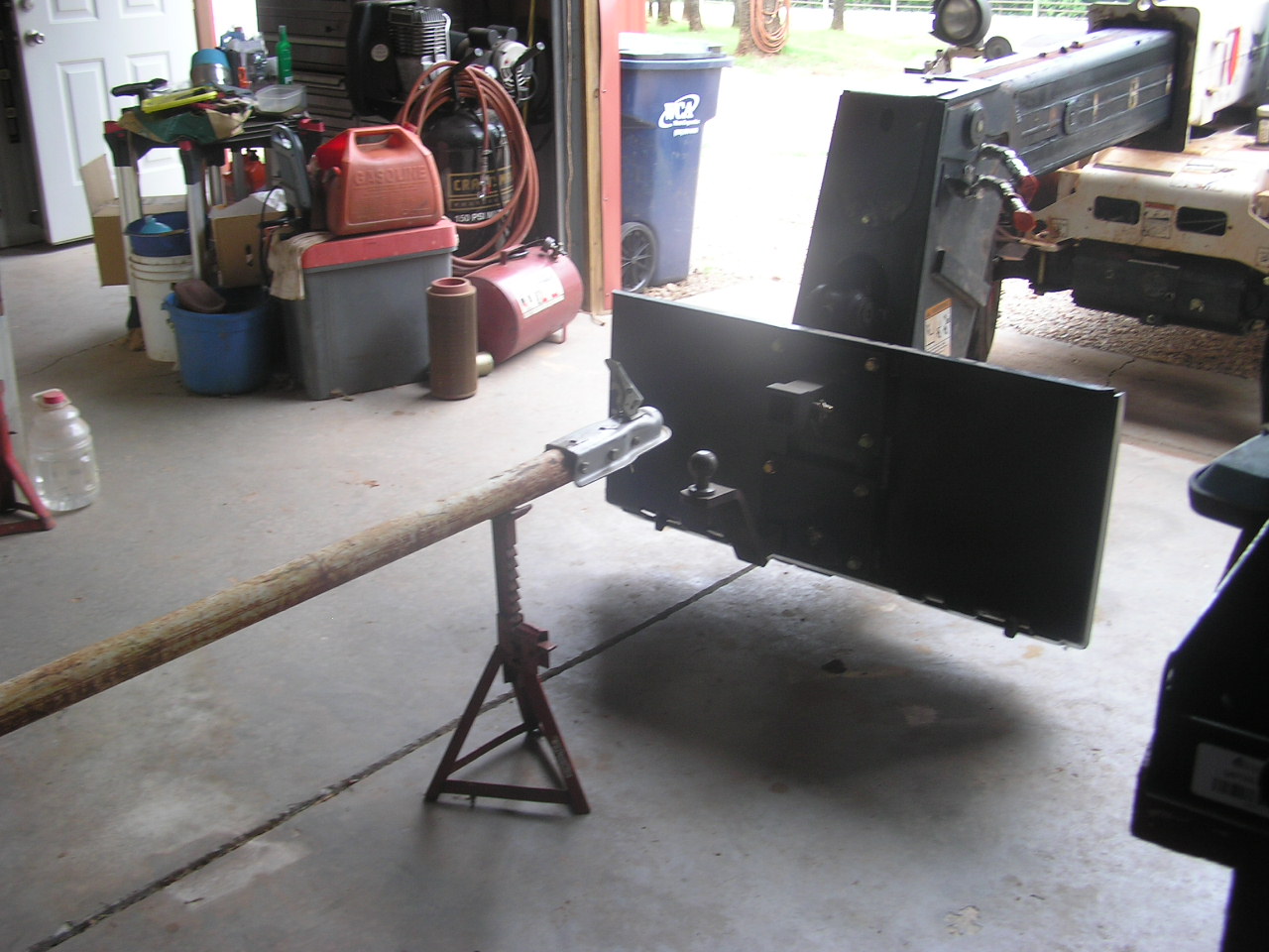

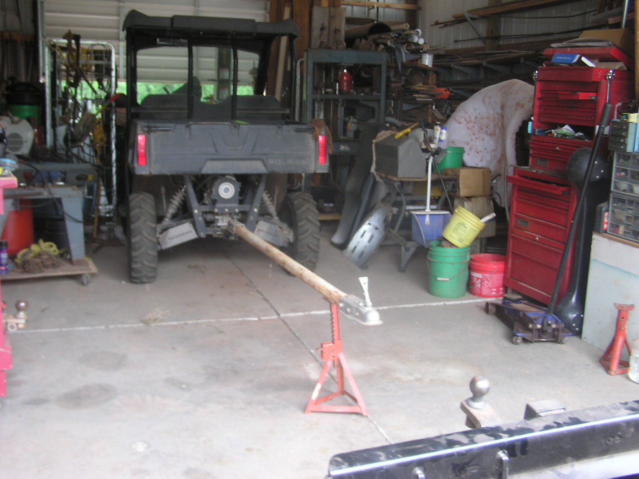

This is my push/pull pole in the push mode:
