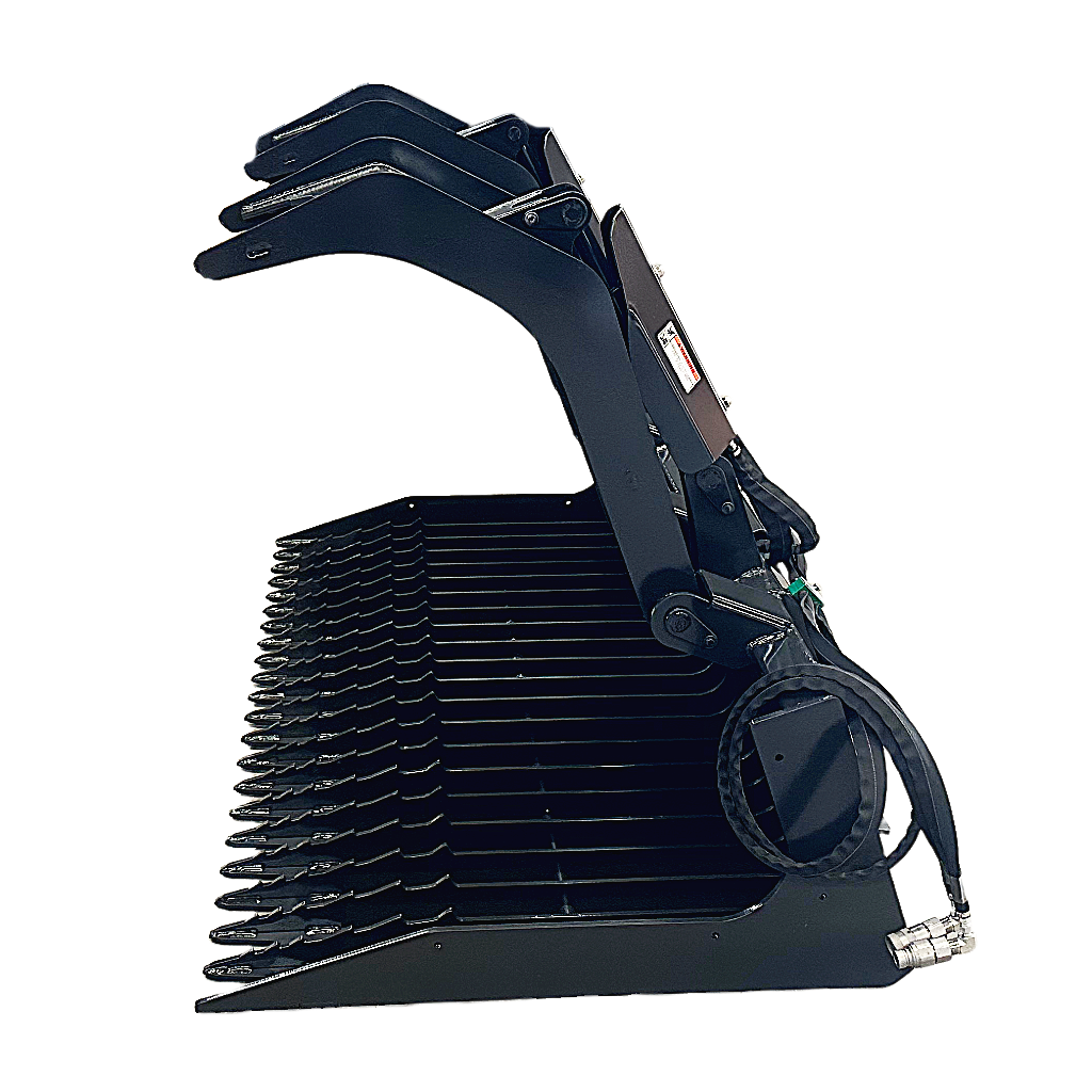

My biggest problem right now is finding anyone that has one in stock. I'm expecting a call back on a MTL demolition/rock grapple tomorrow. It's a little narrower than I'd prefer (80 vs 84") but ordering anything is going to be a 6 week wait (which IME usually turns into a 12 week wait).
I'm not going to use this grapple to dig into the ground. I just want to be able to pickup stuff that's on the ground (firewood/uprooting sage brush/picking up windfall), in the same footprint of the tractor (7ft).
The MTL grapple I'm looking at is about 1000lbs and made from 1/2" thick 50,000psi steel (I believe, but will have to verify). Is that still too light duty for my Kubota M5?

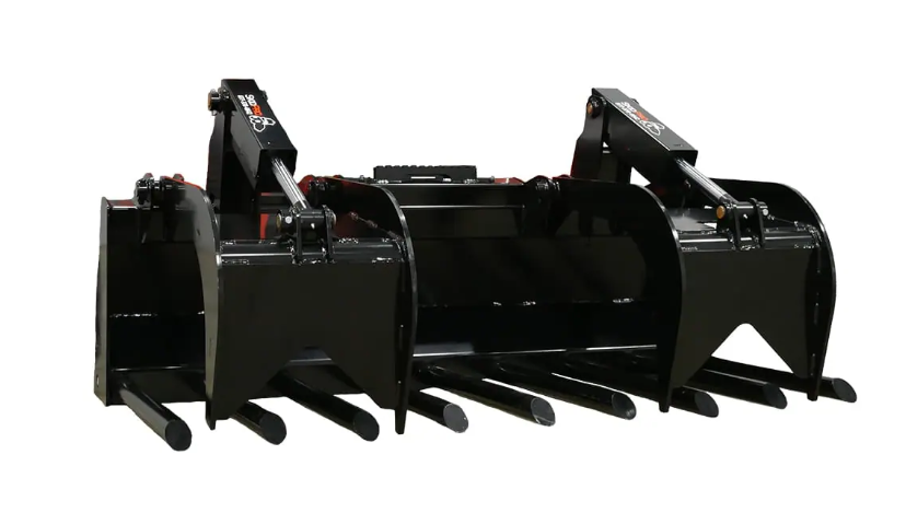

I prefer a solid plate like in #7 if branches and such are on the "to do" list. More difficult for them to contact the tractor if they have to go through plate steel first.
Some models in my earlier post are solid backed. Also the Faver grapples are used on heavy duty higher end skid steers as well.
We also have a STOUT brand in the family on the Bobcat T 250 that has stood up very well over the last decade plus.
couple of their models, They also say they have same day shipping on many models.

Thanks for the suggestion. I took a look, but the tine spacing and upturned leading edge of the grapple make it less suited to sliding under & picking up stuff on the ground (firewood demo material etc) but better for getting under roots etc.

So I just placed an order for this grapple. They just got one in 80" width (I'd prefer an 84" but no ETA on those). The sales guy said he'll get it on a truck today, so I should have it sometime next week.
The guy told me they use them on 100+ hp skid steers and they hold up fine.
